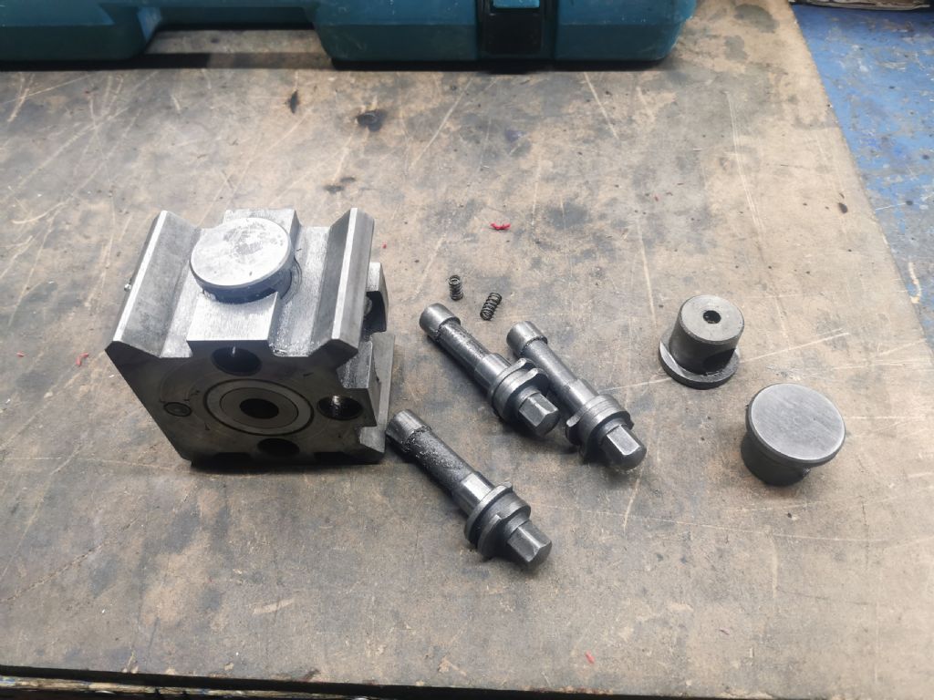

                                        Bob Astill
                                          @bobastill76884
                                          Hmm maybe mine is not Dixon as it is different? but it cam apart the same its now in the bath for a good clean is it just a light oiling on rebuilding?

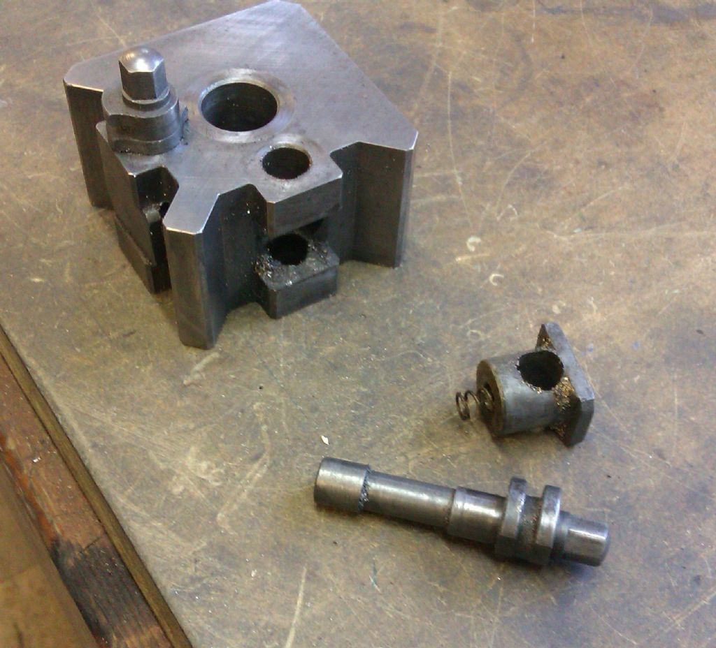

                                          #560647
                                          Clive Foster
                                            @clivefoster55965
                                            Nice picture from Jason showing how itty-bitty teensy weeny swarf builds up inside the post and around the locking device. It doesn't take a lot to upset smooth, easy operation of the post. Too much inside and it won't hold tight.
                                            My practice is to pull and clean yearly and before any "knock, knock, knock" type rough turning jobs. As Dicksons are so easy to pull apart there is no sense in letting rubbish build up. I often wonder what the innards of Multifix, wedge and other types which aren't so easy to unbutton get like after extended service.
                                            Best practice is to wipe down the Vees and behind the locking tongue before installing a holder and clean off the holder before putting it back in the rack. Something I've been known to be lax about when doing the multiple tool, multiple part, shuffle. Which always bites me in the end! After 40 + years you'd think I'd get the message. Must be a slow learner.
                                            The post in Jasons picture is very clean. I've never pulled one out for regular service with less than 3 or 4 times as much stuff in it. The one that came with my S&B 1024 had so much brass swarf inside that it was a serious struggle to get enough movement on the locks to strip it.
                                            Clive
