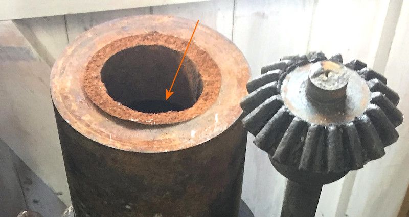

      I am restoring a Denbeigh K1 pillar drill. Does anyone know anything about this machine? It looks to me to be post war, but pretty old, and enormously heavy. And any help on:
      1) The main column is 4 1/2 inches diameter, with a 3" spigot that the drill head fits onto. This has snapped clean through! So I need some 5" diameter solid round to make a new spigot. Any idea where I can get 4 " of 5" diameter round?

                  Simon, looking at the images in your album the pillar shows, if you look carefully, a ridge down from the broken spigot.
                  Is it possible that the spigot is a separate bit that has been fixed into the top of the pillar? If so it might be removable, look for rivets or possibly a push fit . It would seem unlikely that the pillar is one casting with that sort of sharp internal detail.
                  Just a thought, if it is a separate bit then you just need a few inches of 3" tube.

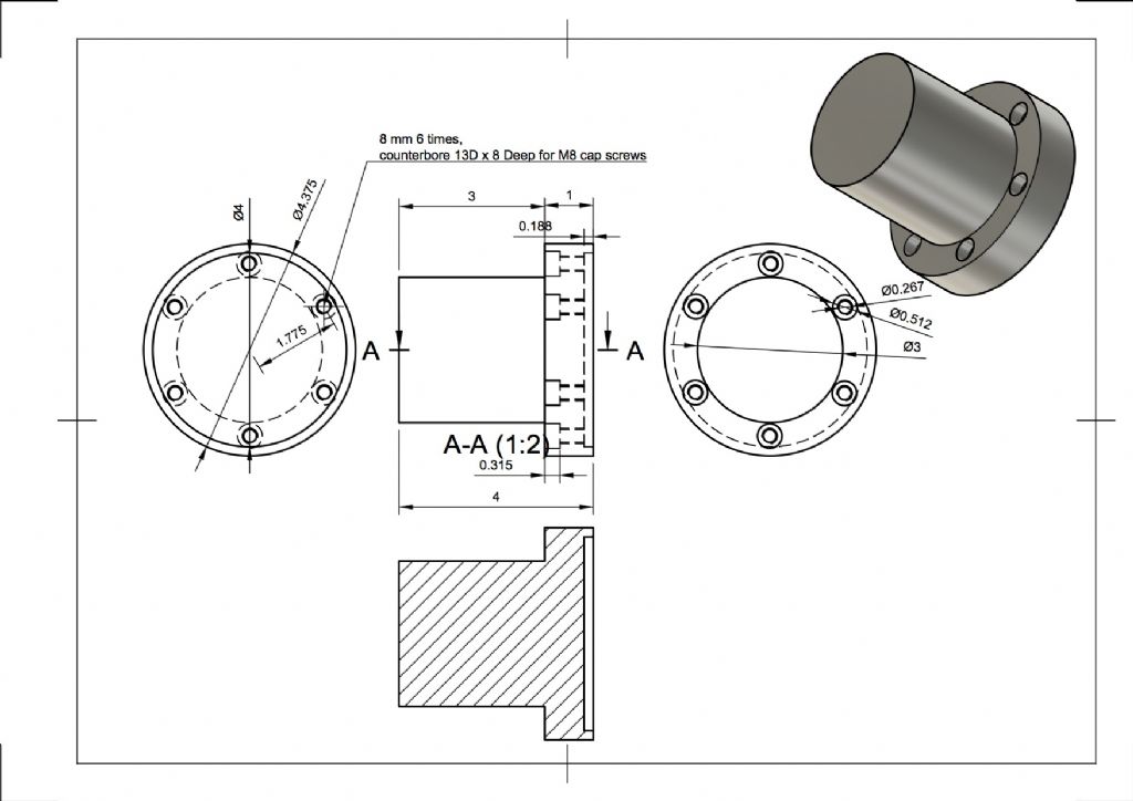

                    No it's definitely cast in one piece, but machined all over, hence the sharp detail – which may have led to it snapping there. I have extracted the spigot, and it sits quite snug on top of the break, so I am going to try to bolt it up, with a 20mm thick plate lowered through the hole and rotated to bear against the internal shoulder, and a top-hat piece in the spigot, 4 10mm 8.8 studs to hold it in place. May work, may not.
                    Brian – boring it out, would be great but it is huge, 42 inches long, with an even bigger round foot piece, about 10" diameter. I could probably bolt to the mill table and turn the head 90 degrees to be horizontal, and bore out with a boring tool – in fact like a horizontal boring machine. I may try that if the bolts don't work.

                          Simon, as an alternative rather than trying to align the old spigot how about a new one. Grind off the broken area to leave a flat top to the column. A dremel, angle grinder if careful or even a file should make short work of it. Then fit a plug inside and use studding to secure a new spigot for the head to fit on. Might be more secure than using the old bit of column. Something like:
                          Excuse the strange drawing (Libre Office Draw) but it was the easiest way of getting my thoughts into an image! Studs on a PCD to suit the available space probably secure the bottom with Loctite and nuts and shakeproof washers at the top.

                            My idea was a top-hat replacement, bolted to tapped holes. I think combining these ideas will work best, if just bolting the broken spigot does not work. Bolting through to a thick plate puts the tension in the right place.
                            The centre hole left by the break is very rough from the sand core and nowhere near round, so not useable to locate the spigot, hence the outside lip in my drawing.

                                The top-hat is a nice engineered approach but needs the column machining. Using three loose parts only needs the old spigot grinding off and can be fitted and lined up easily. The three studs will have plenty of room to pass through the cast in centre hole. All the parts are easy to make with the minimum of turning.
