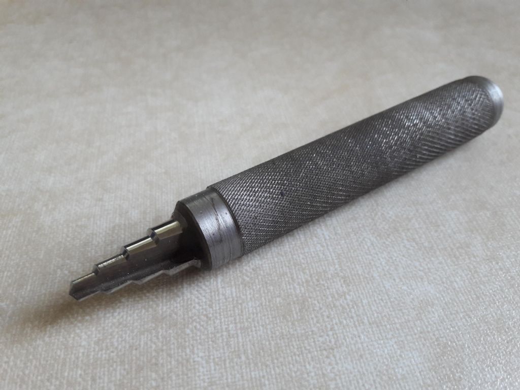

                          ega
                            @ega
                            I had occasion to cut the tip off a step drill and afterwards it occurred to me that, mounted in a suitable handle, it would make an effective countersink/deburring tool:
                            It works best, of course, when the preceding step is a good fit in the hole being deburred.
                            On the tricky question of deburring holes in tubes, I suppose a CNC machine could do the job; I just make do with a small half round scraper.

                                            ega
                                              @ega
                                              The book advice for threaded holes is to countersink before threading; I admit I often forget and have to put up with the result.

                                                #379214
                                                ega
                                                  @ega
                                                  Posted by Nick Hulme on 04/11/2018 18:59:34:
                                                  Posted by ega on 18/10/2018 14:06:29:
                                                  Thanks!
                                                  I'm stealing that idea!
                                                  Feel free!
                                                  Mine uses a metric drill that rises by twos but a more versatile tool would be in steps of one millimetre. Again, if you didn't want to tie up the step drill permanently it could be held in a chuck handle.
