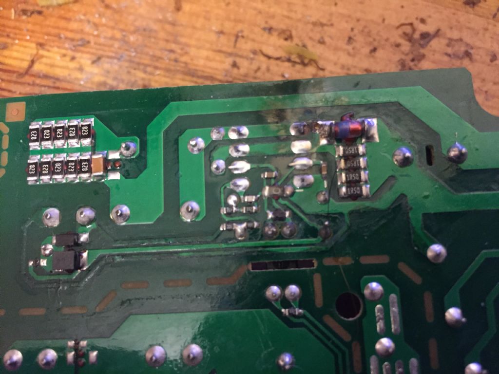

      I've had a dead SINO DRO unit on my shelf for years. I'm trying to upgrade my mill to glass scales, so thought I'd have another look at the display unit as I'd been told the most common failure with these devices is the PSU. So maybe an easy fix.
      And so it turned out – the display works fine with an external 5V supply.
      My question (to which I think I might know the answer, but have to ask) is whether it is worth trying to repair the PSU. This is what it looks like:
      The fuse under the connector block is open circuit and something's clearly gone wrong with the component marked Z1 to the left of the capacitor at the bottom of the pic. From the underside:
      I can get a slot-in replacement unit for 20 quid, so that's what I'll probably do – but I'd be interested in any info from the electronics bods on this forum about the possibility of repair and the probable reason for failure.

          Most of those types of converters are designed to a price and the integrity of the design around the switching device, any related snubber network and the excess voltage ratings of devices is cut to the bare minimum to save the pennies. So, even relatively benign conditions, a spike or surge on the mains line, perhaps from the powering one/off of the attached machines drive motor, etc can cause higher than normal voltage spikes on the switch devices and pop..Another killer is heat – In your supply the main switch device is on a reasonable heat sink, but in many instances the rest of the parts tend to be underrated , especially electrolytic capacitors – they tend to 'dry' out internally – rather, the electrolyte may dissipate from the active surfaces in the cap, and the cap becomes ineffective, loses capacity, becomes higher impedance.
          I believe in your supply, the controller is the 8 pin DIP package device – the other nearby seems to be the feedback optocoupler.
          I suspect the 8 pin device, the controller, is dead as well – the burnt pcb track on the underside connects to that device and for the track to burn like that implies that device went short circuit. That would most likely have been caused by the main switch – the device on the heatsink – having gone short circuit to start with – if it were only that switch, it might have been worth trying a repair, but it will now be multiple devices dead, and maybe electrolytics that need replacing
          In a repair of such converters you don't really get much chance to measure around with a 'scope or meter when debugging and replacing parts – any non-working part in the mains input side of the converter chain invariably results in, as a minimum , letting the magic smoke out on switch-on, or a big bang, with money down the drain each time..

                    From a close look at the pictures, I would say not. The solder covering the vacant hole in the pcb looks to be undisturbed.

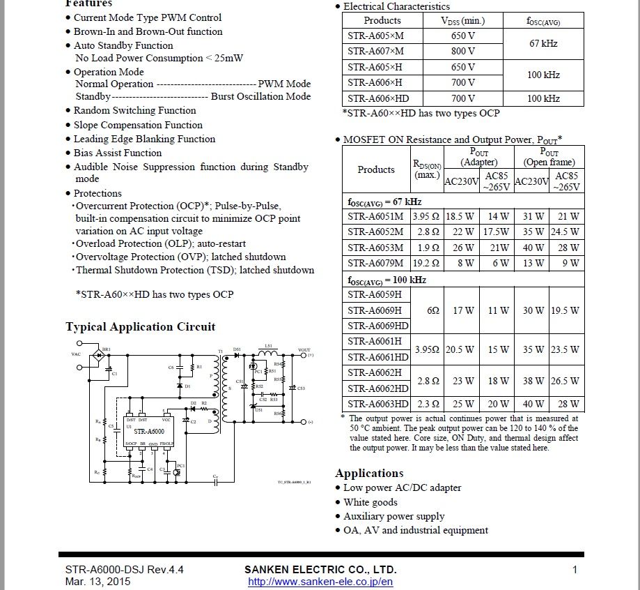

                      I am sure that device is a one of the SANKEN STR-A6000 series – available from Digi-Key for example – $2.00
                      See datasheet –
                      But – $2.00, another $3-4.00 for the power FET, maybe $3 – 4.00 for electrolytics, maybe the schottky rectifier post-switcher is also blown…$ could be $10.00 or more to repair, and maybe only works second time round..
                      The terminal block and input XR rated caps are useful – the rest is scrap!

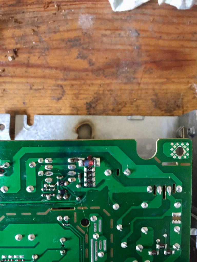

                                    Well, we are not going to repair this thing with all our guessing, but the fix will for sure NOT be just a zener replacement!
                                    The PCB track is blown away, it is no more, not even nailed to the PCB anymore…and that track is the feed between the 400VDC ( from the large cap) and into the transformer, then on to the FET. The many 1206 SMD resistors top left 2nd pic are all current sense from the FET switch. The ONLY reason for the blown track is that the FET switch is a short now…which then often shorts drain to gate, which places 400VDC onto the control chip gate driver which pops it which….
                                    Joe

                                          For a small single output SMPS like this any kind of high energy failure, e.g blown tracks or exploded components, makes them poor candidates for repair. Just replace it. with the same or similar. The induced currents and voltages from a high energy failure can damage multiple components. You can change the obvious ones on have it go bang first time you switch it on. Less obviously compoonents may have been stressed making future failure more likely.
                                          Faultfinding on this type of supply needs caution and a good understanding of high voltage hazards.

                                            Thanks for replies. It sounds like the unit is beyond economic repair, as I suspected. Out of interest though, here is the 7-pin chip in more detail:
                                            and the site of explosion:
                                            The unit is rated 5V 7A – the plate on the DRO gives a power rating of 25VA.

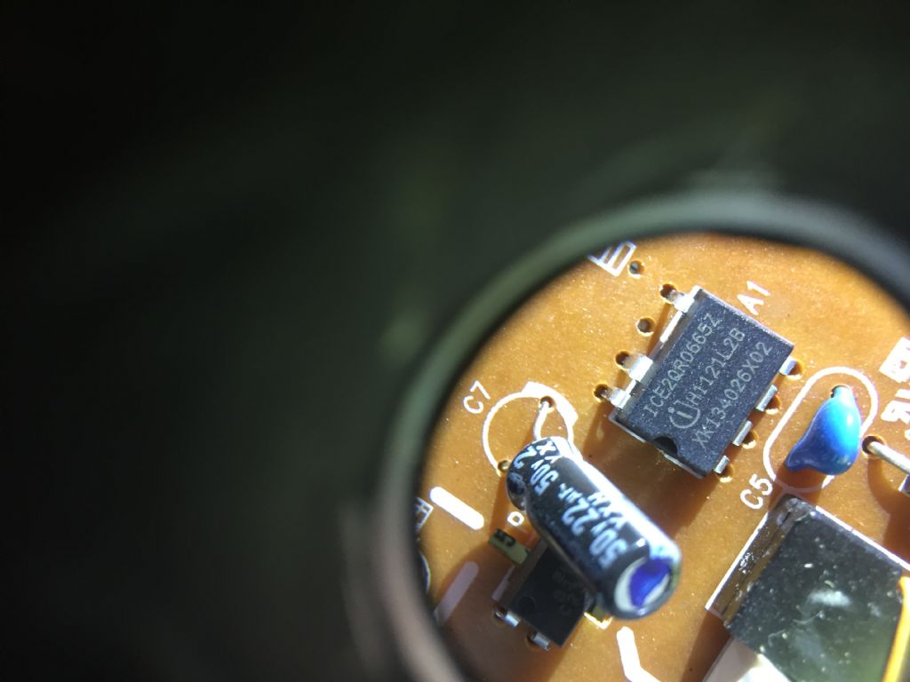

                                                Robin, can you see what the part number is of the device fitted to the metal bracket/heatsink?

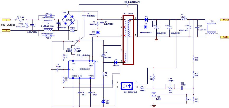

                                                The diode next to the arc point might have blown – I believe that is a zener regulating the the supply line to the VCC input the the 8pin chip. The current sense pin and the drain pin on the device are very close, made worse by the pcb track layout, and those two pins have full rectified line voltage between them.
                                                So, if the zener diode is blown ( would probably be a short) , replace, and replace the 8pin device – available maybe from Digikey , Mouser, maybe even RS components, CLEAN the pcb well and give it a try!
                                                Below is a reference circuit for the supply – this one is a 20volt output, but I am pretty sure the the circuit is close enough.
                                                Interested to know what that device on the heatsink is..

                                                    Joe, it's not easy to see the markings on the component but as far as I can make out there are two lines – top LT 1117 and bottom MBRF2045CT.
                                                    Thanks for posting the schematic. If I have a go at repair, what voltage Zener would I want? Presumably the 22V in the schematic is to do with it being a 20V supply? I am

                                                      The enner voltage has nothing to do with the output voltage. It s tere to protect the IC from voltage spikes (If R3 was more than 0 ohms it could be a regulatrd supply for the IC). Note that the circuit cannot be totally correct for the supply you have as it is using multiple surface mount components that are not showm on the circuit.
                                                      The failure appears to be on the un-isolated part of the circuit. While I would normally encourage any one to attempt a repair, even if not really economic, for the learning experience, an mains SMPS is noot a safe place to start learing about electronics. No disrespect, but from the questions you are asking, you almost certainly do not have the knowledge or equipment to safely repair this power supply.
                                                      Robert G8RPI.
