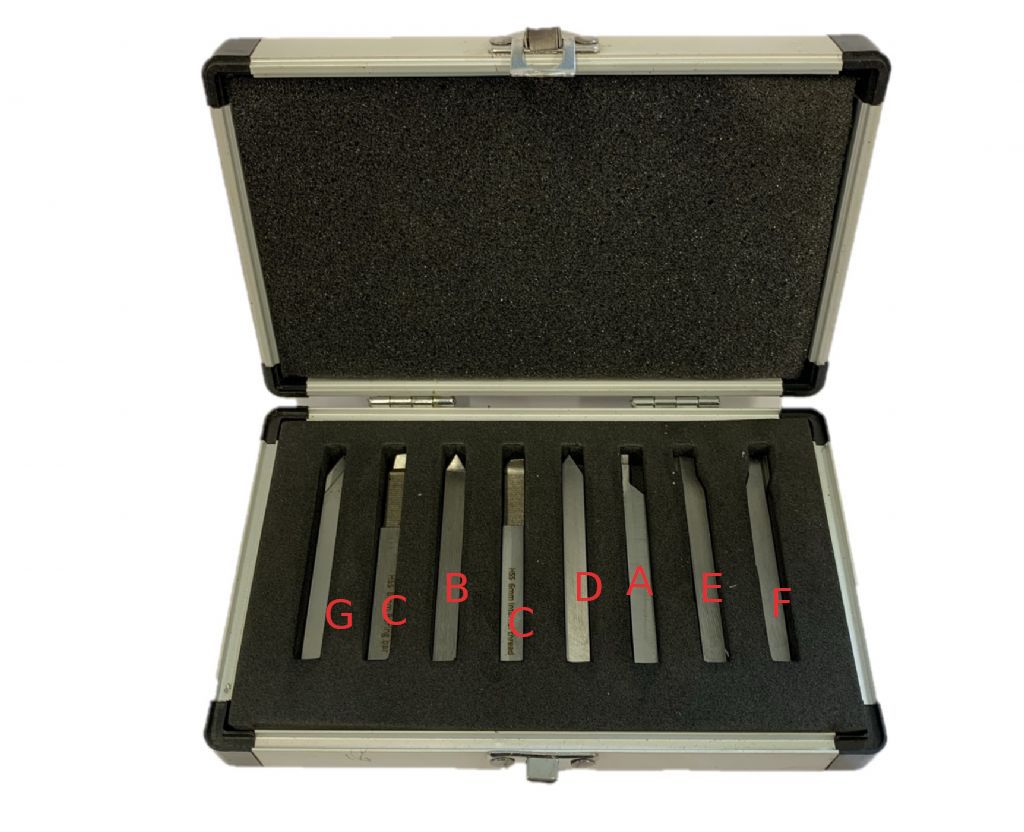

      Hi,
      I bought a set of tools from rdg.
      but being a total newbie can someone explain which way the different tools cut.
      which way do the fix in the toolpost too cut.
      also the cutters are way below the workpiece to cut, what do you do.
      thanks
      chris m….

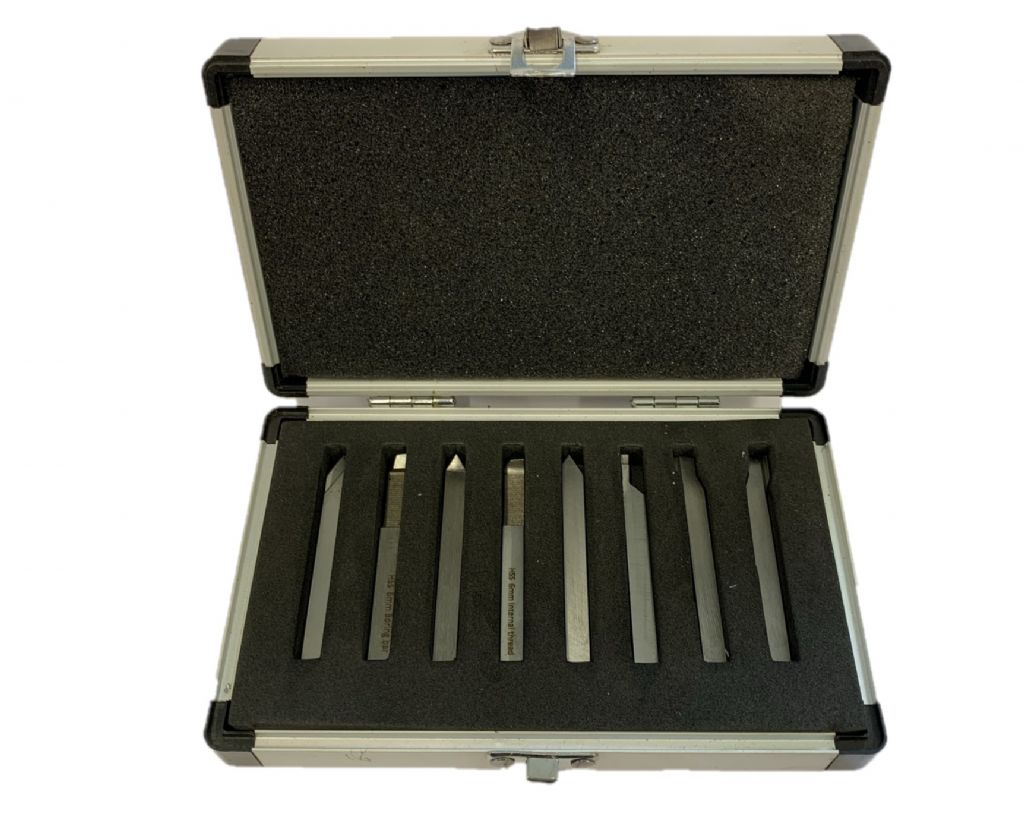

                Which set? Was it this one:
                Or maybe:
                The knives come in various sizes, such as 6mm, 8mm, 10mm and 12mm square. For a Myford, I'd go for 8 or 10mm, because I think they were designed for 3/8", roughly 10mm, and 12mm might not fit. A Myford owner will know.
                Both images above show the tools the right way up, ie top view looking down as you'd see them in the tool post.

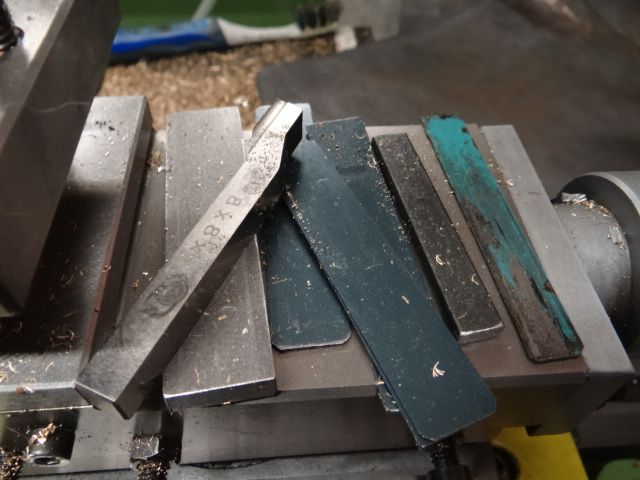

                They are shimmed to centre height – with whatever strips of metal are handy. I'll put a picture up in a moment showing shims and how to check the height is correct.

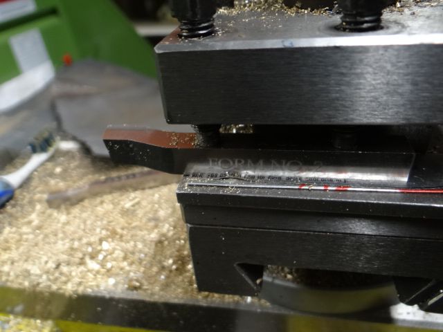

                      A left-hand knife (ie cuts away from the chuck towards the tailstock), shimmed to centre height with a strip of mild steel a few millimetres thick, plus fine adjustment with thin aluminium strips cut from a Coca Cola can. Other soft drinks work just as well!
                      Next a pile of various strips used for shimming, made from soft drink cans, steel strap ribbon used in packaging, length of old hacksaw blade with the teeth ground off and a bit of DIY store metal. There's a right hand knife on the heap – a mirror image of the left-hand in the tool-post, and used to cut towards the chuck. (The usual way.)

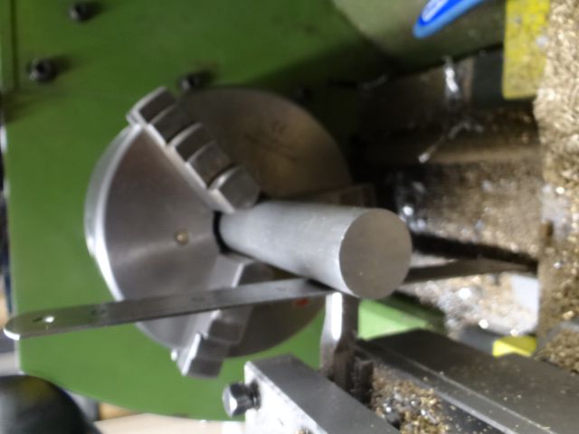

                      Next picture shows the knife is at the correct height. Done by gently nipping the middle of a 6" steel rule or similar against a rod in the chuck. If the knife is too high the top of the rule tilts away from the operator. Too low and the top of the rule tilts toward the operator. Picture shows the rule is vertical, ie the knife is correctly on centre.
                      Another way is to face a rod accurately to centre height and use it as a gauge. Possible to get close by eye, and even better by feeling for a step between the rod and knife edge with a fingernail:

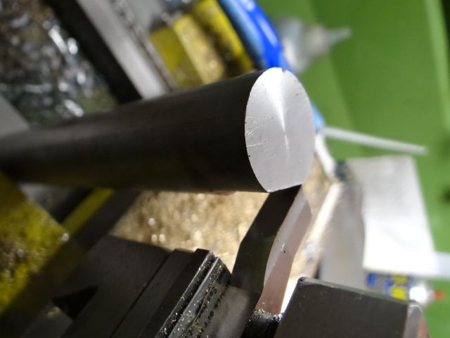

                      Facing tools can be checked by seeing if they leave a pip in the centre, too low, or break one off, too high.
                      Finally, picture below show what some of the different shapes are for.

                        Little difficult to be certain from the photo:
                        A – Parting Tool (for cutting off rod or making grooves.)
                        B – Finishing Tool (for removing marks, if any, left by the LH & RH cutters
                        C – Boring Bar and Internal Thread Tool (For opening up holes and threading them.)
                        D – External Threading Tool
                        E – Right Hand Tool (For cutting towards the chuck – this one is used the most!)
                        F – Left Hand Tool (Same as RH tool except cuts towards the tailstock.)
                        G – Corner Tool
                        This document may help.
