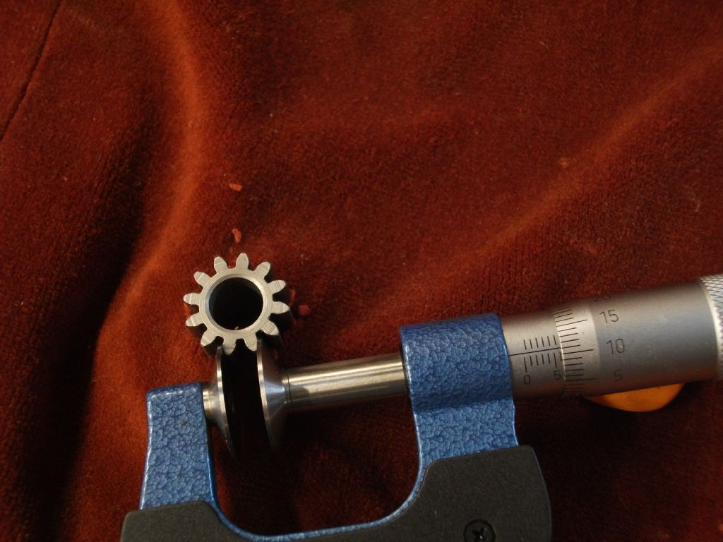

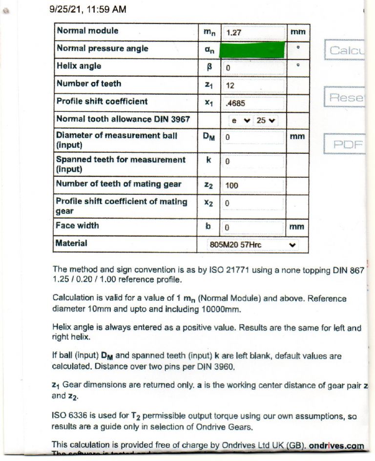

        Posted by brian jones 11 24/09/2021 14:41:58
        ll you needed to know about CP and the Base Bitch
        https://www.geartechnology.com/articles/0992/Base_Pitch_Tables/
        this past post went into the problems of measuring a gear (as opposed to calcs + suck it and see)
        You cant just use calipers / disc mic and measure PCD just like that
        https://www.model-engineer.co.uk/forums/postings.asp?th=166048
        If you have two gears meshed together you can deduce the pcd from distance between centres
        then there's the eyeball method
        The last 2 lines is where Brian's methods of measuring all fall down.
        Whilst it is true you can deduce the PCD from the distance between
        centres it is of little use if you are making a pair of gears to fit
        between pre determined and existing fixed centres ,you would need to be able
        to measure the gears with some accuracy before they are removed
        from the machine on which they are cut.
        Still we have seen from his methods of working from
        posting on 13 / 9 / 2021 12:30:19
        Difficult to make two gears that will mesh together from fixed centres.
        Drill your centers afterwards.
        With regard to eyeballing the pressure angle , here is
        a small gear the OD is 18.970 mm or .7468", the span across
        2 teeth is 6.112 mm as can be best determined from the
        micrometer reading.
        Now is it possible to eyeball the pressure angle as suggested
        by BJ 11 or will a guess do .
        There are only 2 options 14.5 deg pa or 20 deg pa.
        Here are the required inputs for the Ondrives gear tooth
        calculator only the input for pa is missing , give it a try
        and see which one of the two that it is and how close the
        answer is to the micrometer reading. The results for both
        are very close but one is a clear leader.
        Seeing Andrew's posting 23/09/2021 21:25:25
        When I started making gears I spent some time faffing about with gear verniers
        I didn't find them easy to use and the results were indifferent. Now I just calculate
        the theoretical values and machine to those.
        I can understand this point of view with the gear tooth calipers ,they always
        seemed to me to be a hit and miss method , the span measurement seems to offer
        a slightly more accurate solution ,the Ondrives also does give the measurement
        across 2 pins which is likely to be the most accurate method obviously the requirement
        to grind 2 suitable pins is just more to do.
        Hobbing can be different to using form cutters in as much you can keep cutting in
        and still retain the tooth form which you can't do with form cutters.Only one of the hob
        cutters that i have has the infeed marked on ,using the general recommendation for
        cut depth does not work either ,eg in Gears and gear cutting the tooth depth cut
        for 20 dp is .108 inch both my 20 dp hobs need to infeed by .1115 inch
        to cut to standard form.All of the hobs that Arc Euro used to sell were Topping
        cut hobs and still did not conform to standard cut depths,all of this you find out
        in time until it is no longer a problem ,being able to measure is just a help.

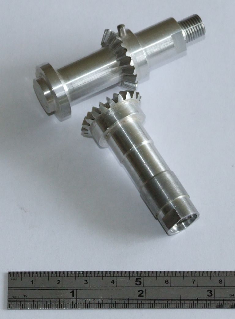

                #564274
                Anonymous
                  Posted by brian jones 11 on 25/09/2021 15:48:26:
                  …..the Crown and bevel pinion, without the benefit of CNC how does one make those pieces……
                  I'm beginning to suspect that the OP is actually the greatest gear expert who ever lived, and is just messing with us for his own amusement. But I'll do my best to answer the question for other forum members who might be interested.
                  A crown gear (aka a contrate gear) is simply a bevel gear where the pitch cone angle is 90 degrees. So they can be made with any of the methods used for bevel gears. In practice the face width of crown gear is small so the change in shape of the tooth form is very small and they can be satisfactorily cut, one tooth at a time, with an involute cutter.
                  There are two approximate methods for cutting bevel gears on a milling machine with involute cutters. One, the parallel depth method, uses standard involute cutters. The other produces tapered teeth in two dimensions rather than one, but needs special (narrow) involute cutters. Both methods require three passes around the gear. The second method creates gear teeth which lack curvature at the small end which needs correcting. I've never made bevel gears using the parallel depth method, but these test gears were cut using the second method 45+ years ago as part of my training:
                  Old Bevel Gears
                  No CNC used, all manual machines.
                  The first bevel gear planers were introduced in the 19th century by Gleason in the US. They used two reciprocating rack like cutters to form each tooth. Early machines followed templates but later machines eliminated the need for the template. If the OP thinks cutting one tooth at a time is slow he should watch a video of a bevel gear planer! I've not used one, but have seen one in action. Apparently they're difficult to set up and are temperamental.
                  Straight tooth bevel gears fell out of fashion to some extent, being replaced by spiral and hypoid bevel gears, which can be (approximately) cut using vertical rack like inserts in a circular holder. It's a much faster operation than planing. More recently Gleason have introduced the Coniflex straight tooth bevel gear. These can be cut with one, or two, circular discs with radial inserted teeth that form the teeth. They are much faster than the bevel gear planers, and presumably less temperamental as they are, of course, CNC.
                  Andrew

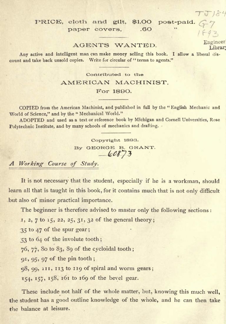

                  #564290
                    For info.
                    The George B. Grant ‘Treatise’ is available in PDF, here: **LINK**
                    https://ia800909.us.archive.org/4/items/treatiseongearwh00granrich/treatiseongearwh00granrich.pdf
                    Incidentally : Brian would be advised to read section 35
                    Edited By Michael Gilligan on 25/09/2021 22:35:40
                    #564315
                    John Haine
                      @johnhaine32865
                      Good find Michael. I had a quick re-read of Ivan Law's little book on Gears and Gearcutting last night, and it's also a recommended read.
                      #564319
                        Posted by John Haine on 26/09/2021 09:02:26:
                        Good find Michael.
                        It’s an absolute gem … and it appears it always was:
                        It was a bargain then ^^^ and now it’s free !

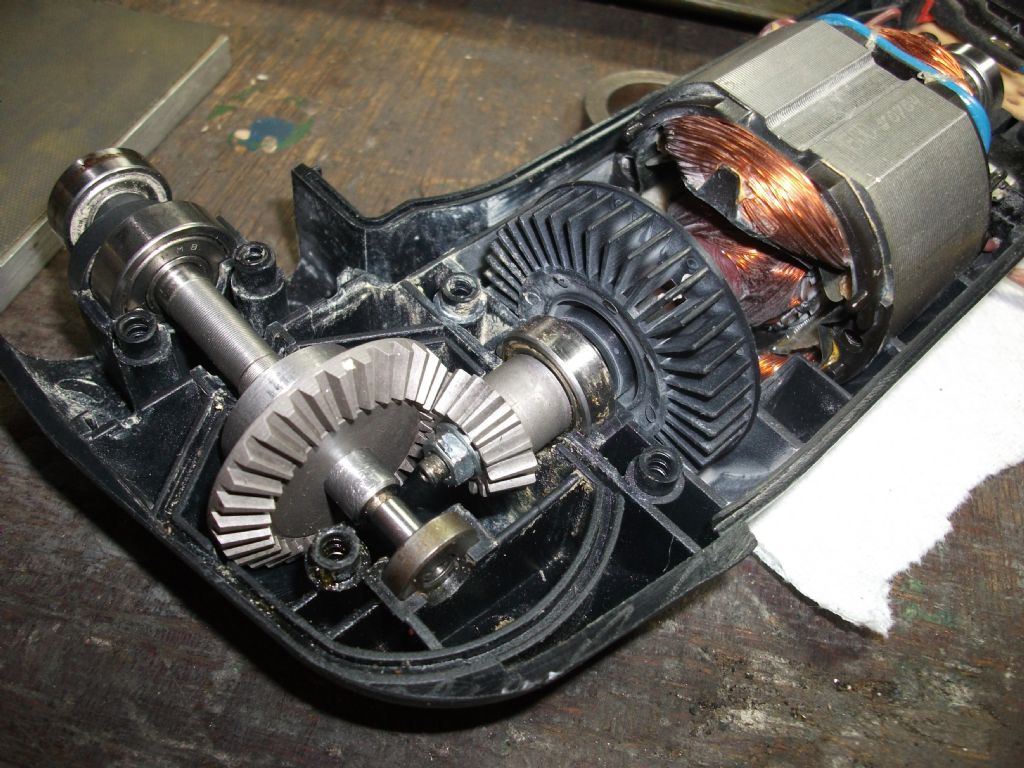

                                Posted by brian jones 11 25/09/2021 15:48:26
                                Looking at the Crown and bevel pinion, without the
                                It would be worth Brian getting a copy of
                                Gears and gear cutting and reading through it.
                                Making parallel depth bevel gears is not that difficult
                                if you follow the the instructions in the book.
                                I have made several sets of parallel depth gears over the
                                years ,if you set up and mark the centre they can be done
                                in just two passes ( which would obviously please one
                                particular poster on here ,or maybe not).
                                I had always been a bit skeptical as the the long term use
                                and how much power they would transmit until the last set
                                that i made.
                                Material selection is obviously of importance ,so a rummage
                                around in the scrap box and a couple of likely rusty candidates
                                emerged.
                                The job was a pair of gears to replace the stripped bevel gears
                                in a detail sander (Wickes).
                                I was unable to get the exact tooth count of the original gears
                                but the gears that were made are close enough.
                                The cut gears were lapped together for a while with some
                                Timesaver green label fine abrasive, cleaned and sandblasted
                                then soaked in some Kasenit in a sealed tin for an hour .
                                Here is the finished job ,the pinion runs at about 18 to 19000
                                rpm and surprisingly reasonably quiet.

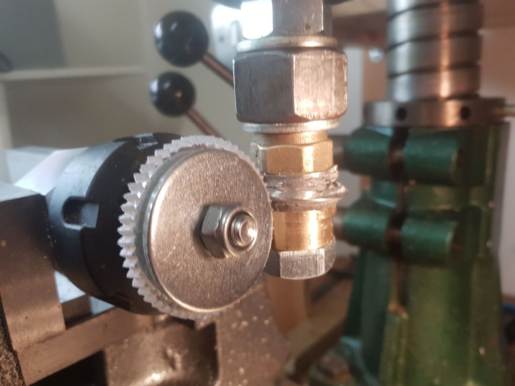

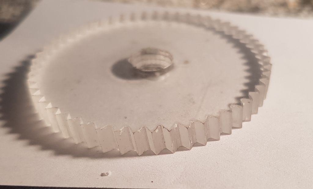

                                                    brian jones 11
                                                      @brianjones11
                                                      Well dont break open the champagn yet
                                                      This is my first run with the secret weapon
                                                      I had to use a bit of plumbing to stop the leaks from my secret workshop
                                                      cost of bits for tool <£10
                                                      time to make gear 5 mins
                                                      For the armchairs here are some data
                                                      OD 44.4mm
                                                      No teeth 54
                                                      I dont think I started with the right OD so result is iffy
                                                      more work needed
                                                      Cricket bats out already
                                                      WaMkiss
                                                      obtw I forgot to adjust the helix angle for the new CP
                                                      MK2 of tool is on drg board and may well have an adjustable CP
                                                      I need a better grinder set up to make a proper PA and cutting edge
                                                      Edited By brian jones 11 on 27/09/2021 14:10:48
