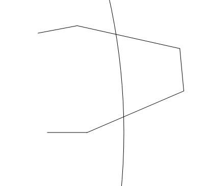

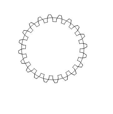

              Duncan Webster helped me out last month by writing a program in Python3 to draw involute gears. (I was and still am struggling with the maths!) Duncan's code, which requires the easygraphics module, is here on Dropbox.
              Duncan's teeth aren't drawn with curves, instead the involute is approximated by drawing a series of straight lines, i.e. facets. By default, the teeth are drawn with 12 facets, so a 20 tooth Mod 1 gear looks like this:

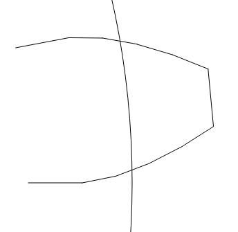

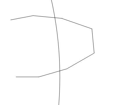

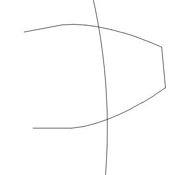

              I bodged Duncan's code to draw only one tooth with 1,2,3,4 and 8 facets, all scaled up so the eye can see the facets.
              Single facet teeth are obviously notchy:
              Two facets are a considerable improvement:
              Four facets are quite good:
              And at this scale, eight facets are almost indistinguishable from a true curve.

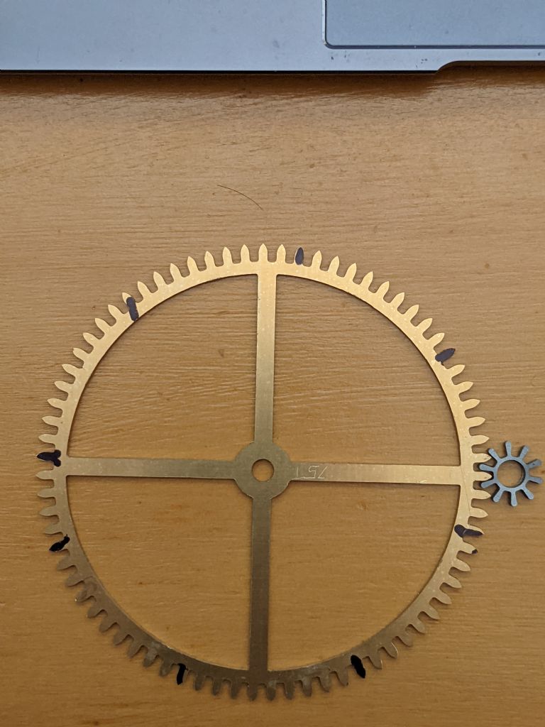

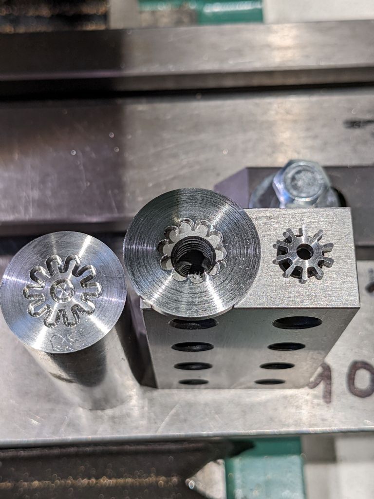

                        I just thought that I'd post a few pics here of some clock gears just made on the vertical mill, profiled out using a small end mill. The gear profiles were generated using Rainer Hessmer's Cycloidal Gear Builder, then the dxf files imported into CamBam for crossing out the wheels and generating the g-code. Pinions were milled into the end of a 1" FCMS bar held in a vertically mounted ER40 collet block, then parted off. I do 2 pinions one on either end of the bar at a time.
                        T
                        From L to R this shows the bar with one pinion ready for parting off; what's left when you part a pinion, and the parted pinion on the right. This is a 10t M1.0 pinion, the one still "embedded" is 1.25 module. These go with mating wheels in the "minutes / hours" 12:1 reduction – they have different modules so the arbor spacings are the same.
                        This is a 75t wheel/pinion pair with M1.27 for the seconds/minutes reduction.
                        All these cut with a 1mm 2-flute end mill. I haven't managed to break one yet!

                          Free cutting Mild Steel is a little soft for a pinion don't you think especially as it seems the same thickness as the wheel. Maybe this was just a demo piece?
                          regards Martin
                          #574370
                          John Haine
                            @johnhaine32865
                            Normally yes, but this is motion work driven by a stepper motor so minimal torque transmission.
                            #574374
                            John Haine
                              @johnhaine32865
                              Wheel is 1.5, pinion 2.5mm.

                              Martin Kyte
                                @martinkyte99762
                                Posted by John Haine on 05/12/2021 19:15:54:
                                Ah, that would explain it.
