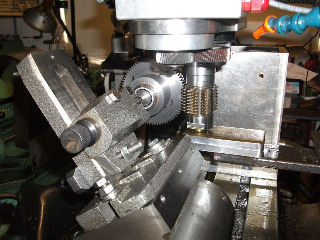

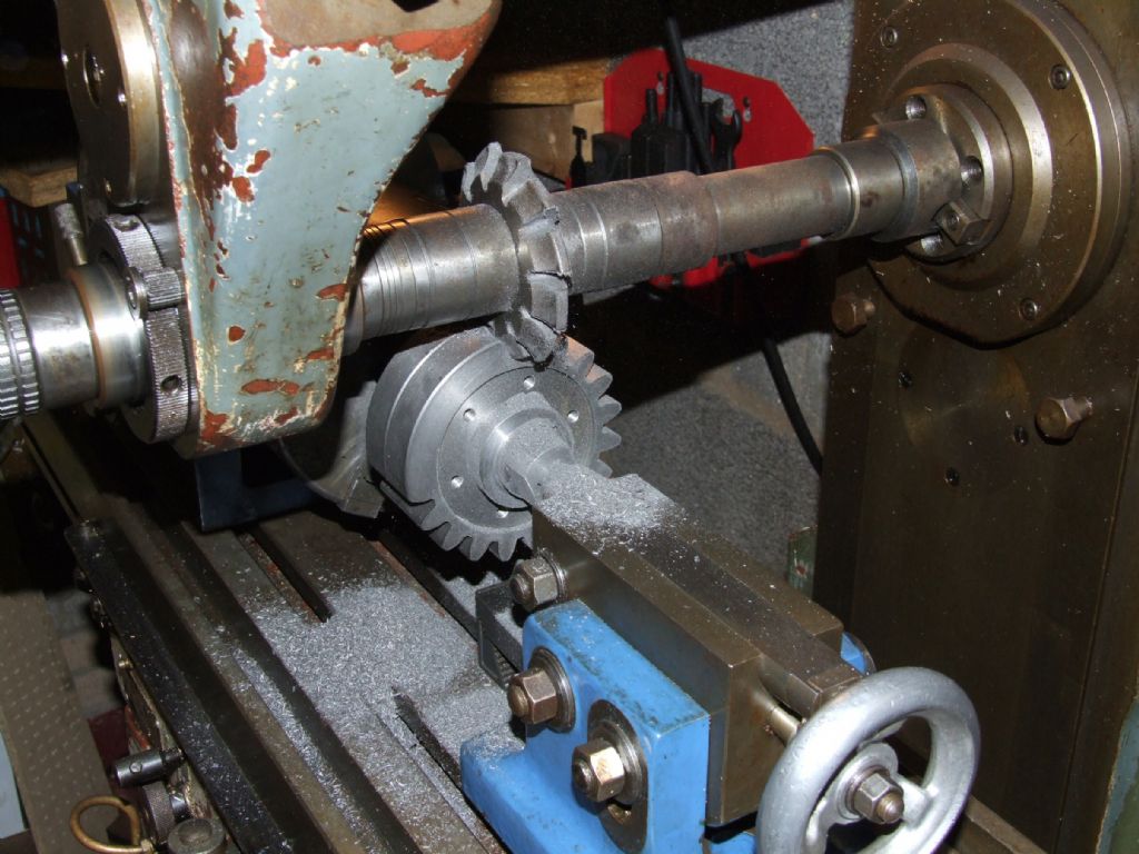

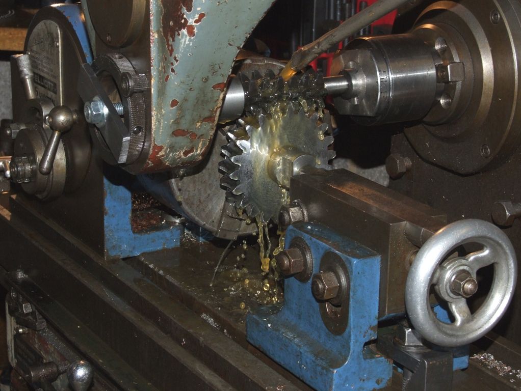

                Here is a photo of some spur gear hobbing ,i can tell you where you can
                get all of the items needed to do this , some of the links will
                be taken down almost instantly by the North Koreans so if you want to
                know you will have to send a PM.

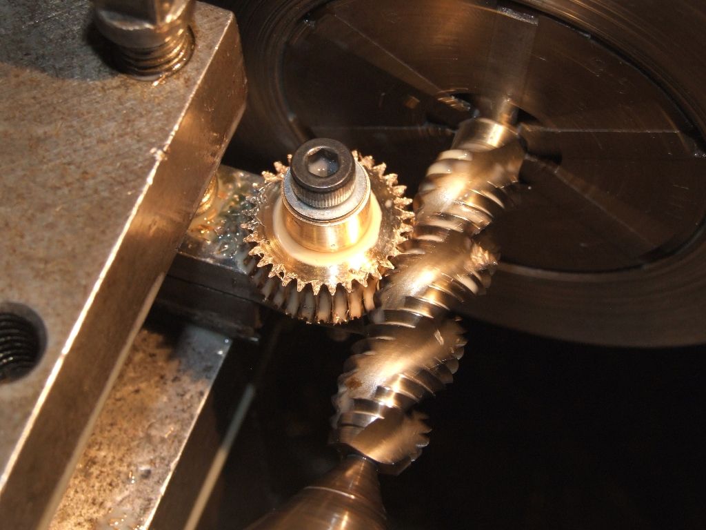

                    The method mentioned works fine for cutting worm wheels, although spiral flute taps are helpful:
                    Getting the correct number of teeth is a bit hit and miss. One can free hob a worm wheel, but it needs to be pre-gashed:

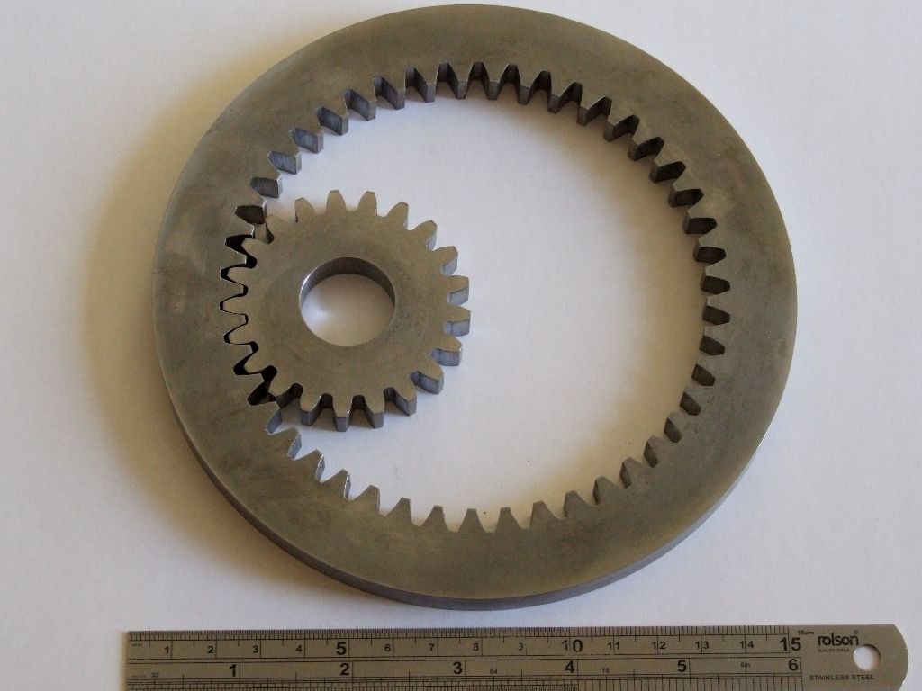

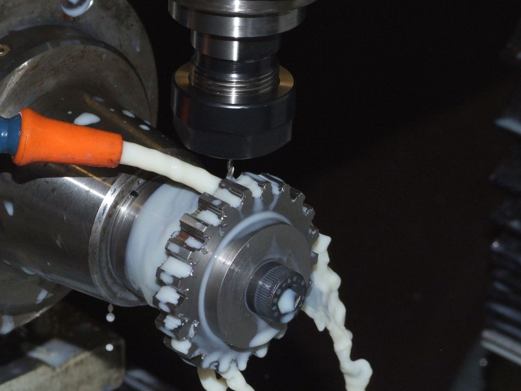

                    It doesn't take that long to cut spur gears by conventional methods, provide one gets on with it rather than pontificating on forums, two gears at a time in this case:
                    5DP Pinion Gears
                    If I want a quick gear, and don't have the appropriate cutter, I simply design it in 3D CAD and let the 4-axis CNC mill get on with it. As was the pinion:
                    For mating with this internal gear:
                    Andrew

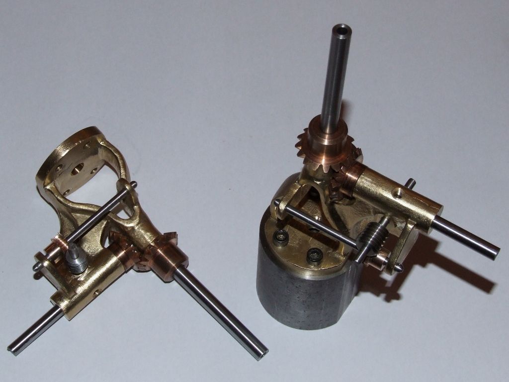

                                            Fair point. The teeth on the worm wheel I free hobbed with a tap look triangular. But the wheel is quite small (~1/2" diameter) so any involute curvature will be also be small. The tap was UNF so the pressure angle will be 30°. Since the tap form is triangular the gear teeth will tend to a triangle rather than the more familiar rack form. No doubt gears made by the same method will run together but there will be significant forces pushing them apart.
                                            The small worm wheel shown is for a speed adjuster on a Pickering governor, so I doubt it'll ever get turned:
