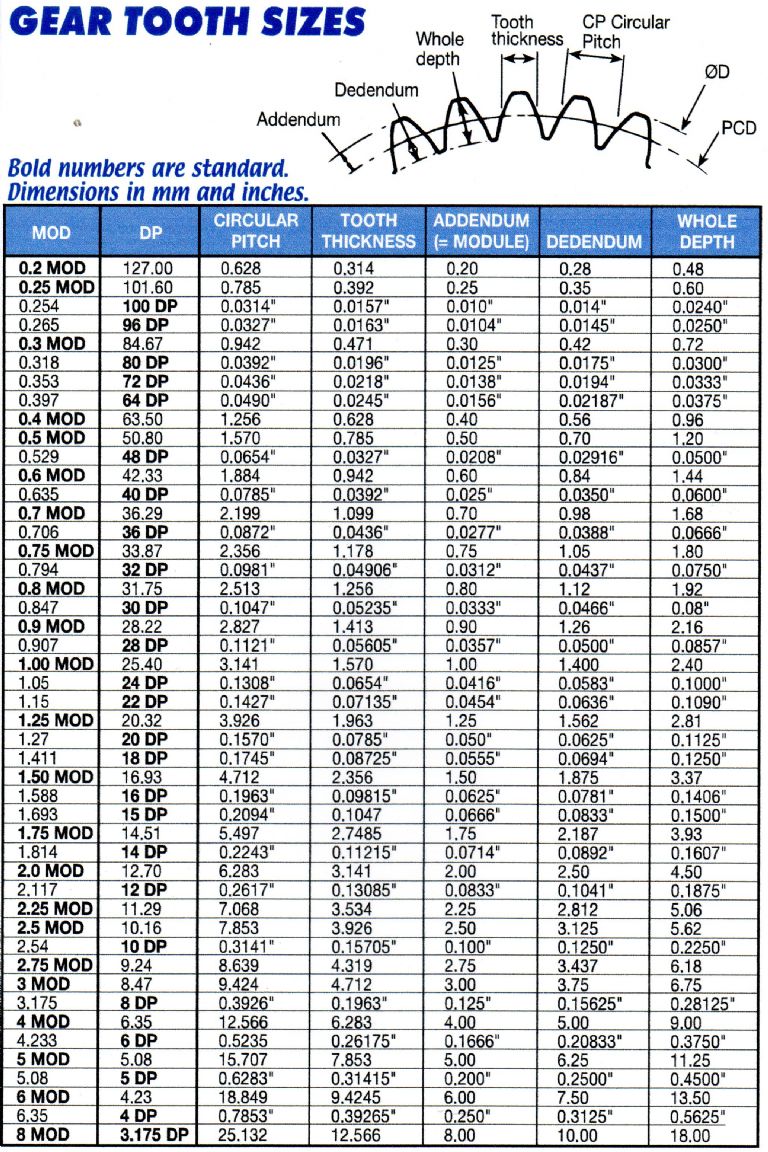

          Posted by brian jones 11 19/09/2021 23:06:16
          Why was the concept of DP Diametral Pitch introduced when the CP
          Circular pitch addresses the same size issue and is physically
          realisable ie you can measure it with calipers
          I expect it was more to do with the folk around at the time of his
          avatar setting out gears with calipers and circles of whole inches.
          Maybe it goes back further than this even to the time
          of wooden gears in wind mills.
          Although this does raise an interesting point for model makers ,
          just like using stock size threads mostly all gearing is
          Dp or module and made to a standard, for the production of
          small gearing and rack type rotary cutters this does not make
          much sense.For model engineering applications the only considerations
          for gears would be to fit in the space available the required tooth count
          and to look in the correct proportions it does not matter whether
          they are mod or dp or cp standard.
          Pitching out a 20 dp circular rack type cutter at .1571 inch is just
          plain daft, since a cutter is being made it would seem to be
          more sensible to use a CP system either imperial or metric
          depending if that you favor one or the other units.
          Laying out the spacing between each tooth can be so much easier
          using this system .The page here
          shows the near equivalent DP,CP ,MOD ,providing there is no intention
          to link up to a commercial gear train there is little point in doing it from
          a model engineering perspective.
          Dividing also becomes somewhat easier from the example above of 20 dp.
          eg for 20 tooth gear pitched out now at .150" CP instead of .1571 "
          moving the cutter down by . 030 inch and setting the dividing head
          to cut 100 divisions would ensure accurately timed cuts leaving just a
          few facets on each tooth.Similar combinations of other size gears
          just need to be worked out.

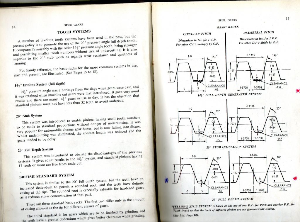

          The chart here
          shows the basic rack dimensions
          and there is enough information there to calculate the tip width
          and from that a form tool can be ground to make the cutter.

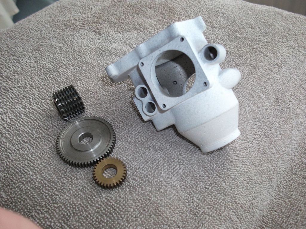

          There is some benefit to having cutters properly form
          relieved to avoid the type of finishes noted by
          Roger Best in his posting 21/09/2021 21:57:52
          "I did see some very good imitations of severely worn traction engine
          gears. Modelling to such realistic detail is wonderful."
          I made one of these circular rack cutters around 1985,because the
          cutter had no form relief the cutting action was so poor i never
          pursued the idea further,seen here a pair of
          timing gears and a cast crank case it was never completed.
          A few years later the Eureka device was published and provided
          an easy solution to the making of form relived cutters.
          Look in at Lathes .uk the latest submission there is a
          Micron gear hobber 102 a very interesting machine,
          apparently will cut gears down to 800 dp.
          In the section Brief General Catalogue 1960s-70s
          shows the smallest gear in the world the profile of the teeth
          looks remarkedly similar to BJ 11's gears.

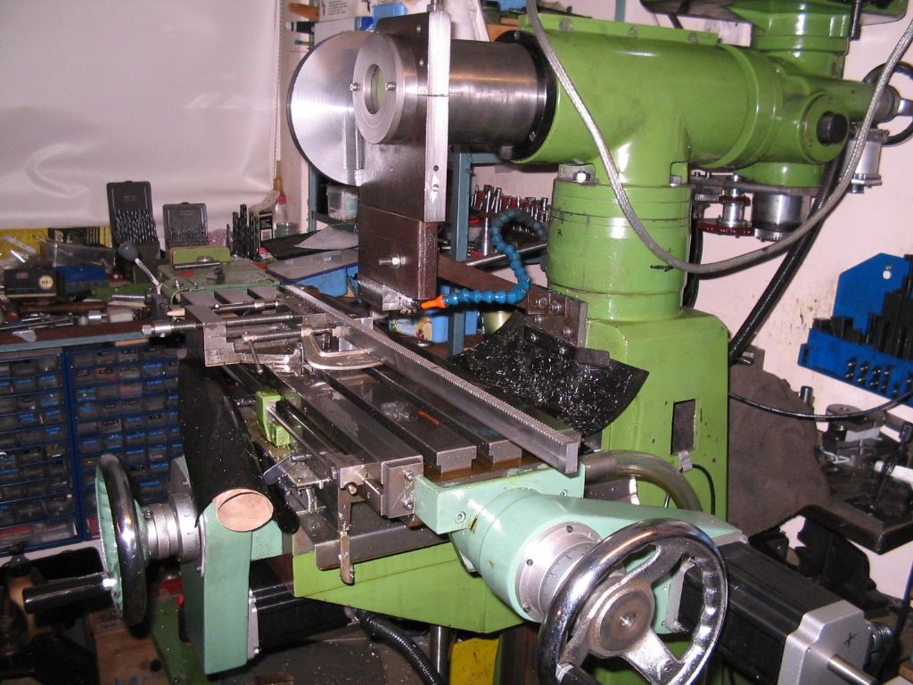

            Posted by John P on 18/09/2021 11:40:12:
            Somehow doubt if BJ 11 would be interested in cutting a rack.
            This one here took over 5 hours to cut the 159 teeth.
            Was definitely a "OMG what a painfully slow process as you mill each one"

              Posted by brian jones 11 23/09/2021 11:58:05
              You see I knew you were doing it wrong

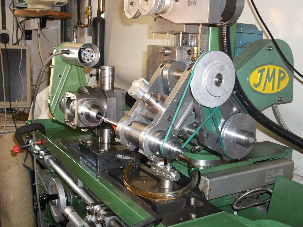

              I suppose 5 hours + for cutting rack teeth passes into
              insignificance in comparison 14 + years and still
              counting in making the parts the rack fits to.
              It's called making things

                Tremendous magnum opus, 14 years longer than most marriages then.
                Is it the sort of m/c to make special gear hobs?
                WaM
                #563999
                Anonymous
                  Posted by brian jones 11 on 23/09/2021 14:22:16:
                  Looks more like a cylindrical grinder.
                  Andrew
                  #564000
                  John P
                    @johnp77052
                    I'm being generous here , Brian 5/10 but Andrew gets 10/10.

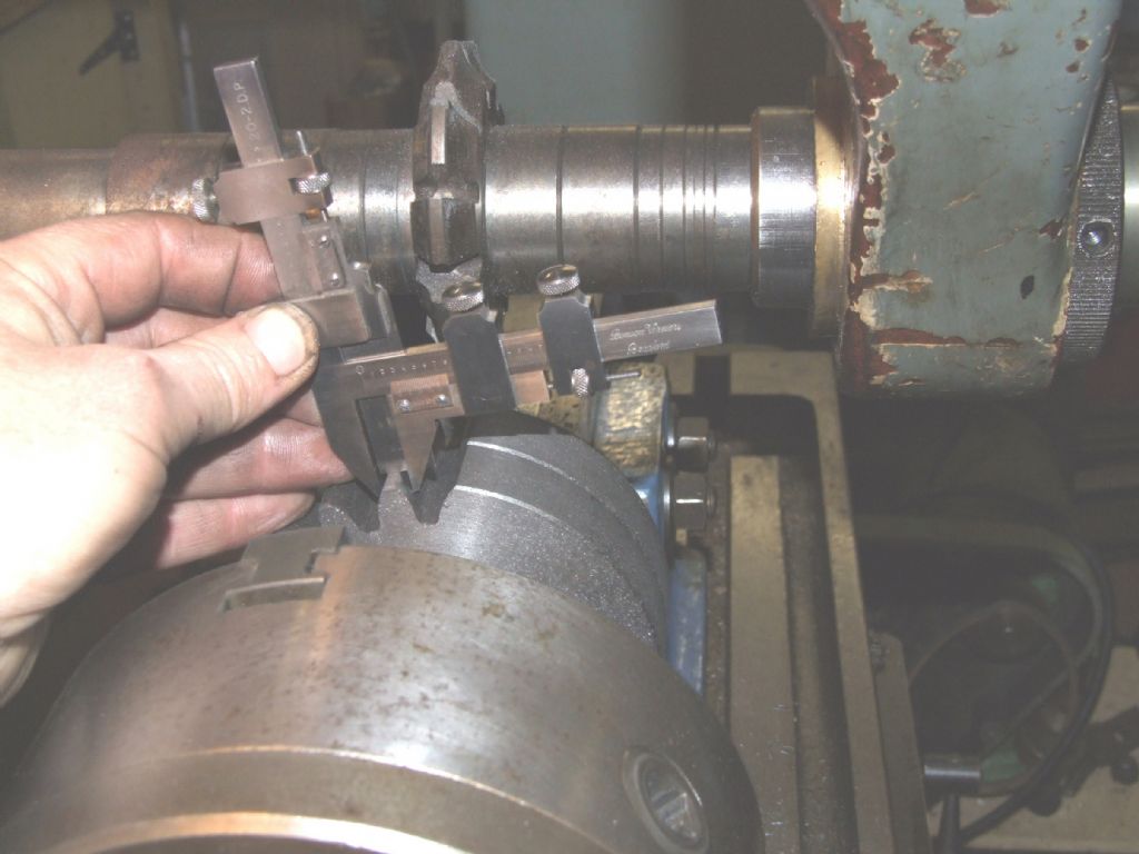

                        #564011
                        Martin Kyte
                          @martinkyte99762
                          Could I suggest that circular pitch is actually more sensible when you think of someone cutting gears with a saw and a file. or inserting teeth into a wooden gear. Once you have your pitch circle you can then mark the positions of the gears by dividers. Draw your lines and then start cutting filing or whatever.
                          regards Martin
                          #564013
                            But would stepping out with dividers not have the same problem as measuring with callipers in that you are stepping out a cord not an arc?
                            #564021
                            Pete Rimmer
                              @peterimmer30576
                              Posted by JasonB on 23/09/2021 17:09:19:

                              #564028
                              Martin Kyte
                                @martinkyte99762
                                My point was the a suggestion as to the origins of circular pitch. So historically if it was about planting teeth around a circular disk or shaft by using hand tools and simple measuring tackle then it seems to me to be the origins of CP as a way of describing gears as it was essentially how you made them. The Anticythera machine was probably hand filed gear wise and certainly had some very unusual tooth counts. Gearing would be slow moving and sliding would definitely occur. Low friction gearing for clocks and rolling action for high speed power tramission would have been far into the future. Module and DP are better ways of doing things in the machinary age and as said dividing has long superceeded marking out.
                                regards Martin

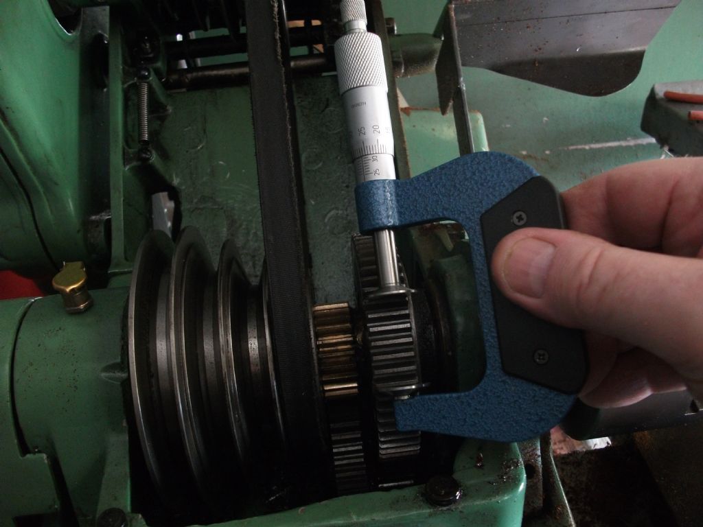

                                  Posted by Andrew Johnston 23/09/2021 15:22:18
                                  Posted by brian jones 11 on 19/09/2021 23:06:16:
                                  ….CP Circular pitch addresses the same size issue and is
                                  physically realisable ie you can measure it with calipers…
                                  You can't measure CP with calipers. Circular pitch is defined
                                  as the length of an arc on the pitch circle diameter. A caliper
                                  measures between two points on a line, which is also not likely
                                  to intersect the PCD at the point of measurement. Using a caliper
                                  to measure across multiple teeth doesn't give CP either. There
                                  are published tables that give theoretical values measured across
                                  multiple teeth to get pitch and backlash, but they don't give CP.
                                  Andrew
                                  Whilst this is true and you can calculate the sizes of gears in
                                  circular pitch, you can check the size of the made gear by
                                  measuring across a number of teeth using this calculator from Ondrives
                                  https://www.mesys.ch/calc/ondrives.fcgi

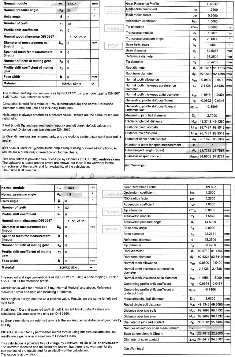

                                  The inputs are module gear sizes for example the bull gear
                                  here on the Myford at 16 DP
                                  Input on the top left column 16 Dp = 1.5875 module
                                  second line down pressure angle 20 deg
                                  9th line down if you put in a tooth count any number
                                  eg 60 tooth the diagram at the bottom of the page
                                  will show the tooth profile of the main and mating gear.
                                  The 6th column down is the normal tooth allowance
                                  DIN 3967 adjusting the number in the check box will adjust the
                                  Base tangent span at the bottom of the right hand column
                                  (Left box)
                                  and display the gear profile and backlash at the bottom of the
                                  page.The two examples here also show how you can check
                                  the PA of a gear ,something that crops up fairly often on the
                                  forum ,as can be seen numbers of teeth in the span are different,
                                  at around 30 tooth the differences are quite small but still enough
                                  to be a reliable indicator.

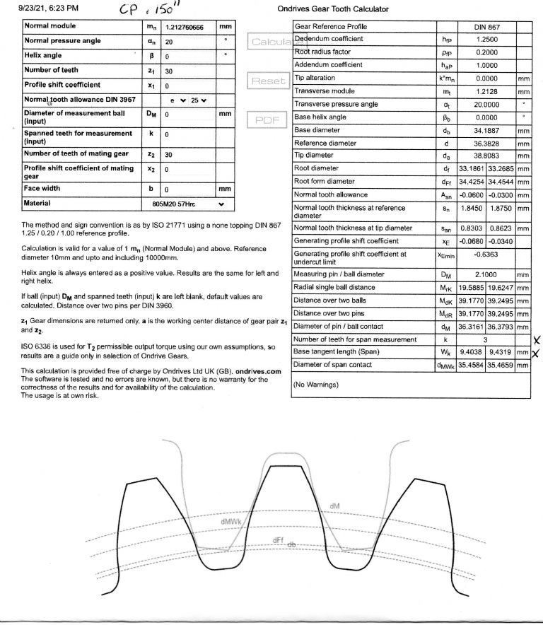

                                  Getting back to the CP measurement to convert cp to mod
                                  eg .150" = 3.81 mm 3.81/ Pi = 1.212760666 module
                                  feed this into the Ondrives calculator here.
                                  and use this to check the gear.
                                  Going back to the Myford gear.
                                  From the previous table for the Myford bull wheel
                                  here is the gear as measured appears to be about
                                  .006 mm over the size indicated on the table.
                                  A disc type micrometer is a useful thing to have
                                  to measure these gears a normal caliper may fit in
                                  providing the jaws will get past the pitch circle.

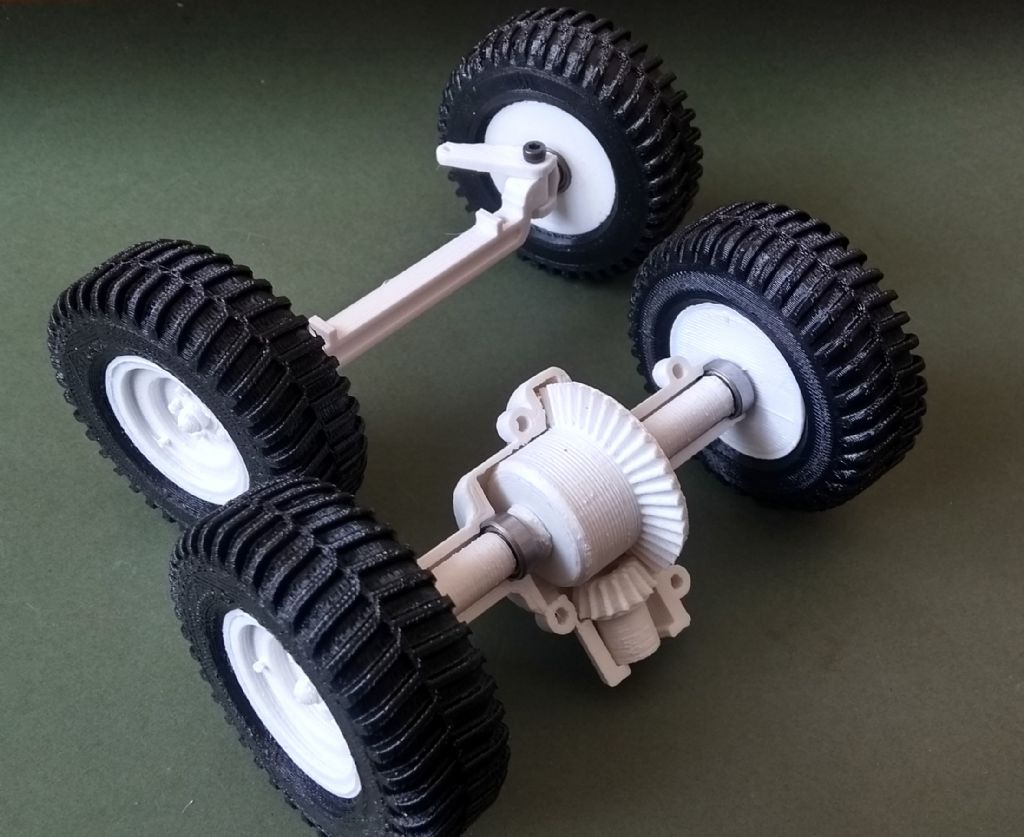

                                        Someone mentioned plastic gears.
                                        Confession – I didn't design the differential gears, just the wheels and outer casing.

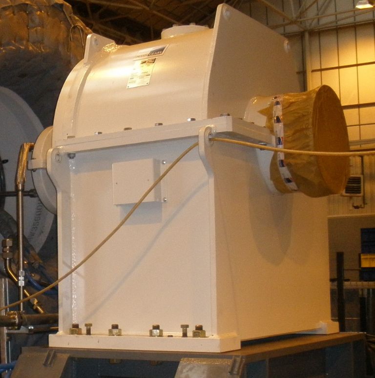

                                              At work we bought in planetary gearboxes from the likes of Allen. When you looked at all the criteria they took into account to avoid harmonics causing issues it was very complex and best left to the experts/specialists.
                                              Martin C

                                                All you needed to know about CP and the Base Bitch
                                                https://www.geartechnology.com/articles/0992/Base_Pitch_Tables/
                                                this past post went into the problems of measuring a gear (as opposed to calcs + suck it and see)
                                                You cant just use calipers / disc mic and measure PCD just like that
                                                https://www.model-engineer.co.uk/forums/postings.asp?th=166048
                                                If you have two gears meshed together you can deduce the pcd from distance between centres

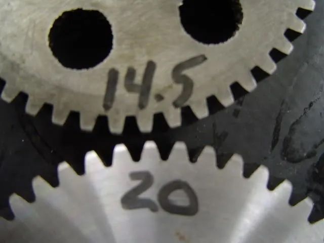

                                                then there's the eyeball method

                                                    I think the article by Jannick referring to Base Pitch is meant to be what we call the CP
                                                    His Base Circle is what we call the Pitch circle or defined as PCD
                                                    I think this was before AGMA got involved
                                                    SIAS means you cant actually measure the PCD once youve cut a gear and need another one to mesh before you can deduce PCD with confidence – all the rest is gear snobbery
                                                    but thats my junior opinion, what do I know – not a lot as has been amply shown
                                                    WaMembarrassed

                                                      Pretty sure you can calculate PCD from Mod and tooth count, and can do Mod from tooth count and outer diameter.
                                                      From that you can layout the centre distances of a pair of gears.
                                                      PCD for a single gear is not a very useful number anyway
