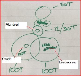

                  #121026
                  rebekah anderson
                    @rebekahanderson95322
                    This is the current set up.
                    Photobucket Pictures, Images and Photos
                    Edited By rebekah anderson on 30/05/2013 12:31:06

                        rebekah anderson
                          So if we look at my drwing, the 12T needs to be changed to a 20T then the left 100T to a 50T and the 20T thats on the 100T remains the same. The lead screw changes from 100T to 55T
                          This would give me a pitch of 1.0
                          Edited By rebekah anderson on 30/05/2013 14:38:47
                          #121039
                            Now I'm not a myford man so shoot me down if I am wrong but that table won't work on your ML2. As JS previously said you don't have two studs so this is basically what you have
                            #121040

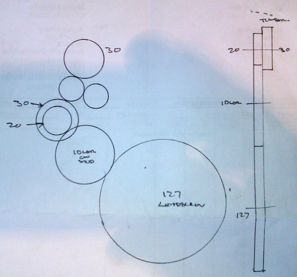

                            rebekah anderson
                              Right so thats what i thought but every one was saying to reffer to the chart and saying about stud one and stud two along with listing a load of gears.
                              Now i don't have a clue any more what i need to do.
                              Can any one just use the drawing and annotate what gear i need to mount where.
                              Please please. I don't want to buy a load of gears only to use a couple. Rdg sells them induvidually so no problem there.
                              Will luv yah forever
                              #121042
                                As you are going to have to buy some gears anyway why not buy a 127T as that can be used with your existing 20T and an idler to give your 0.5mm
                                On the mandrel change the existing 12T to a 20T. On the leadscrew fit a 127T and on the stud fit something to bridge the gap on stud No 1. This is refered to as a simple gear train as you don't have two gears on the same stud
                                Maths :
                                20/127 = 0.15748 of a turn of the leadscrew per turn of spindle
                                8tpi leadscrew gives 25.4 / 8 per turn or 3.175mm per turn
                                3.175 x 0.15748 = 0.4999999mm per rev of the lathe spindle
                                Do wait for someone else to confirm this before spending money on gears, I should think something like a 40T for the idler would be about right and by swapping the 20/40 positions you will be able to get 1.0mm pitch
                                Edited By JasonB on 30/05/2013 15:39:52
                                #121043
                                  It actually depends which calculator you use
                                  … We have trodden this path before.
                                  The answer to Jason's calculation is really 0.5
                                  Edit: corrected typo
                                  Edited By Michael Gilligan on 30/05/2013 15:21:06

                                                Looking at your lathe again it may be a bit tight to fit a 127T in which case the two 21T option JS suggested may be better
                                                21T on the mandrel driving a 35 on the stud, also on the stud and keyed to the 35T fit another 21T to drive an 80T on the leadscrew.
                                                Maths
                                                21 / 35 = 0.6
                                                21 / 80 = 0.2625
                                                0.6 x 0.2625 = 0.1575
                                                0.1575 x 3.175 = 0.50006mm pitch
                                                #121053
                                                John Stevenson 1
                                                  @johnstevenson1
                                                  127 has an OD of 6.45 but another problem i can see is that becky has the 12/30 fine feed gear which is a one piece gear.
                                                  You can't remove the 12T to replace with any other, she needs one of these.
