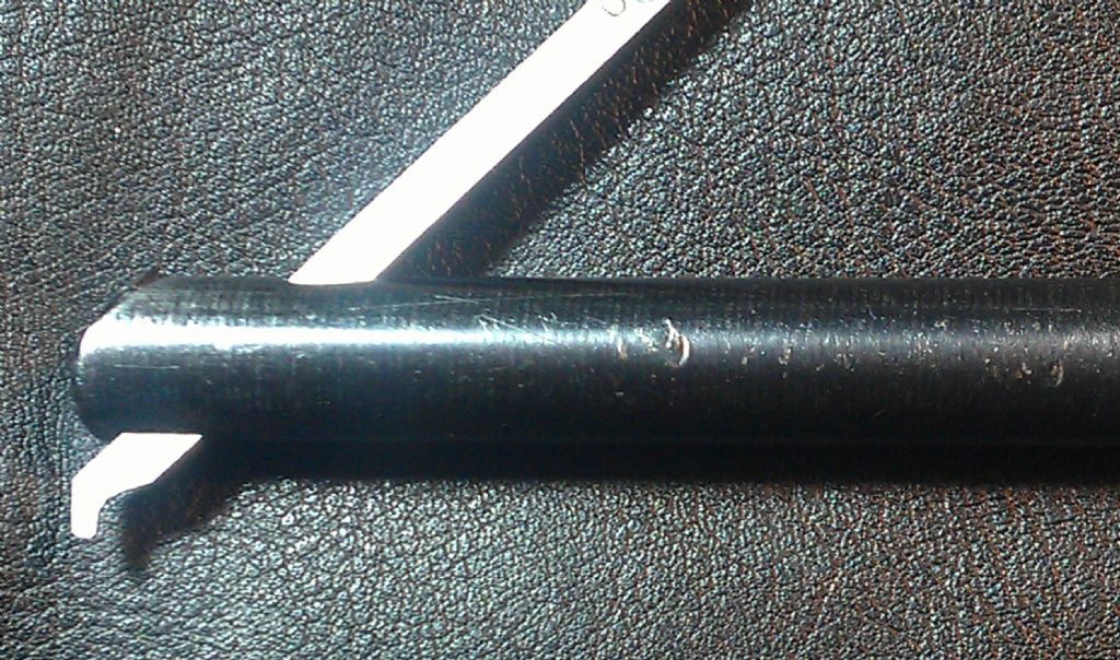

                          Hi Michael,
                          OK it clearly wasn't perfect, and I no longer have it (it was tiny!) but I found an old picture of it.

                            Thanks Neil … That's pretty darned good.
                            I hadn't realised that you were using square tool-bits in your boring bar. For some unjustified reason, I had presumed you were suggesting 1/8" diameter.
                            Touché

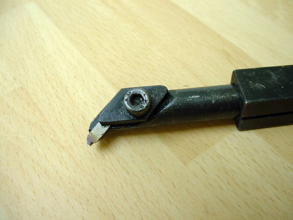

                              I must say I like Muzzer's idea of a well supported tap being used to cut internal threads. I have tried using a tap and even though I shortened it significantly I managed to break it taking very fine cuts.
                              Like Neil I also use a 1/8" square HSS in a 45 degree boring bar holder. The picture is of one I ground for an internal 220mm diameter 1.5mm pitch square thread (in aluminium and only 3 threads up to a shoulder)
                              Ian P
