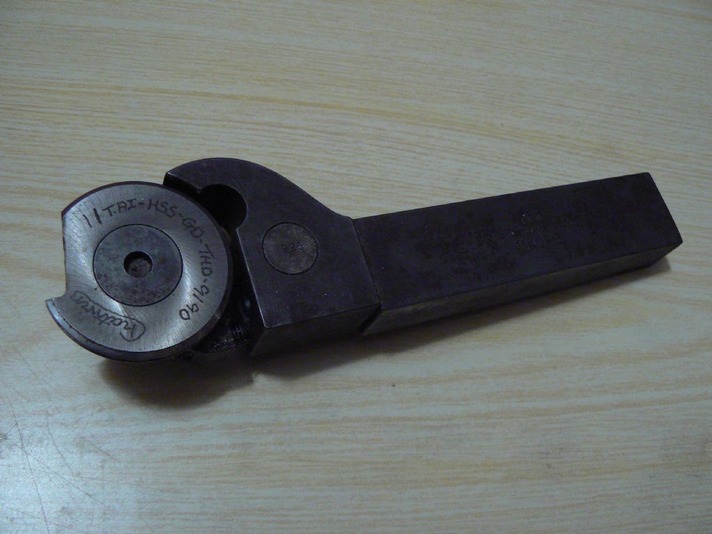

                        #216661
                        Martin Connelly
                          @martinconnelly55370
                          Ady1
                          I have one of those pre-insert days external threading tools marked up as Eskilstuna – Sweden. I will upload a photo and post it. The circular die is about Ø42mm so it would be hard to use for any small internal threads if a suitable holder was made. It has a screw at the front for small adjustments to the stick out and the head can be swiveled on the body to allow for different helix angles. As I say it was pre-inserts. I think they have been replaced with throw away inserts now. Reduces the need for someone to sharpen it and then for the tool to be re-set.
                          Jon
                          I have a thread milling tool I made with Horn inserts in it. Could be used for internal threads if there is a big enough bore.
                          You can see it in action here.
                          **LINK**
                          Martin

                            robjon44
                              @robjon44
                              Hi all, during my apprenticeship I did shedloads of large bosses with BSP threads in them for hydraulic tanks, we used Alfred Herbert circular cutters with a 1 inch round shank in a holder specifically for them in the 4 way tool post, have not seen one in years although I do have a holder. Can't even find a picture, but I would suggest that anyone thinking of going down that road, HSS, easy to offhand sharpen, easy to set, could do worse than to use orphan circular dies from BSA / NAMCO dieheads still made in modern times, world probably waist deep in them especially odds & sods. Attach to boring bar along front of toolpost with single screw etc etc. Take side trip to gear cutting section, fill Fairy Liquid bottle with viciously politically incorrect sulphurised cutting oil apply as necessary, wash hands occasionally, get beautiful shiny finish on thread, job done.

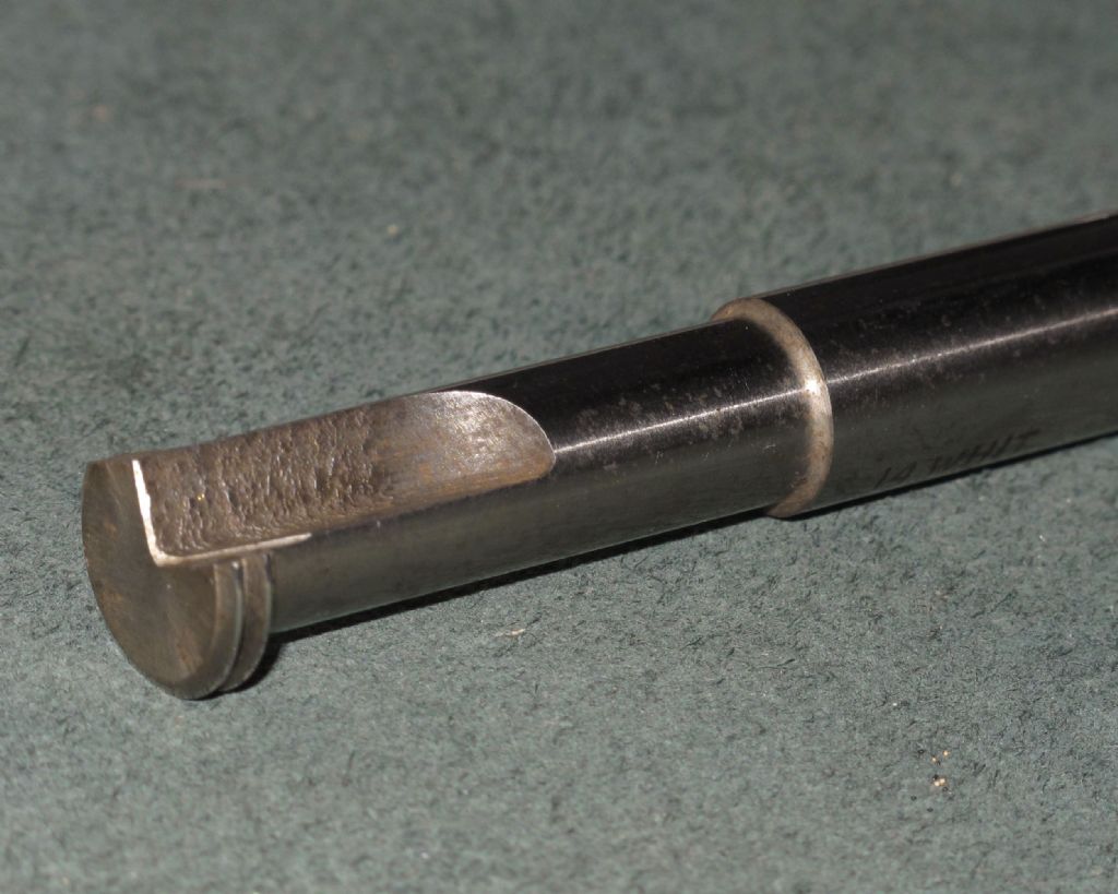

                                      #216818
                                      Saxalby
                                        @saxalby
                                        Are these the sort of thing the OP had seen.
                                        Bought a load years ago (£5) at a motorcycle auto jumble. Various Whitworth form threads.

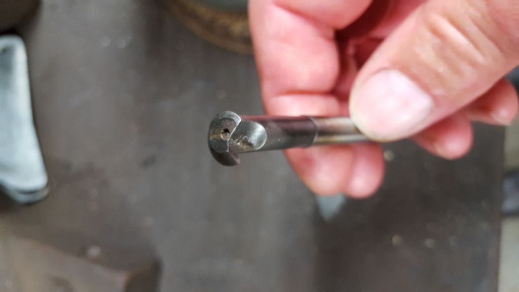

                                          #225019
                                          Peter Pearce 1
                                            @peterpearce1
                                            This is the one I have seen. More pictures on ym album.
                                            Regards Ponce.
                                            #225021
                                            Hopper
                                              @hopper
                                              Posted by Peter Pearce 1 on 12/02/2016 07:35:39:
                                              Regards Ponce.
                                              Nice idea. Looks like it could be turned out out of silver steel and hardened. The cutout could maybe be done on the offhand grinder.
