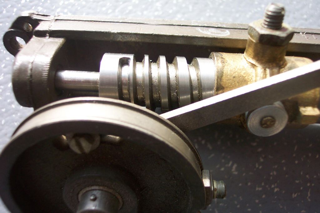

      Hello Everyone,
      I have puzzled on and off for years on how the guidance form was machined 70 years ago without the benefit of today's CNC methods
      These components were made in ten's of thousands in the USA. It it superbly made and finished, the thread form has I think been ground after milling. The barrel is 1/2 inch diameter and the groove is 29 degree ACME form.
      My question is how would you go aboutdoing this using mechanical methods alone to form the logarithmic shape, there must be amongst the forum members plenty of experience. I have my own ideas, but it would be interesting to see what the rest of you think. There should be 3 photos if I've pushed all the right buttons.
      Brian

              I don't know about then but now, not having a CNC setup, I would couple the mill table to a universal dividing head using a spiral pulley and a wire instead of gears. Od course that means a spiral has to be made thus creating a new problem.smile p
              Is it specifically a logarithmic relationship of just not linear?

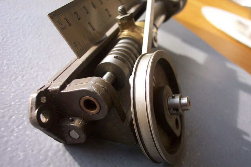

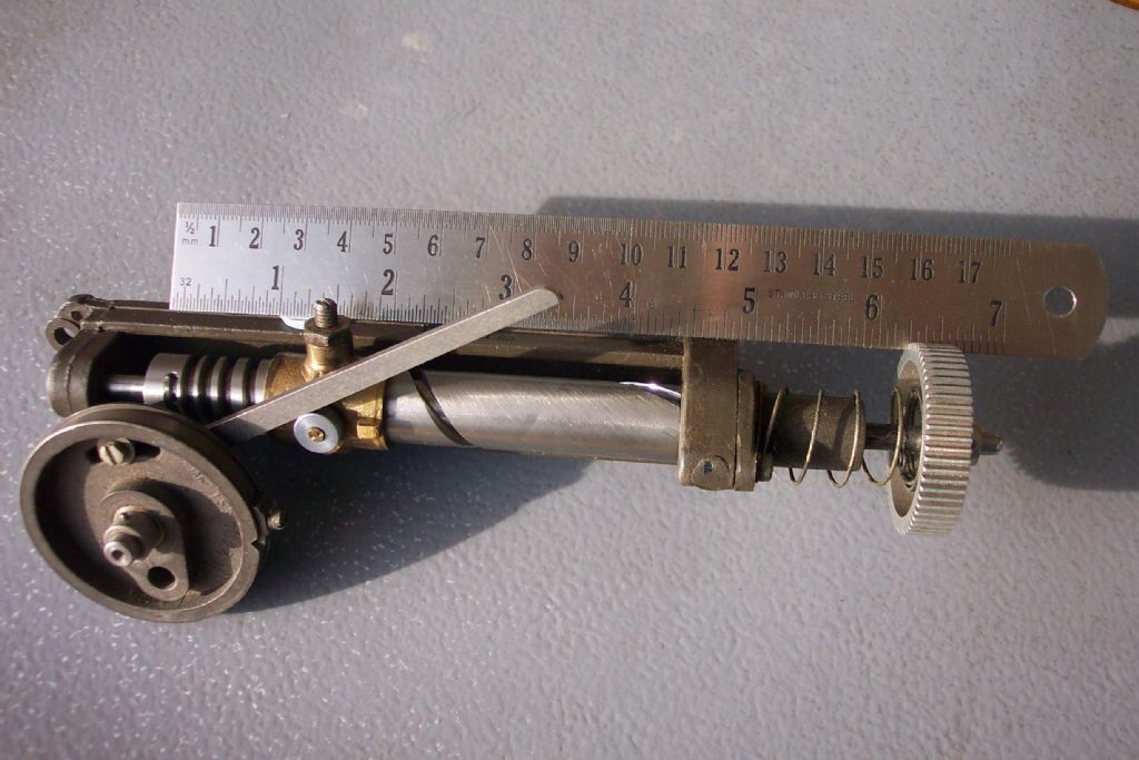

                        Hello Michael and Bazyle,
                        I finally managed to get the photos to load, it seemed to want to handle them one at a time, Part of my trouble is that I don't have a 5 year old in the house to show Grandad what an old fool he is! The result is I'm afraid both messy and bitty.
                        I don't know which non-linear form the thread is, it might well be trigonometric. Would it actually make much difference to the process of producing it? I rather doubt it.

                          The spiral form is very clearly milled, starting with a plunge cut at the closed end. The finish is too good to be left at that, it has also been ground so that motion to the bronze carrier is still possible from the run out end of the thread where side forces have more effect. Under a good lens I can see the witness marks of the milling at the start, and moreover, the ground acme form seems to been achieved by angulation of the stone; the bottom of the groove finishes in an inverted Vee

                                      Screw shown in pictures was just thread milled in a very simple jig on a milling machine . Common shaft , blank on one end and master on the other end . Shaft arranged to slide and rotate in a support block . Fixed pin or roller engages in master such that rotating the master by hand or under power causes blank to follow required profile under milling cutter .
                                      Master would generally be made larger diameter than finished workpiece . It could be precision made but more often than not masters were quite crude – even as crude as a strip of steel wound round a bar .
                                      Advantage of doing it this way , apart from simplicity , is that set up can be used many times for either multiple cuts on one blank or the making of production series of parts – in all cases without any risk of loss of register between master , blank and cutter .
                                      The making of all sorts of funny screws , cams and gears was common in the days of mechanical analogue computers .
                                      Some of theses screws , cams and gears could have generated shapes but more often they were made as one off's using hand made masters .
                                      Sometimes masters were made very big and also sometimes geared or worked via lever arms to get better workpiece control and to reduce errors .

                                        The job was probably actually done with a sliding spindle auxilliary headstock – the same set up as described above but using a proper piece of equipment with a substantial spindle and provision for work holding in the normal way .
                                        Machine manufacturers of bygone times offered all manner of useful attachments for their machines . Auxilliary headstocks of several different types were commonly available for high class machines . Usually supplied for lathes but could easily be adapted for milling and grinding .
                                        Apart from the sliding spindle type the other common auxilliary headstock were the high speed , raised centre height and shuttle spindle types .
