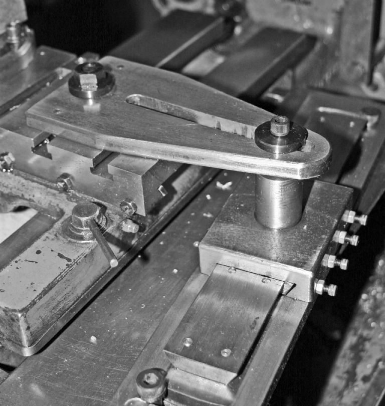

      There are many ways to cut a clock fusee ranging from complete freehand turning with graver to machining a mathematically perfect curve on a CNC lathe. The commonest method recommended in books on the subject is a copy lathe arrangement where the cross slide follows a template. I've just cut a fusee using the Turnado free-hand turning system and I have not seen this described before. The Turnado system consists of a flat surface bolted to the cross slide on which a tool post is free to move under manual control. An option with the system is a copy attachment and I set this up with a template of the fusee curve as below
      This is the fusee during cutting
      and this is the final fusee before cutting the grooves
      This was my first attempt at using the Turnado copy attachment and I was very impressed. The tool post followed the template very accurately and the whole set up is much more rigid than you might imagine. I was very pleased with the result. My preferred method for fusees from now on I think. Thought other constructors might be interested. Could be useful method for other curves on a manual machine.

                  All I had available (in the 70’s*) when turning the fusee for John Wilding’s skeleton clock with lever escapement (and room for a pony), was the taper-turning attachment.
                  It was a relatively simple exercise to mount the curved template to the slide bolted to the back of the machine, seen here but set for taper turning.
                  The follower was a ball race secured to the cross slide (with its leadscrew removed).
                  At the same setup (without removing the workpiece), it was a simple matter to cut the groove. Light pressure applied to the ‘front’ end of the cross slide was all that was needed while the saddle was engaged to traverse. The top slide, set to 90°, provided the depth of cut.
