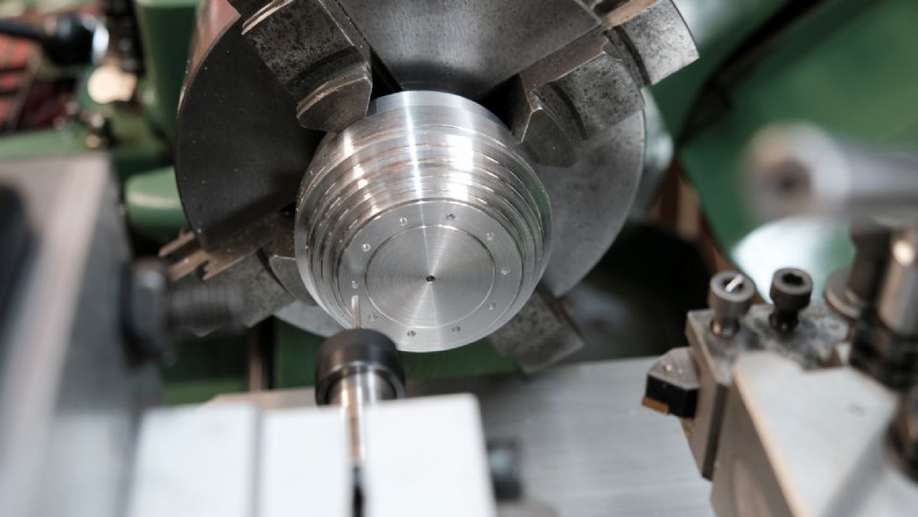

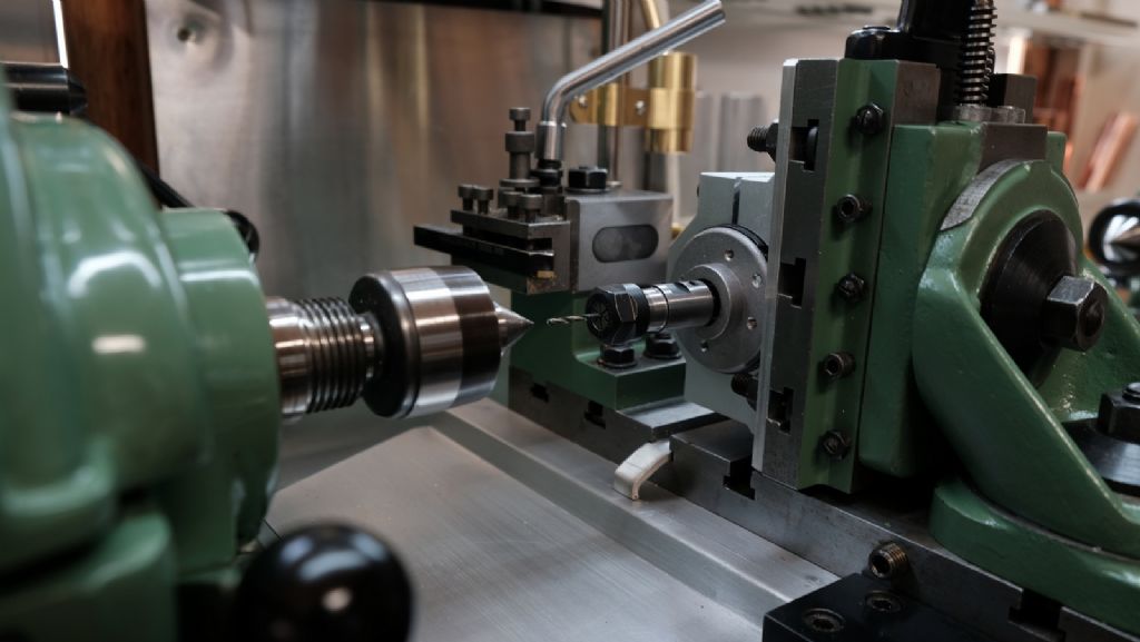

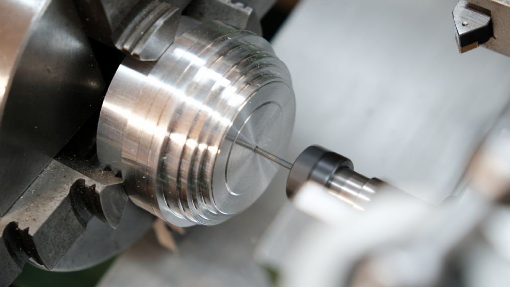

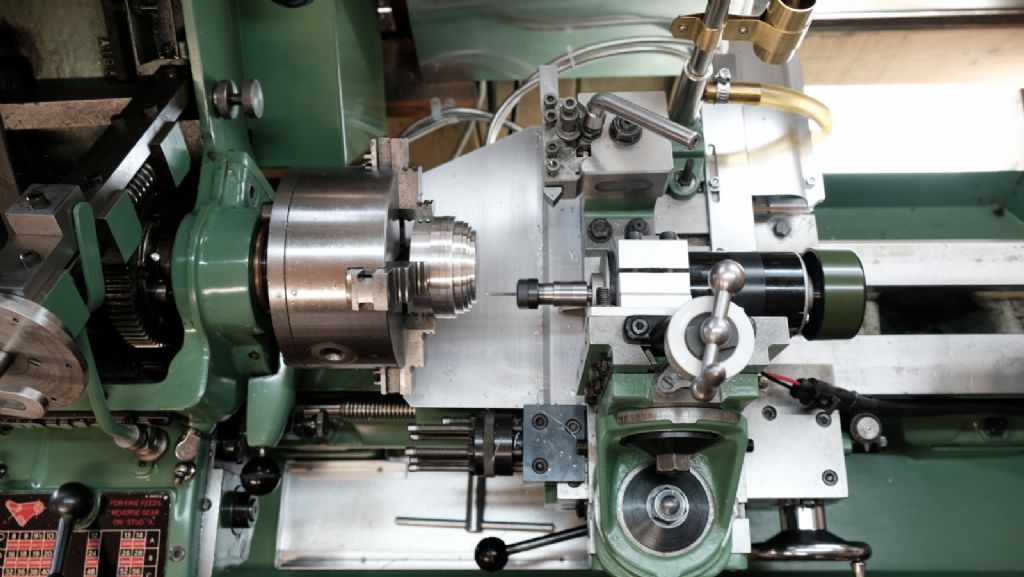

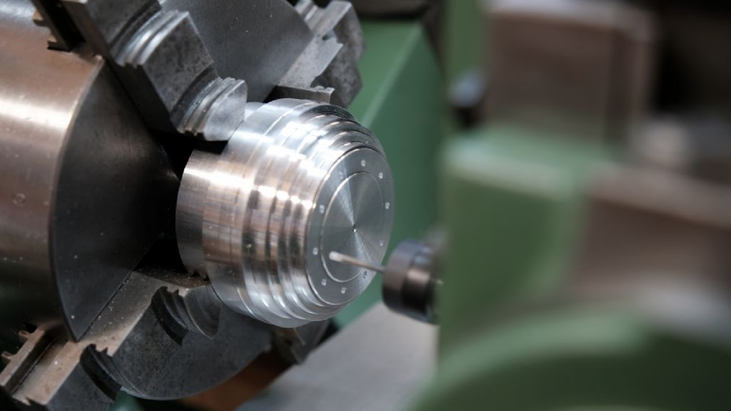

      Hi Folks
      I just finished making this attachment for my lathe. I cant take credit for the idea as I saw this by a chap called Steve Jordan?
      Anyway, It looked like a neat versatile unit so I thought I would have a go myself. It worked out pretty cheap too as the unit was only 50 quid, the box was 4 quid and a set of cheap collets 25 quid.
      Its obviously got its limitations but I think for small detail work it will be a valuable addition to the workshop.
      Some pics and a youtube vid showing the result of a quick couple of tests
      Carl

          Very nice, that's a neat job. Does the drill motor run on 12v dc?
          Lovely looking lathe.
          Can you remove that chuck key before someone sees it.(I didn't see it ).
          Bear..

              Mains, though I dont know what the output is when it comes out

                Dont worry about the chuck key. The lathe cant turn with the dividing head attached laugh

                  I'm quite happy with the chuck key where it is. the chuck isn't going anywhere with the dividing head in place. John Wilding used to recommend tying a weight on the end of a bit of string attached to a chuck key to keep the backlash out of the dividing arrangement but then I guess it was a tongue in cheek remark of Bear's.
                  Handy attachment, how fast does it go?

                    3000-12000r/min
                    I presume the motor is designed for the wood routing cnc machines that people make ? At max chat it spins like billio and at low rpm it appears to have reasonable torque !

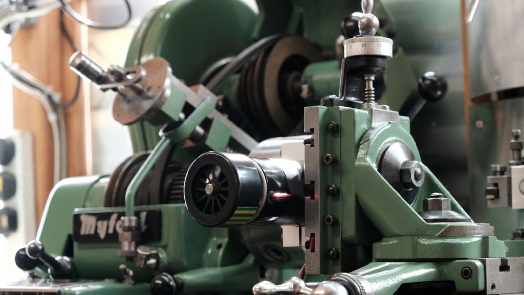

                      I'm not sure I would like the idea of that rotating fan on the opposite end of the motor to the chuck right in from of my tum!

                        Ive got a flat-ish tum so no interference teeth 2

                          Me too, but still. one could lean across to have a closer look…
                          But a neat little unit, rather like the QuickStep mill.

                            What are the bearings like on the motor? Are they likely to be reasonably robust to sideways milling forces?

                                  Hi John, I have no idea is the honest answer. It appears to be well made and designed and manufactured for CNC milling ( Most likely MRD and plastics ? ) I think for ali and brasses, small detail work it will be more than adequate. I suspect it will protest more at bigger cuts on steel and SS however. But for the price, defo worth doing IMO.

                                    Will it fit and drill parallel to the head stock?
                                    Edited By JasonB on 21/06/2020 20:26:43
                                    Yes laugh
