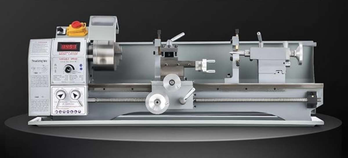

      There are two options on the Amazon link in the OP. This one looks quite different.
      I’m wondering if it has a thread cutting gearbox?

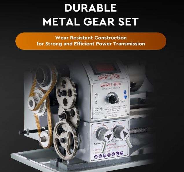

          Vic, probably the same as many others. One of those knobs is fwd/rev of the lead screw. The other gives three ratios through the basic “gearbox” so for ant gear train you can get 3 different feed rates or three different pitches. Usual set up is 1:1, 2:1 and 1:2. One downfall of the lathe that is mainly featured is there does not seem to be a tumbler reverse.
          This can be a problem with some of these sale listings. The pictures are not of the machine you think you are getting and the specs are not always the same. Take the 3000rpm in one image and 2250 in the description. As for the image of it “drilling” I’ll leave that up to the members to decide. Also the “granular handwheels” may mean it is one of the earlier mentioned machines with sand in it.

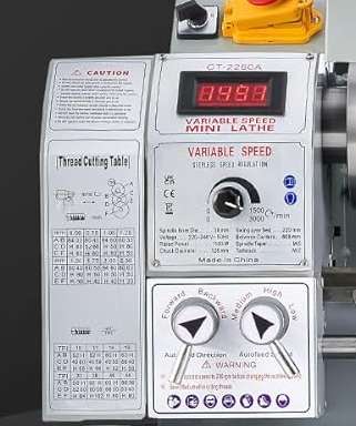

            This confirms what I said above – Fwd/rev and Med/High/Low

              Pretty sure it doesn’t have a gear-cutting gear-box.  Zooming in on the advert reveals:
              crewworks
              The two knobs control the autofeed (leadscrew) only: Forward/Reverse and High, Low, Medium.  And the threading table appears to me Imperial Threads only (TPI), produced by only 6 gears that have to be changed on the banjo.   I reckon the Creworks lathes are variations from the usual Chinese hobby family, simplified for the US market – perhaps gun-smithing.

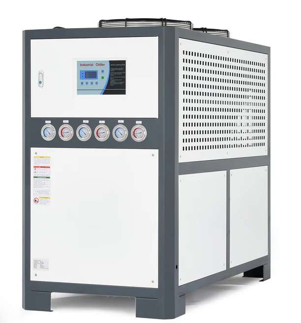

              Not being sold via Amazon in the UK yet, but for a properly equipped workshop we obviously all need one of these:
              15Twatercooler
              It’s a 22HP (16kW) water cooler.   Replace your slow-mo manual lathe and mill with a line of busy CNC machines running so fast they have to be kept cool with this serious bit of kit!

                  Nice to see the intelligent use of a Poly-Vee belt system and a variable-speed motor.
