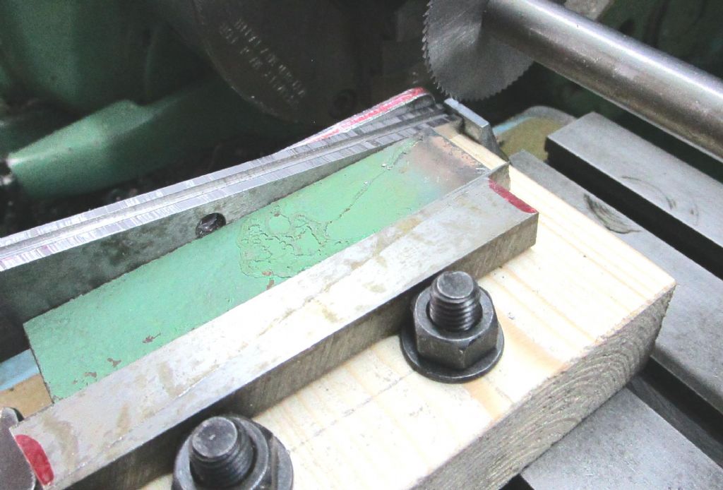

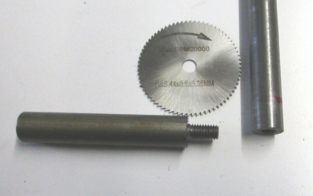

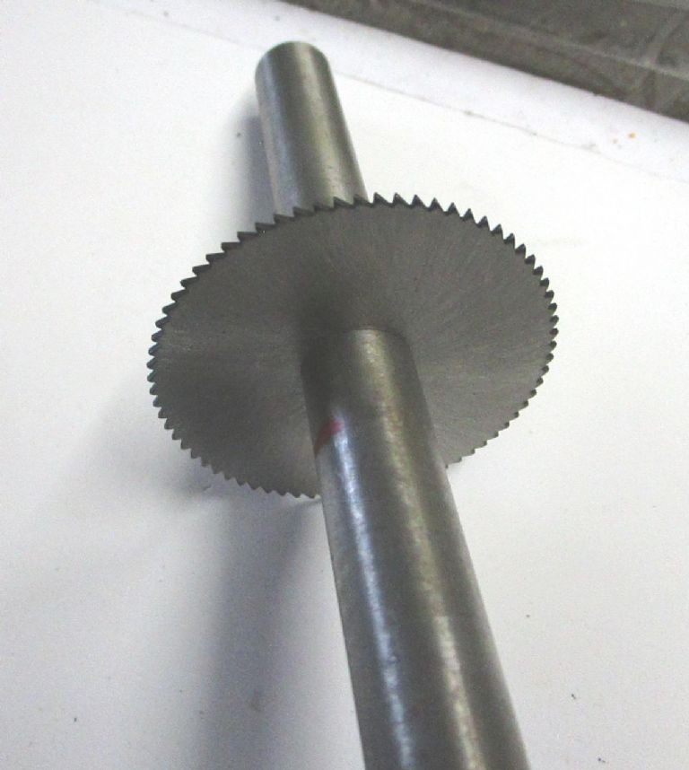

                    Hi Guys,

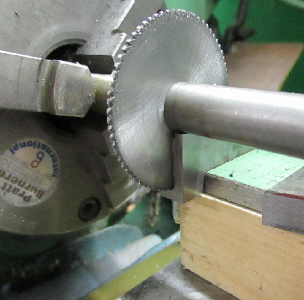

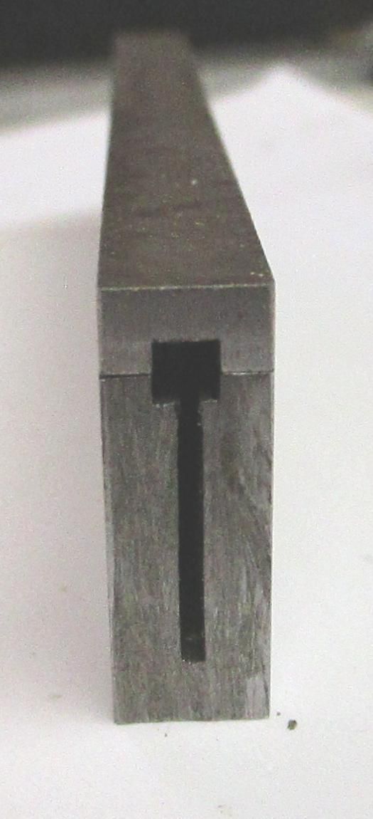

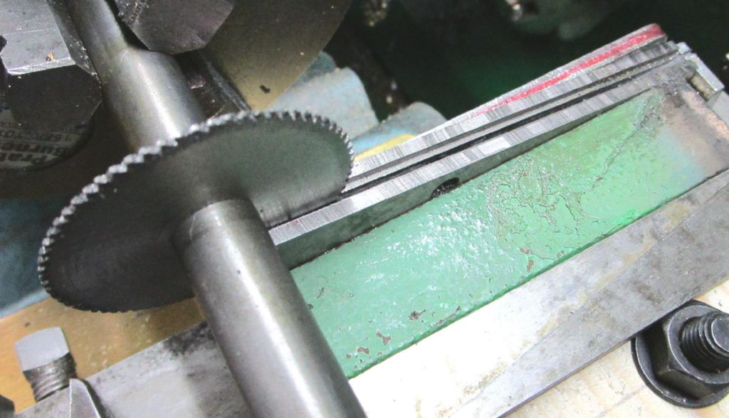

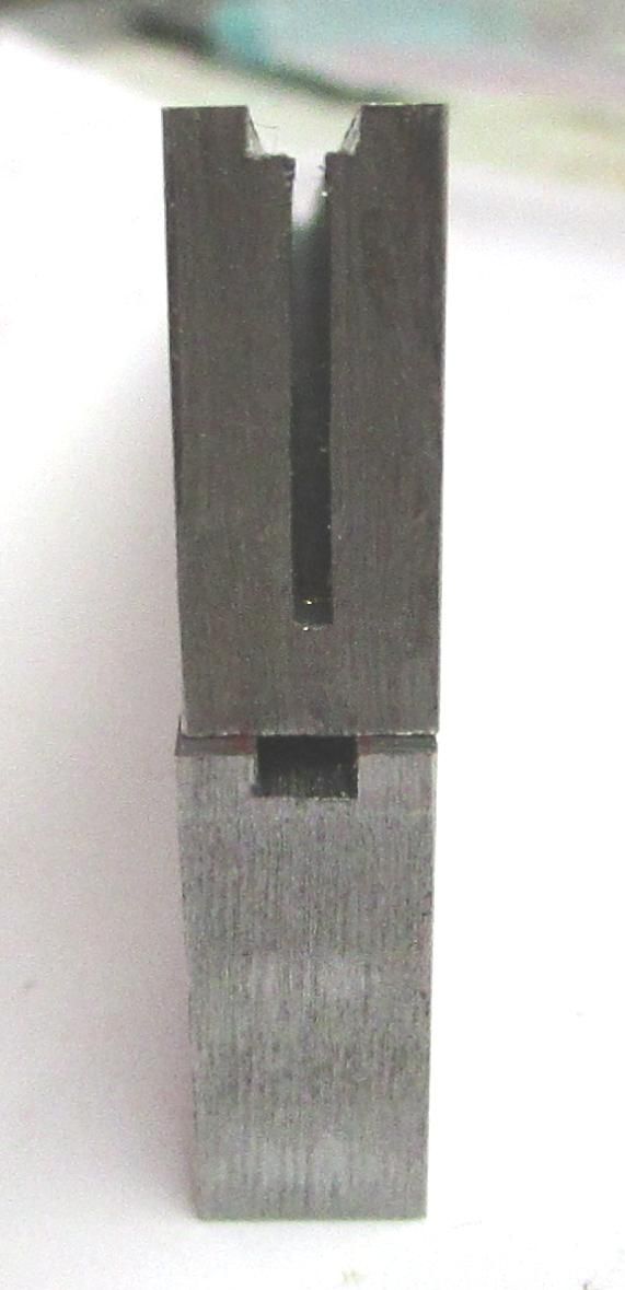

                    I recently cut a tapered slit in a 82 mm long length of gauge plate using a 0.8 mm slitting saw with a 6.35 mm bore for an adjustable parallel I was making.
                    I used a length of 1/2" steel rod to make the mandrel. The thread is M6 with a tiny shoulder that fits into the bore of the blade.
                    The mandrel was held between the lathe three jaw chuck and the tailstock live centre in order to rotate it.
                    I used a simple wooden jig to secure the piece that I was slitting. I used the other tapered parts as a wedge to hold the parallel whilst I slit it. The lathe was run at its slowest speed without using back gear.
                    The cutting lubrication was Trefolex applied using a brush. The hole you can see through the middle is threaded M6, and is used to pull the two sides together in use.
                    Part of the problem with cutting a slit like this is that as the cut progresses the blade pushes the workpiece backwards and then down. As you get to the end of the cut the blade is trying to lift the work.
                    As can be seen it worked quite nicely, even though the blade did start to deflect as it got to the deepest part of the cut.

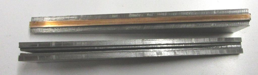

                    The two half's of one parallel showing the brass guide and the slit bottom half.

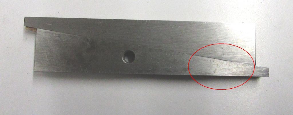

                    One thing that did take me by surprise was that the thin end twisted ever so slightly ! I didn't expect it to stress relief as it did, A little tweak with a mover whilst in a vise helped sort that problem. Both pieces now slide all the way from end to end.
