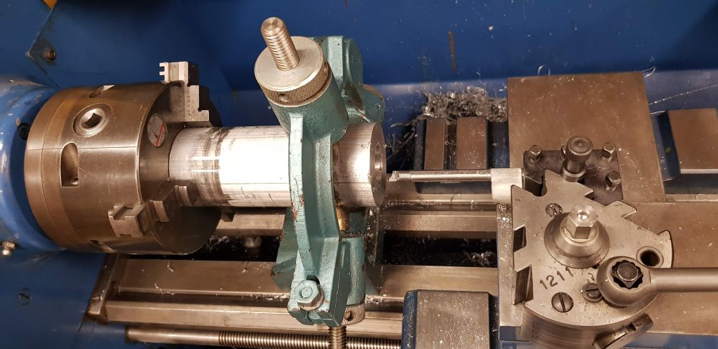

      Returning to a 'filed' project, I'm trying to bore a 60mm long hole in an aluminium bar using my lathe's power carriage feed, but I'm finding it's significantly tapered to the tune of around 0.6mm (in 25mm or so) over the 60mm length of the hole, with the end closest to the chuck being the smallest. The lathe is a Denford Viceroy 250, but I don't think that's particularly relevant for this question.
      As the bar is around 150mm long, I've brought out my fixed steady to help keep things in place (see picture) but I wonder if my lack of experience in using it is causing the taper I'm seeing.
      I've simply used the steady on the outside of the bar (which is perhaps not perfectly round….?) and gone from there – is there a technique/order of setup things up that I should be using in order to ensure everything is lined up properly to give me a non-tapered bore?
      The boring bar is of course sticking out quite a long way, but I'm taking deliberately light cuts and in any case, the deflection forces on the bar should be the same at all points along the cut.
      Thanks,

          Depends how you set the steady up as this can cause a taper. I normally set the job up using the tailstock to centre the job then set the steady up. Try running a clock gauge down the outside to make sure it is running parallel.

              Usually you clamp the steady in position right next to the chuck. Then set the jaws in position. Then slide the steady along to the working position and clamp it down again. This ensures the end of the far end of the bar is held in the correct position and does end up tapered.
              Bar does need to be round and parallel to start with though.

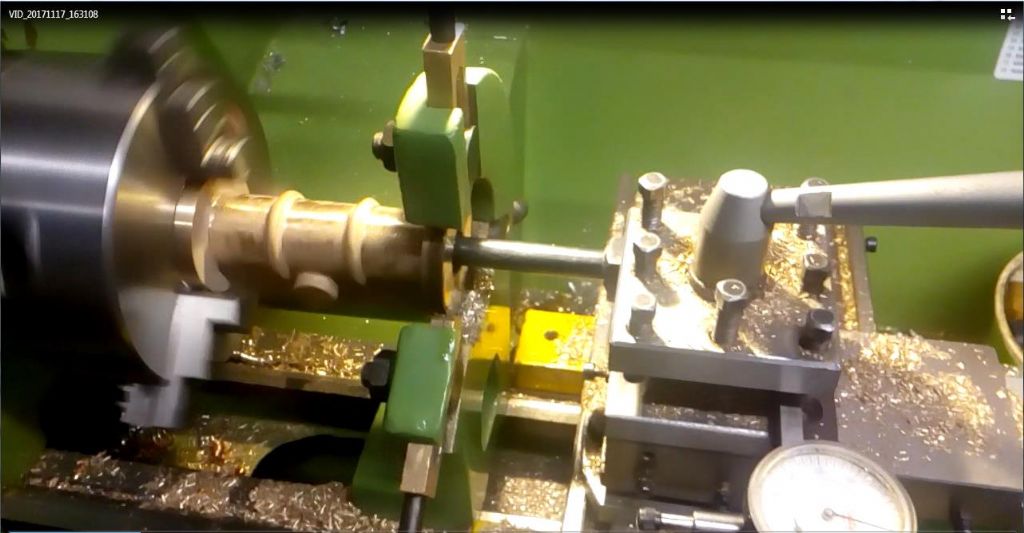

                                      I bored the cylinder casting on one of my engines this way. IIRC I ended up with about 0,02mm taper in a 22,2 dia. x 94 long bore – which was quite good enough to work well.
                                      I could only engage part of the steady with the end flange, to avoid collision with the valve face that you can just see disappearing round the bottom of the casting.
                                      Edited By Mick B1 on 13/04/2020 16:39:11

                                                    So – following the advice, I've turned the OD true with a centre on the end, and found around 0.4mm of out-of-round was present where the steady was set, which is the lion's share of the 0.6mm taper I'm seeing on the bore, and will of course depend on exactly how that interacts with the steady fingers.
                                                    With just that, and some care taken around swarf build up, I've got to <0.2mm taper on the bore, which is good enough for this purpose (It's a model light-saber handle I'm making with my son……).
                                                    Next will be working out how to hold two indicators as suggested by Pete for better setting of the initial and steadied locations of the stock, but I think that will need to be for when I next need to do something like this again – perhaps a new handle design in a couple of weeks…
                                                    On other comments – yes, that's a rather thinner and flexible boring bar than I'd like to use, but is the only one that was both long enough and would actually fit in the largest drilled hole I'm currently tooled up for (25/32" ). For reasons that escape me, I do have a larger bar, but it needs a 1" starter hole…
                                                    Thanks everyone, and many good pieces of advice to get my on the road to nice parallel bores !
