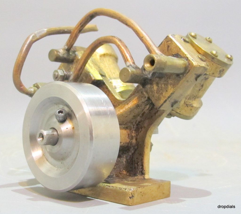

            Thanks Jason – ive not tried running it yet but it struck me that it had been designed to run double acting but then had been plumbed in wrong – please take a look at the photo and you will see what I mean?tff.jpg
            #352247
              That does look like a double. You can just see the tops of the plugs where they cross drilled to join the ports.
              Plumbing looks OK. If we said the open brass union on the right of the photo was the inlet then that is plumbed to the inlet on the left cylinder. The blanked off one on the right cylinder would be the exhaust and is plumbed to the other exhaust hidden behind the flywheel and the taken away by the open ended pipe.

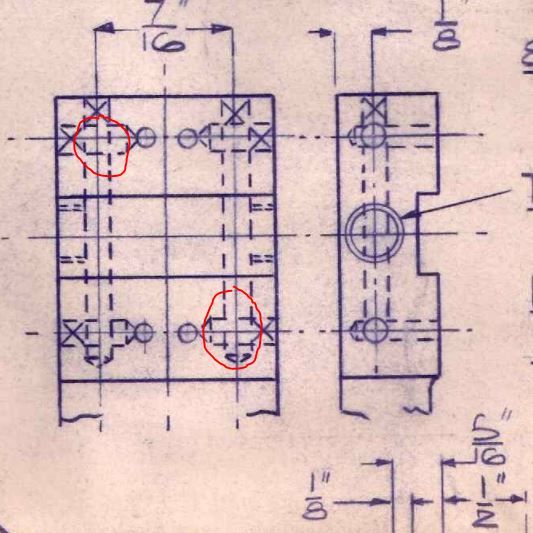

              #352251
                I think that is the Blackgates one you have there.
                If you look at this one the two inlets are plumbed together as are the two exhausts
                Only difference to yours is that uses the holes at the side for inlet and exhaust as per drawings but yours has not had these drilled but instead has a hole from the back of the port face into each of the long linking cross drillings.

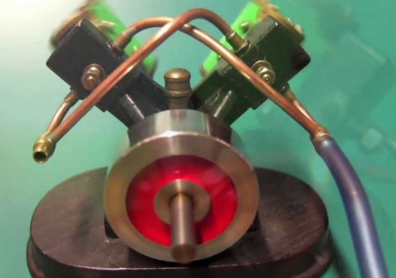

                If you want to get really fancy then the pipes can be taken into a manifold and a switchover valve built so you can change direction by feeding steam into the exhaust and out the inlet which is handy if used in a boat. As this very nice restoration by Ramon shows

                  Thanks JB – good news indeed. Its a bit rough so I will strip and machine if needed. Any idea where I can get a drawing of the reversing block?
                  #352340
                    You could message Ramon on her, he does not post that much but should get the message notification, more of that engine in this thread
