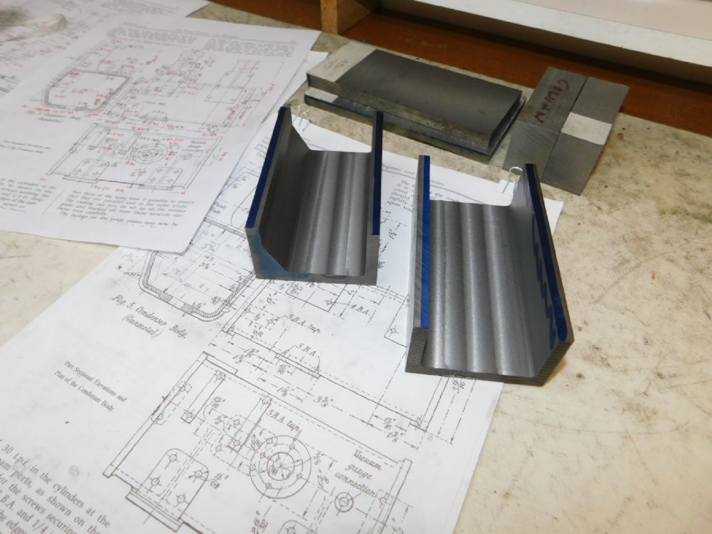

                          Sorry, but I'm afraid I can't quite understand why using a simple basic hand held calulator is so challenging – I really have been doing this for years
                          For example
                          'one' divide by 'sixty four' tapped in = .0156 and mutiplied by 25.4 = 0.396mm if you prefer to work in metric
                          First three digits are usually good enough but if 15 thou isn't you can go the extra 6 tenths or, call it 16 thou and make it 4 tenths oversize!
                          I always find going through a drawing that is fractionally dimensioned to convert them an opportunity to see how the drawings fair dimensionally and potentially spot any errors.
                          The (currently in abeyance) marine engine drawings were all fractions – After deciding to undertake it at 5/8ths scale of the original size I spent a few pleasurable hours converting the fractions to metric dimensions – dim x .625 x 25.4 – all the red ink annotation. The drawing in the forground is a secodary copy with just penciled dims added as machining took place. Don't suppose the major parts drawings took more than 3-4 hours in total broken down into several short sessions. The final, actual, dimension was worked to and not rounded up or down – that way the design is not changed.
                          CAD is no different just the need to draw or re-draw it adds more time.

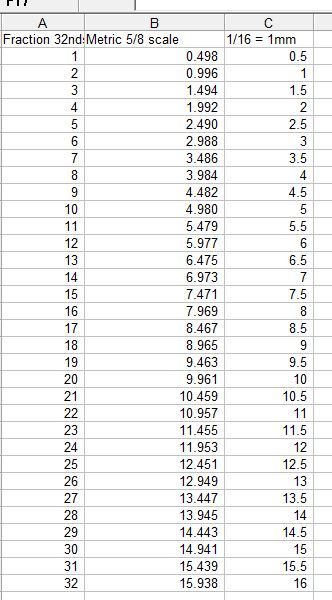

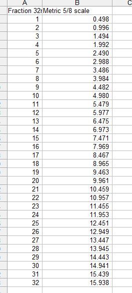

                              #558488
                                But how many times do you have to tap in those 5 digits or 9 if adding in the scaling factor?
                                Do it once on a spread sheet and also include the 5/8th scaling factor and you get a sheet like this so simply look at it to see what say 17/32" comes out as in metric at 5/8ths original size.
                                Though for that particular job I would actually use 16th = 1mm  or 1/32 = 0.5mm and then you can do it all in your head and get round metric sizes
                                Edited By JasonB on 16/08/2021 14:52:39

                                    Bad memory, finger trouble, distractions and error checking.
                                    Spreadsheet is my preferred method. The numbers are typed in, remembered, and can be printed if required. The calculation is applied once to the whole column, and the result posted next to it. If necessary a third column can convert to millimetres or inches, and a fourth used to back convert to the original as a cross-check. Best of all, three weeks later, when a mistake is suspected, it's all there ready to be diagnosed. Good for up to about a thousand entries, beyond that consider a database, but I rarely tackle big projects.
                                    Many CAD packages support spreadsheets too, which saves a lot of time when a drawing error affects several dimensions.
                                    End of the day though, whatever technique best solves the individual problem. No point wheeling out a computer for a few conversions. Pre-tabulated answers save typing, but look-up errors are more likely, and it's down to the operator to manage them. Calculators suffer finger trouble and have no memory. Redrawing is most time-consuming except I find it helps me understand the design and the conversions are almost a side benefit. Slide rules and Nomographs are remarkably effective – faster than pre-tabulated, but less accurate.

                                      #558499
                                        Posted by Ramon Wilson on 16/08/2021 15:31:47:
                                        Well each to his own of course, but having done it for so long it simply doesn't seem an issue to me. And, as said. it gives you the opportunity to 'read' the drawings for mistakes beforehand – and we've all heard about drawing 'mistakes' before haven't we. Charts and spread sheets are of little help there I'm afraid especially after the part has been machined.
                                        The chart can be used to get the numbers to write in red, I see no difference in using a chart or calculator to arrive at the figures to put on a print of the drawing so no difference in the ability to check for errors.
                                        I would usually use one like that example of mine so that I can enter the correctly converted and scaled metric size straight into my CAD model as I redraw the whole thing from the old imperial drawing. I can then do far better checks on the CAD as the assembled engine can be turned over and I can see if things like the conrod or piston hits, that the valve moves correctly and so on. Also a function that will highlight any clashes eg where a shaft is assembled going through too tight a hole.
                                        Another variation is that if working from say an old general arrangement that has been copied a number of times you can find that they get distorted so in a case like that I may have too columns one for what is scaled off the image horizontally and another for what is scaled off vertically.
                                        That's why I personally would choose to possibly use a spreadsheet or chart over repeated punching in of numbers on the calculator. I am not trying to change anybodys ways but simply answer the "why would anyone"
                                        I'm still likely to reach for the calculator in the workshop if I need to convert to decimal or from metric to decimal inches to suit the lathe handwheelssmiley

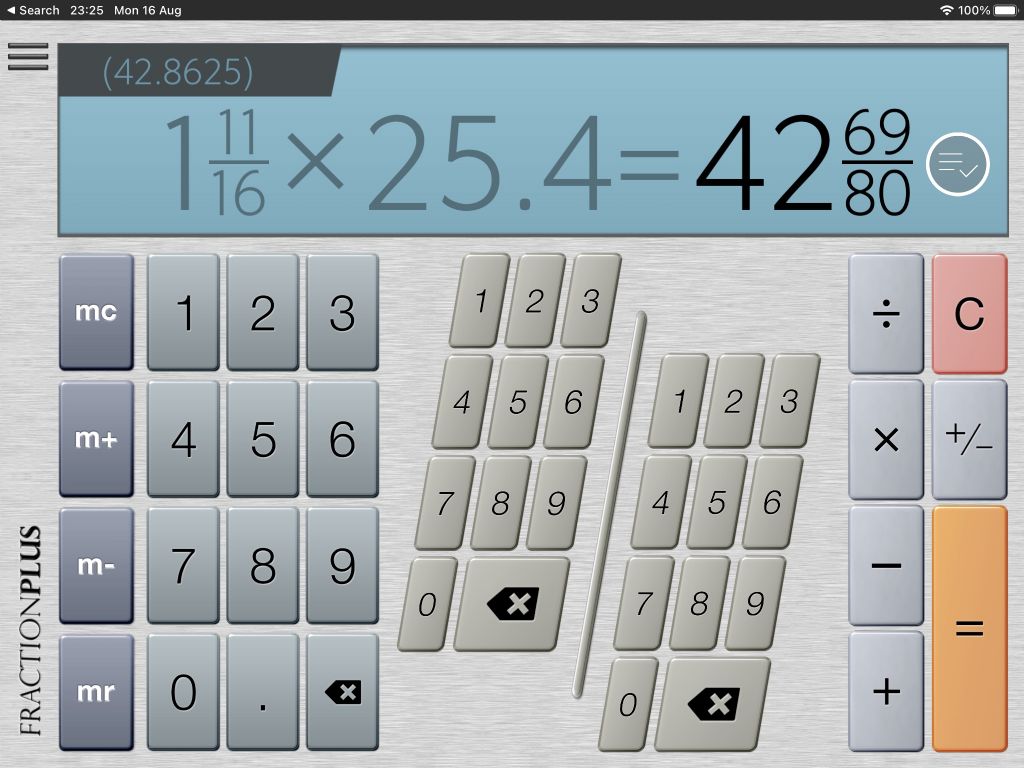

                                                    I’m not taking sides… each to his own
                                                    But if anyone fancies a fractional calculator for iOS, this one is rather good:
                                                    Edit: big caveat _ The current pricing looks very greedy … I didn’t pay anything like that
                                                    Edited By Michael Gilligan on 16/08/2021 23:54:59
