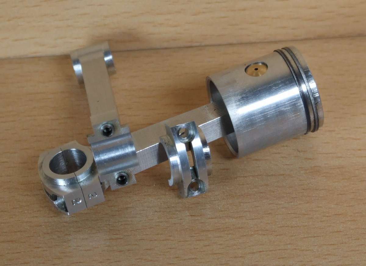

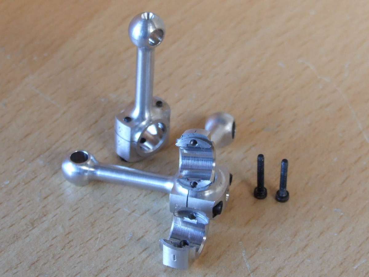

                I built the Odds N Ends engine, by Philip Duclos. Although Aluminium was specified for the Con-rod, I used Brass for this particular engine. As I wanted to run it on diesel. Normally I use Aluminium and have had no problems. I think from memory his Odd Ball also uses Aluminium.
                Fig 3
                These are Con-rods from the ETW Seagull engine.
                Fig 6 Con-rods, gap between Big-end cap & Con-rod is intentional
                These are the rods form a version of his Gemini High Speed Steam engines.

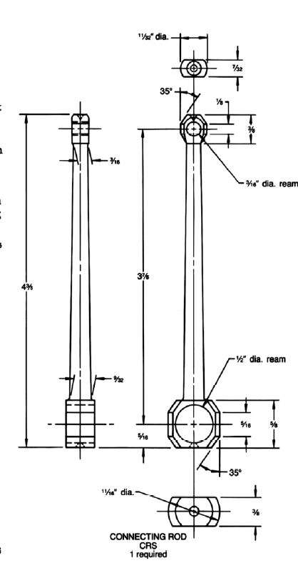

                  CRS on the oddball drawings. Quite a long slender one at about 4″ and 3/16″ dia at the small end.

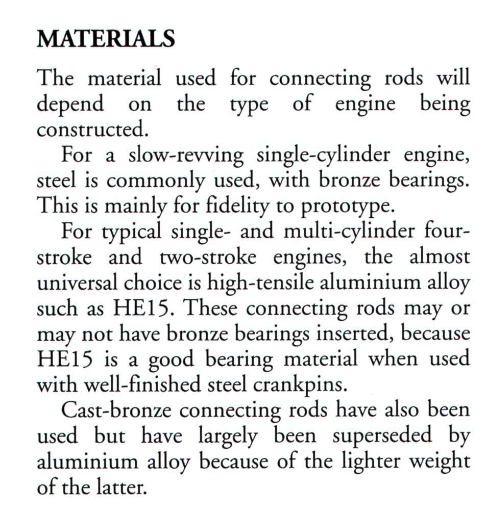

                          Some while ago, I purchased a book called “Miniature Internal Combustion Engines” by Malcolm Stride*.  From within its pages, I have scanned the following regarding the choice of materials for the con rods as you specified it was an IC engine that you were proposing to construct:
                          Con rod materials001
                          Further on in the chapter, he describes the machining processes required, and the order of operations.  There are separate chapters covering the choice of materials for the various parts of an engine, and I thoroughly enjoyed reading it.  I would recommend it for anyone with an interest in I.C. for an Xmas present, particularly for early learning on the subject.
