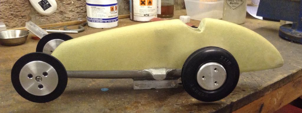

                              Old School
                                @oldschool
                                This car body was made using a blue foam plug you simply shape the foam to make a plug to build the body onto no need to worry about draft angles or getting the plug out of the finished body.
                                Now cover the plug with glass cloth I use a lightweight cloth around 28g square metre build up a few layers at a time allow to cure rub down till smooth more layers of glass repeat until get to the thickness you want. I use epoxy resin.
                                Then cut out the foam and melt out the rest with solvent it's quick and easy for complex shapes.
                                Edited By Old School on 19/09/2019 20:14:46
