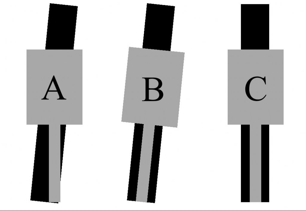

                          It seems to me that your problem is illustrated in diagram A below. Your DTI method will align the spindle with the column, as in B. Then, by normal the tramming method, you will tilt the column until the spindle is vertical, as in C.
                          Not knowing the mill, I don't know how you will tilt the column, but the method is sound.
                          tramcol.jpgGary

                            However; if I understood your original post correctly; the column on your machine is not accurately perpendicular to the table … It is evidently not a "tilting column" so it's an assembly error.
                            The good news is that once you've got it set right you won't be moving it.

                                  The column does not tilt to that degree, sorry for the misleading description, it is bolted straight to the back of the base without any locating pins etc, so the user can adjust the alignment – I will use Ed's method to get me going, and if I see a 2 Morse test bar come up cheap I'll grab one and test my theory while hopefully checking how well Ed's method aligned the column and table – I will use Loctite between the column and base to give me less chance of it slipping.
