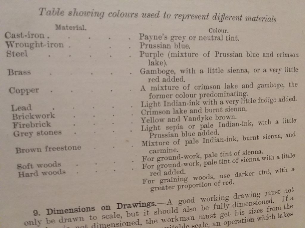

                There were standards, or at least conventions, for colouring representing different materials and the drawing's annotations.
                It must have been fairly expensive so probably limited to the drawings used to impress potential customers in winning and negotiating contracts.
                A bit like the "Artists' Impressions" issued by property-speculators today… but to a far higher standard not only of accuracy, but also of detail, context and honesty!
                They are:
                Wrought-iron and dimension-lines —– Prussian Blue
                Cast iron —— Payne's Grey
                Centre & Datum Lines —— Crimson Lake
                Brass & Gunmetal —— Gamboge or Indian Yellow [no mention of Copper]
                Stone Yellow —— Ochre
                Wood Burnt  —— Sienna
                Leather —— Sepia
                Brickwork ——- Light Red
                Lead —— Indigo Lead*
                Packing —–  Burnt Umber [I think as in piston-rod and valve seals, not spacers or shims.]
                Water  —— French Ultramarine
                Steel  —— Prussian Blue and Crimson Lake.
                *[sic – I wonder if that's a typesetting error. The original list is the other way round, colours first.]
                For obliterating an ink line or giving a light edge to a drawing, we are recommended to use Permanent Chinese White; while Prepared Ox Gall added to the coloured inks will help their application to slightly greasy tracing-paper or linen.
                So sayeth:
                Henry J. Spooner, C.E., Machine Design, Construction and Drawing, Longmans' Green & Co., London, 1913. pp80-81.
                So now you've no excuse not to get it right, but these preparations are not cheap at one shilling for the cheapest in whole cakes or pans. Still, it's for the Counting-house to spread the cost in overheads around the invoices to the customer!
                I am pretty sure these colours are still readily available under those names, from artists' requisites stockists. They do not include modern materials like aluminium and of course plastics, but I suppose you could devise your own, with a key at the foot of the drawing. I'd suggest Battleship Grey for al. alloys, for example.
                But I will growl if you represent Granite by Black or Very Dark Grey; or call stone of those colours, "Granite"!

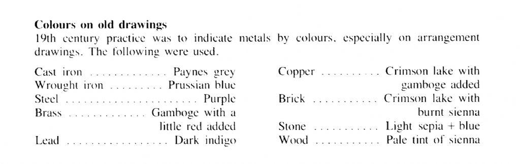

                          Tubal Cain (T D Walshaw) lists nine colours for different metals/materials on P168 of my copy of the Model Engineer's handbook. (seventh impression 1991)
                          Will try to get an image online.
                          Cheers

                            Another nugget … Thanks Dave
                            Edit: __ I’ve found it … thanks again

                              I have just found [and downloaded] the excellent book from which that page originates:
                              **LINK**
                              https://archive.org/details/practicaldraught1896arme/page/114/mode/1up

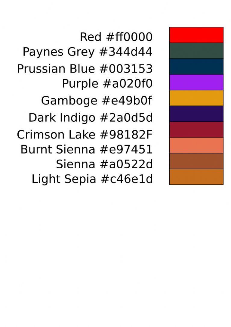

                                          A chart showing what the base colours look like and their hex values, but beware! They won't be visually correct unless the viewer's display device is colour calibrated.
                                          The colour chart above presents slightly differently on the two screens I use for CAD.
                                          Another misleading factor is the colours are all fully saturated, which is rarely the case on drawings I've seen. Seems more usual for drawings to be coloured with a light wash rather than blocked out garishly.
                                          Colour coding is frowned upon in my Technical Drawing Books.
                                          • Not a good way of identifying materials . From the mid-19th century materials came in ever increasing variety so, apart from in Arrangement Drawings, it was necessary to specify which one by writing it down.
                                          • The human eye is not good at identifying shades of colour, and shades vary with lighting, age, and type of paper. The method is unreliable.
                                          • It's expensive!!!
                                          • Early copy processes, like Blueprints, were saturated monochome and demanded starkly contrasted drawings, typically black ink on white paper. They could do hatching, but not fields of colour.
                                          Always dangerous to generalise, but the main use of colour is Arrangement Drawings and for Public Relations. In arrangements, colour is as likely to identify features as materials – ship plans are often tinted to highlight things like machinery spaces.
                                          I'm against colour as a way of identifying materials in drawings. Mostly…
