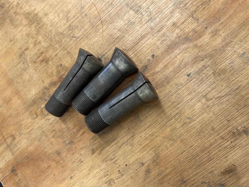

      Calling all collet experts!
      I have 3 collets which are no good to me so I wish to sell them on to someone who can use them. I have never come across this size and wondered if any of you guys or girls have.
      The dimensions are:
      Length 2.185
      Thread .640 x 24tpi
      Keyway width .100

          #650988
          Baz
            @baz89810
            Plenty of charts on internet detailing sizes of 5C style collets, they will help you figure out exactly what you have.
            #651446
            Dell
              @dell
              That sounds like 3AT to me do a search for that.
