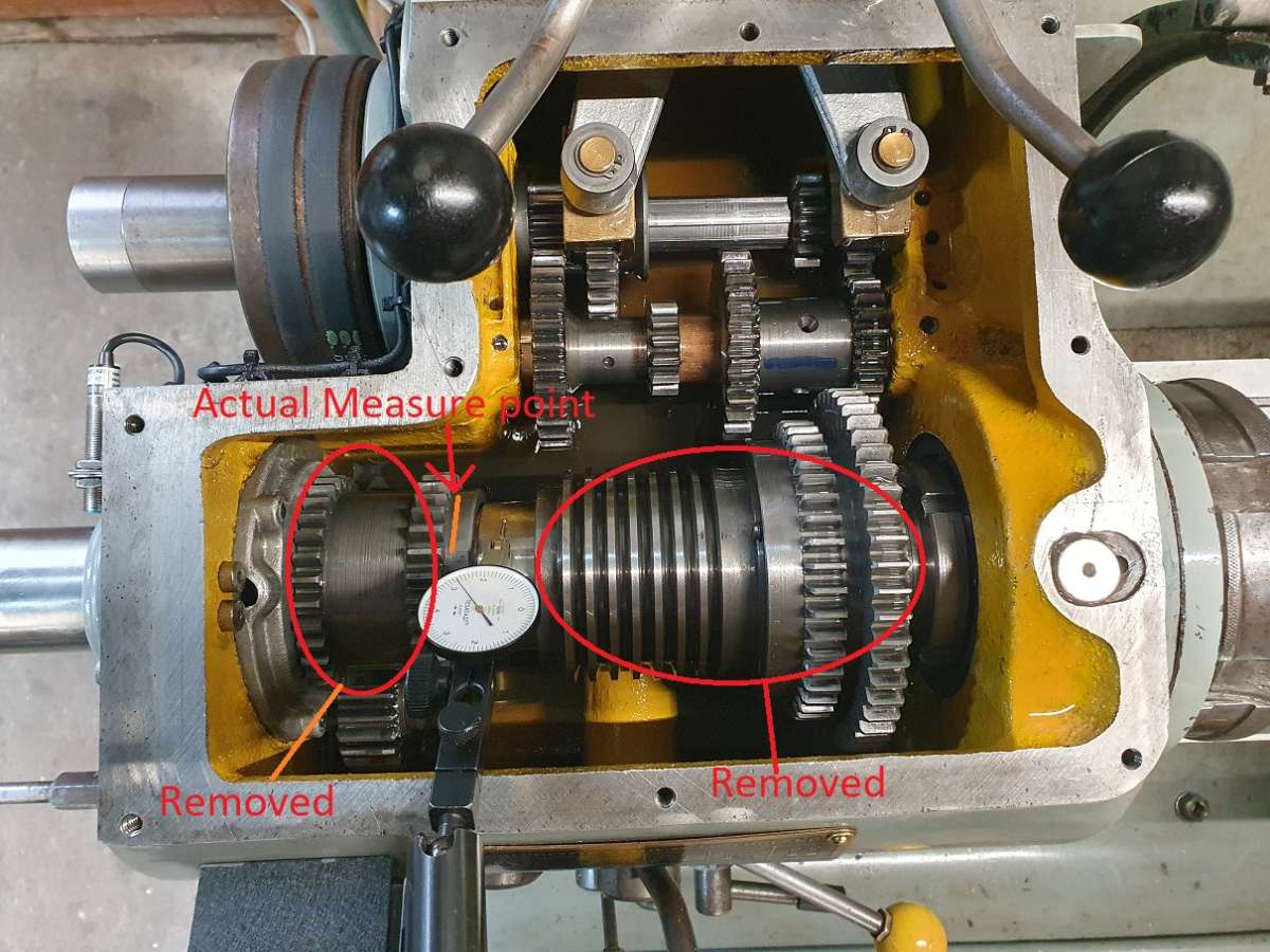

      So off with the lid and measured where I could between the sliding gear and the gearbox output gear at the rear. I was getting almost a thou of swing on the gauge.
      When I first got the lathe and refurbished it, knowing the type of bearings they use – i.e. ludicrously expensive and no need for Gamet Super Precision unobtainiums, I did mark the position of the bearing cones on the spindle with a sharpie and that’s where they went back on. Never been a problem.
      Thinking the spindle must be bent (lord knows how you could bend a spindle like that and I haven’t crashed it.. yet)I removed the spindle, stripped it and spun it using it’s bearing surfaces in some blocks – The only thing I could measure with a tenths indicator were scratches in the surface. No run out anywhere, on any surface or the front bearing mating face.
      What I did notice was that the alignment marks of the bearing cones were not in line with what appeared to be a reference mark on the spindle nose front bearing mounting face (a small CLC 46 in a circle with a small X next to it). No bother I thought, it runs true.
      So I reassembled the front bearing on the spindle in the same orientation as it was and adjusted it for preload. This however wasn’t easy, it was either on or off, no gradual build up as expected (see further down..). Reinserted the bare spindle into the head stock with only the front bearing cap plate bolted up to hold the bearing correctly.

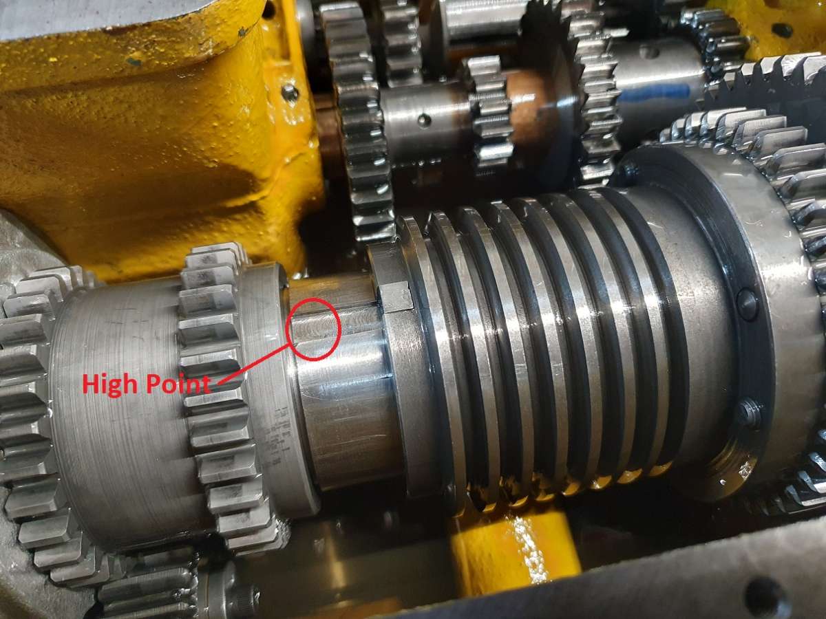

      Put the indicator on it towards the rear – see pic below – .. 4 1/2 thou of throw! So I added the rear bearing and adjusted that up and the throw came back to the original just less than 1 thou.
      Lathe_Spindle_1
      The high point was right where the keyway is for the sliding gear –
      Lathe_Spindle_2
      So I removed the spindle, removed the bearing and re orientated the bearing cones in line with the mark mentioned above. Re inserted and measured – 2 1/2 thou.. better.. and the high point is still exactly the same place.

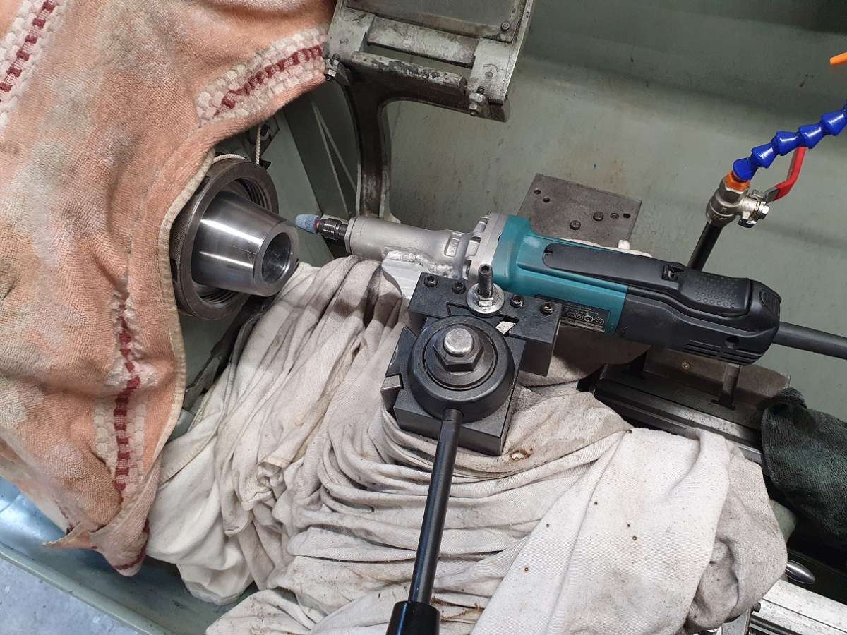

                  Checked the spindle nose for run out as that was now out due to the rest being changed.. not bad, about 1 1/5 thou total.. out with my bodged tool post grinder, it actually works really well..
                  Tool_Post_Grinder_3
                  Terrible looking weld on the die grinder, had a mandrill inside it to try and keep it straight and was trying to blob it on so as not to heat the thing too much and prevent it distorting.. it worked.
                  Dressed the spindle nose and then the internal nose taper.. ended up with a really good finish after a bit of faffing.. spindle speed etc so even happier.
                  Moment of truth – fit the face plate as that, although old looks virtually brand new with not single ding in the mounting surfaces. I thought I best blue it up first just in case to show where was good or not so..
                  Just by pushing it on before I’d even nipped up the collar it was solid on the taper.. gave it a light nip with the collar and had to use the spanner on the collar undoing it to get it to pop off! perfect blue transfer as well..
                  I suppose you have to get lucky once in a while. The spindle bore taper wasn’t so lucky, I had to re dress that after a coupe of taps on the compound before the bore adapter was a proper fit but no drama’s.
