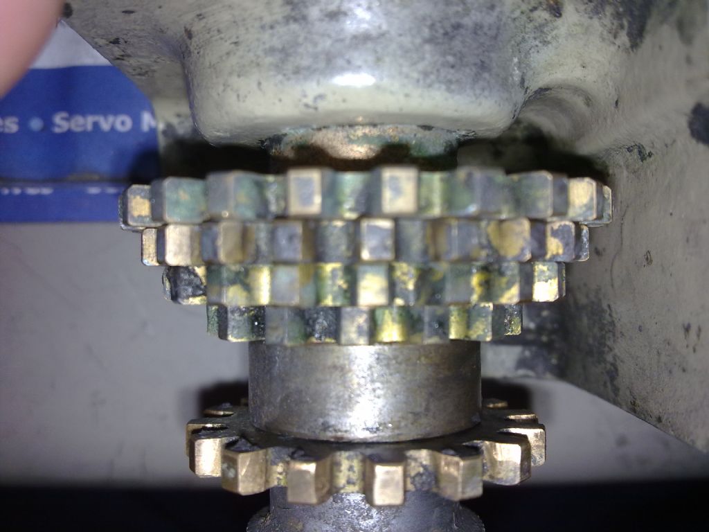

              I don't think they are that sophisticated, from memory of stripping the TDI down to un-sieze it on the Harrison M330 at work – I think they are straight cut from thin plate. I can drop them off tomorrow to measure up / photograph if that would help ?

                    Somewhat blurry picture of the M330TDI – pretty certain these are straight cut. The bottom (engaged) gear shows wear due to the thread helix angle. The M330 is close to the M300 – vari-speed headstock rather than step gears – the apron appears to be the same as the M300 at my last employment. The gears are 3.2mm thick.
                    Nigel B

                            Posted by mgnbuk on 06/06/2018 08:56:44:
                            They are helical albeit very slight.
                            Nigel B
                            Thanks all for the replies
                            Great picture Nigel
                            I have some 4mm brass sheet so will go with making some. At least the dividing head will get some use on the little mill.

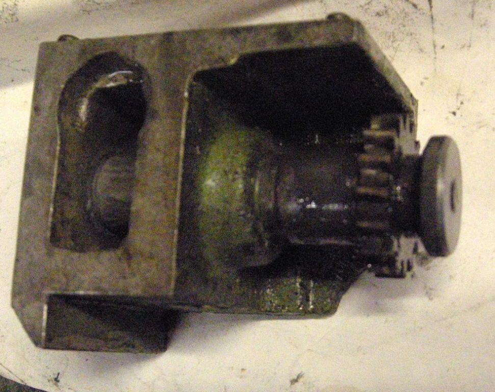

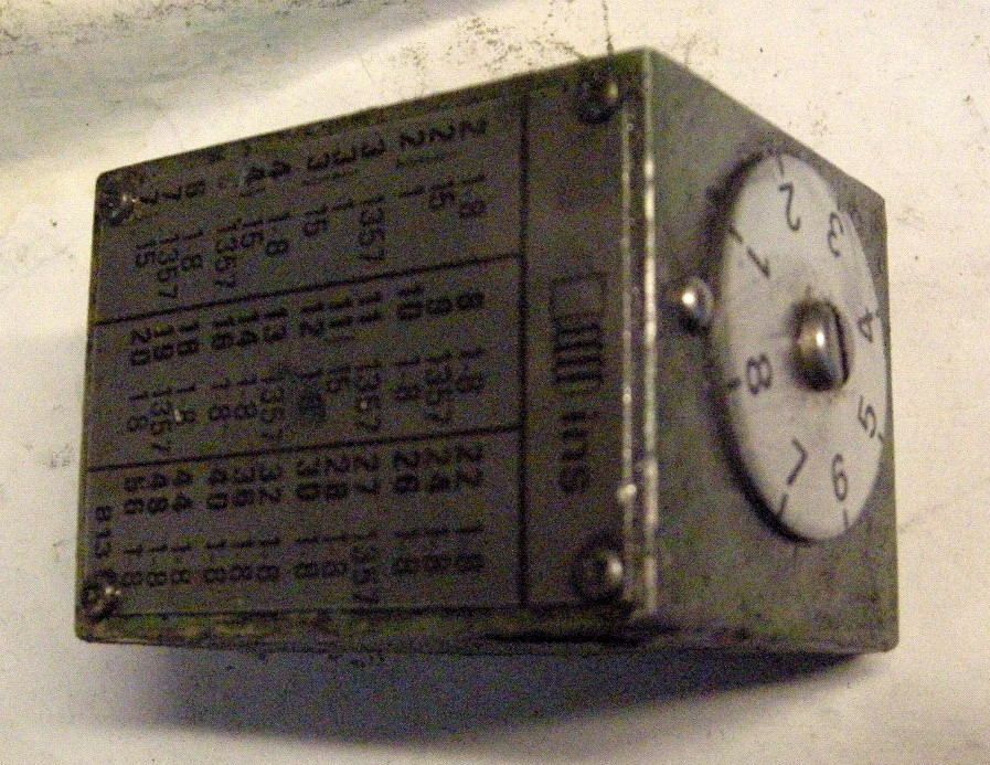

                              This is the Thread Dial Indicator off mine.
                              1 off 16 tooth slightly helical.
                              Works for Metric and imperial i change nothing.

                                Cheers Jon. The imperial dial only has one change gear as far as I’m aware.

                                  Thats what i have just figured out.
                                  Mines an ex GKN painted horrible green, dont care its a tool. Its an early one 70's lead screw may be imperial never bothered to check since it good for metric and imperial with no faffing about with change wheels, literally dial any pitch in via 4 knobs nothing more to it.
                                  I do have to power out on metric to retain the meshing unlike my old 60's Harrison 140 could disconnect feed and wind back then engage for metric only.
                                  I'll have another check tomorrow got to do a 19TPI my mate cant on a Harrison 11" and asian Colchester copy.
