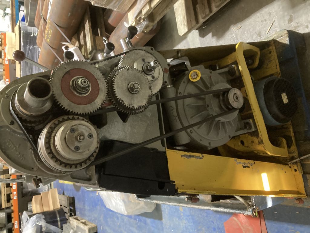

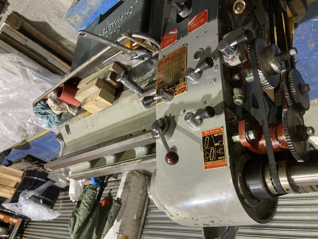

                              Hi
                              well, I’ve got the tail stock, Chuck, main cover, lead screw and saddle off.
                              im a bit stuck as to how to attack the head stock, and how the belts come off.
                              atb
                              jay
                              #533610
                              jason evans
                                @jasonevans10206
                                a4fb21a2-e6a8-43ad-97cf-73037953e07c.jpegffa333bf-0203-4333-9fb3-71d9d362353c.jpeg68e8cbd3-894f-495f-92de-5952ea568903.jpeg
                                #533617
                                DC31k
                                  @dc31k
                                  Undo bolts holding yellow frame to cabinet. Lift motor/variator/frame to create slack in vee-belts. Alternatively, undo variator bolts and lift it slightly.
                                  Slowly rotate thin timing belt, pulling gently towards you. It will work its way off the lower pulley.
                                  No need to touch short, wide timing belt to remove headstock

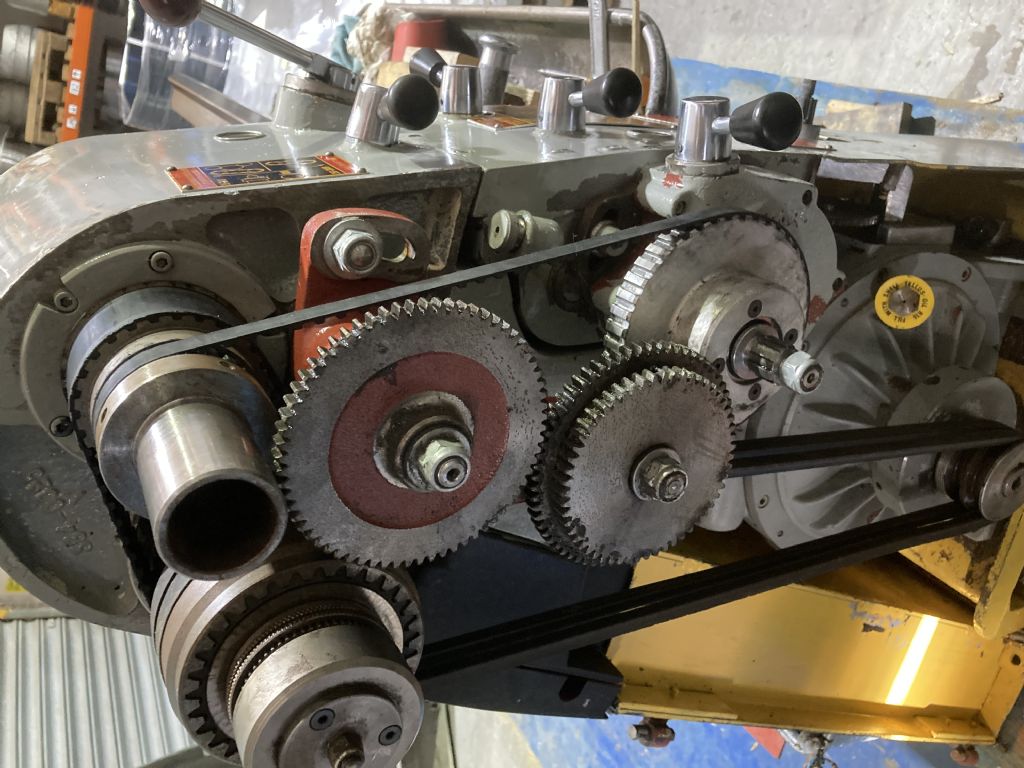

                                  #533627
                                  jason evans
                                    @jasonevans10206
                                    Thanks, that makes sense. I’m a bit baffled by the 2 centre gears at the back, these just free spin. Am I missing a gear on the bottom right spline which these link to? The ones on the swing frame.
                                    atb
                                    jay
                                    Edited By jason evans on 13/03/2021 15:17:45
                                    #533635
                                    DC31k
                                      @dc31k
                                      Posted by jason evans on 13/03/2021 15:13:30:
                                      Yes. Look in the cabinet or contact the seller.
                                      Standard imperial Chipmaster has a 66t gear, a 33t gear and a 55/65t double gear (used for metric translation). The 33t is not there.
                                      I was under the impression you had a manual. A thorough perusal of the exploded diagrams would tell you what parts are supposed to be present.
                                      #533640
                                      jason evans

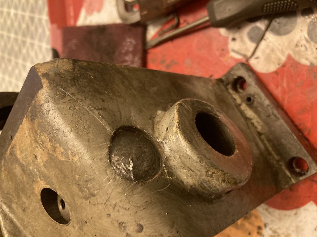

                                          #534161
                                          DC31k
                                            @dc31k
                                            Has the gear you have found come directly off another Chipmaster? Or is it a generic 33t change gear? I hope it is the former.
                                            When you are talking of the power feed box, are you still speaking of the apron assembly?
                                            There is a slightly domed steel blanking plug on the headstock end of the apron, near to the half nut lever that needs to be removed. It is a little bit like a core plug in a car engine block. Behind it is the interlock rod that stops you engaging power feed and half nuts at the same time.
                                            Once more, a close study of the exploded diagram in the manual will assist you in your work.
                                            #534163
                                            jason evans
                                              @jasonevans10206
                                              Hi
                                              yes it is a 33t off a Chipmaster. And yes the feed box with lever on the apron.
                                              well I’ve looked at the apron diagram and can not see any plug, is it removable or does it need drilling out
                                              atb
                                              jay
                                              #534191
                                              DC31k
                                                @dc31k
                                                It should not need drilling. Remove all paint covering and surrounding it and at about 5 o'clock looking towards the tailstock, it should be possible to tap in an old wood chisel and ease it out.
                                                You are right that it is not shown in the manual. In the early manual diagram (BAN/9/64) the hole is shown but no plug. In the later manual diagram (CHIP-11-70) even the hole is missing. It is also missing in the Harrison 10AA manual.
                                                #534255
                                                jason evans
                                                  @jasonevans10206
                                                  I’m presuming this is it, bugger is tight in there17a7344d-8ecd-4a98-a610-acaac10c89c0.jpeg
                                                  #534259
                                                  DC31k
                                                    @dc31k
                                                    That's it. The way your photo is rotated, you need to attack it at about 7:30 (am or pm does not matter).
                                                    #534260
                                                    jason evans
                                                      @jasonevans10206
                                                      Posted by DC31k on 16/03/2021 19:11:10:
                                                      Cheers will wait 5 mins then go for it lol
                                                    Viewing 25 posts - 1 through 25 (of 29 total)
