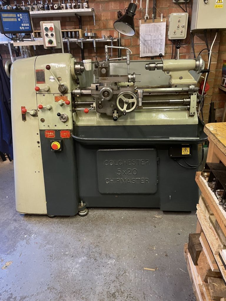

      Hi all does anyone on this forum have
      a Chipmaster please reply
      thanks
      steve

          Milly S
            @millys
            Hi ady I posted a picture a few days back got no reply
            so I thought I would try again this time just asking
            for Chipmaster owners in the photo I posted it
            showed 2 holes 1 in headstock & 1 just behind chuck
            These were in the machine when I bought it a
            couple of month back I was wondering if they had a specific use
            or if someone had tried to add something they both
            have grub screws in just wondering if any other
            chipmastes have these holes in as this is the 1st
            time I’ve bought a Chipmaster
            thanks for replying
            regards
            steve

                I have looked at the headstock drawing and it shows the hole in the headstock fitted with two grub screws for retaining the headstock oil channel. The other hole seems to show an oil nipple fitted, presumably for lubrication.

                  Hi daggers thanks for info on headstock
                  the hole in the headstock has got 2 grub screws
                  in the same hole
                  Does It show where these should be placed
                  in relation to each other
                  thanks
                  steve

                      Steve,
                      it does not show fitting.
                      My guess is that the first grub screw is used to tighten on to the oil gallery, this looks like a tube with a number of cut outs. And when this tube is locked the second grub screw is run down to the first grub screw to lock it in position, just as you would use a lock nut.

                        Posted by Daggers on 28/09/2023 09:12:45:
                        You are right about it being the "other hole" because the one to which you refer is in an-other part altogether.
                        The oil nipple is in the clutch housing. The grub screw to which the OP refers is in the front spindle bearing cover.
                        In a later manual (from SER 3311, diagrams CHIP-01-70 and CHIP-02-70) the longer grub screw goes into the headstock casting first. The shorter one on top of it is presumably to act as a lock bolt so the one below does not back out due to vibration.
                        The front bearing cover in the manual shows no grubscrew, but the item 1146, labelled 'peg' looks too coincidently to be in the same general location as the grubscrew for them not to be related.
                        In every Chipmaster I have seen, in both locations, the factory paint has been applied over the grubscrews.
