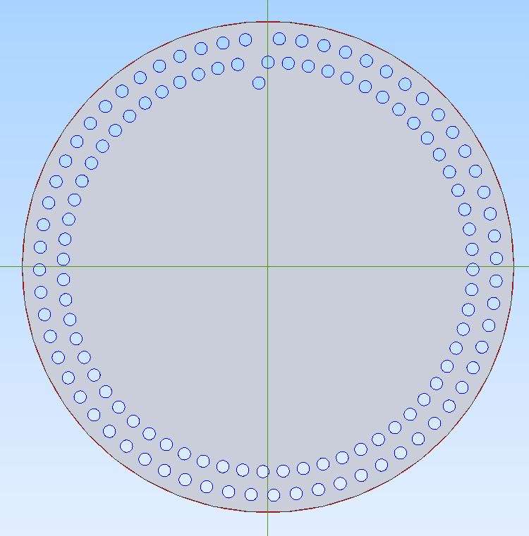

      Does anyone have a method for calculating co-ordinate positioning for a ring of holes that are not all equally spaced.
      There are a number of PCD calculators out there, however these all assume that the number of holes are all equally spaced.
      My requirement is for the 99% of the holes to be equally spaced, but the gap between the first and last may not be the same as for the rest.
      A couple of examples:
      Screenshot 2024-11-22 at 10.38.49Screenshot 2024-11-22 at 10.39.01

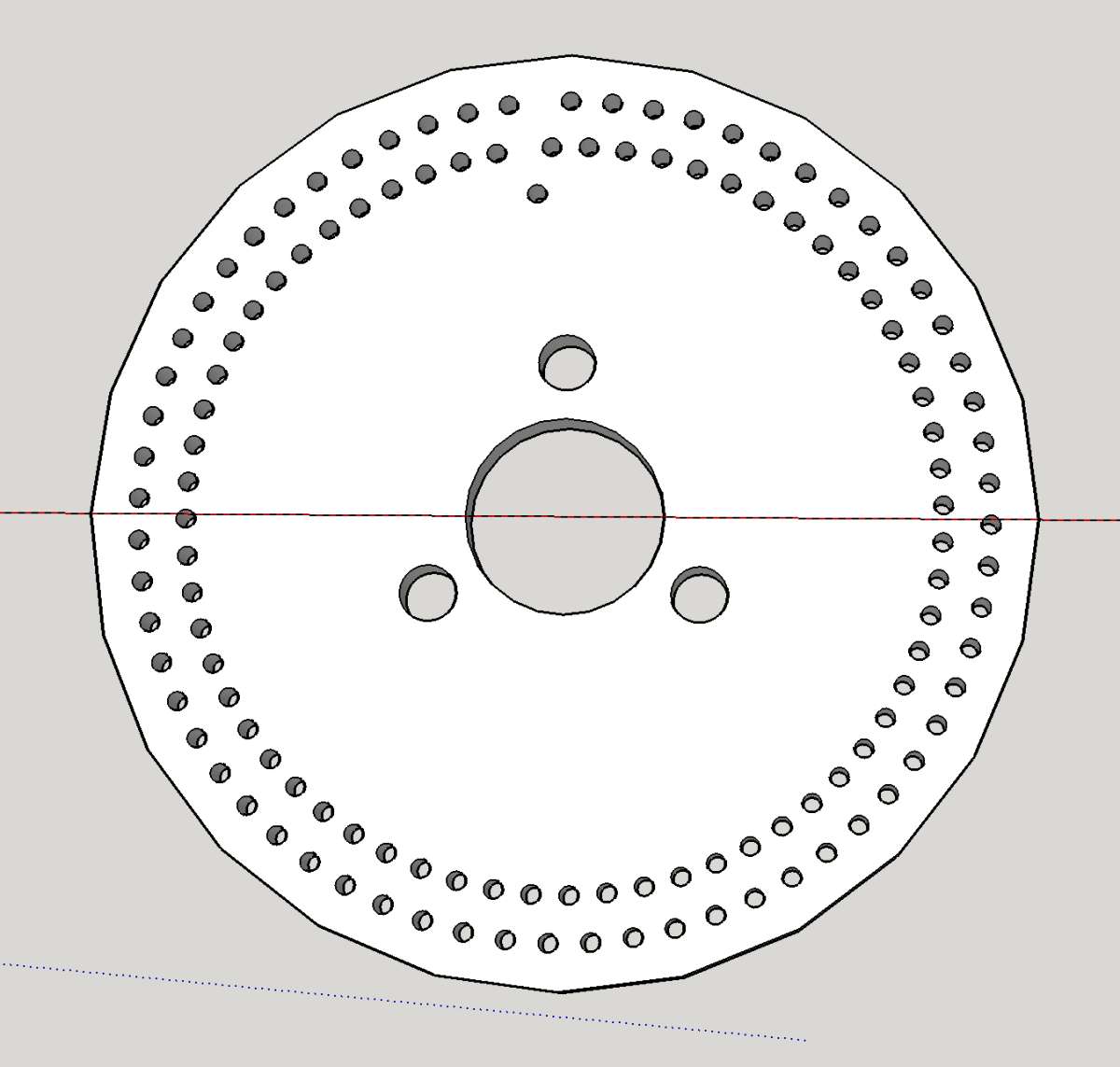

      Both are variations on plates that can be used on a Spin Indexer to generate a 127 tooth gear, the first has 127 holes on 3 different pitch circles (OxTools variant), the second uses a 5 hole vernier to achieve the same result with 26 holes (RJSakowski on the Hobby-Machinist forum).
      The OxTool one actually does fit a PCD if it is large enough, but the reduced version has every second hole moved to a second pitch circle and the last one to a third.
      The gap between the first and last hole, on a given pitch circle, is different for both of these compared to all the other holes.
      The 5 hole vernier for the second variant may have the same issue as again a full circle of holes may not have the first and last equally spaced.
      I guess I could calculate them all in a spreadsheet using trigonometry, I just need to get my head around the associated maths.

        If you have the 3D CAD, just produce a 2D drawing from that and dimension the holes as needed. I would suggest X and Y from the middle.

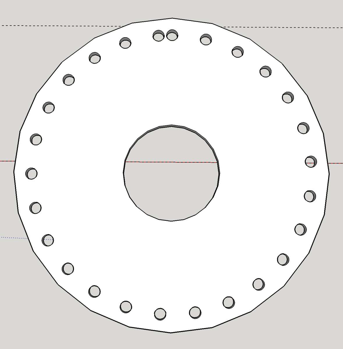

          Many thanks Jason, that is of course a viable option and one I had only vaguely considered.
          I created the above in SketchUp, but could probably create in Fusion360 just as easily, which would be more suited to creating the 2D ‘dimensionable’ version.

            As Fusion is the offspring of AutoCAD, ACAD has a ‘list’ command, that you could select entities and it would write their properties into the text window.
            Put a point entity at the centre of each hole, select all of them and ‘list’ to the console.
            A variation on this is to save just the point entities into an ASCII dxf file and open that in a text editor to extract the information.
            The utility of the textual information might be dependent on the order in which you create the points. they would list in creation order, so create them systematically and they will list systematically.
            If you tell us PCD, first hole bearing from due north and angular increment, we could do the maths independently as a check on your own work.
            The easiest way to obtain these in a spreadsheet is to use polar coordinates. x = r cos(theta) and y = r sin(theta). The angle is measured anticlockwise from the horizontal positive x-axis (mathematical and navigational angles are measured in different directions). For the Ox one, with two hole circles, the outer thetas would be 0, 2/127 * 360, 4/127 *360, 6/127 * 360 etc. The first hole on that outer circle would be at three o’clock. For the first hole on the inner circle, start at 1/127 * 360 and then 3/127 * 360, 5/127 * 360 etc.

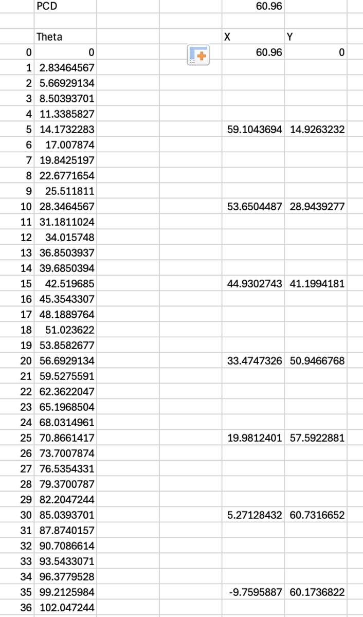

              Many thanks DC31k,

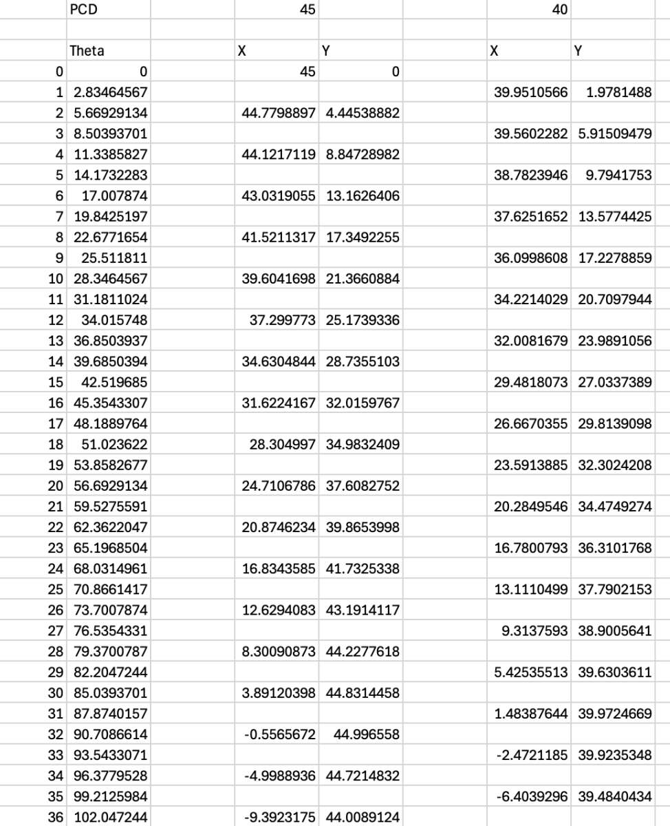

              That has allowed me to build a spreadsheet that can calculate the holes for both discs based on the centre being 0,0 and position 0 at 3 o’clock, as you mention.
              For the OxTools one, PCDs are 45, 40 and 35mm, pick even numbers for outer, odd numbers for middle and #126 for inner ring.
              Screenshot 2024-11-22 at 14.21.10
              For the other one, PCD is 2.4″ (60.96mm) I need to pick every 5th hole for the ring
              Screenshot 2024-11-22 at 14.21.24
              Just had to remember to convert the angle to radians before the trig function for it to work correctly in Excel.

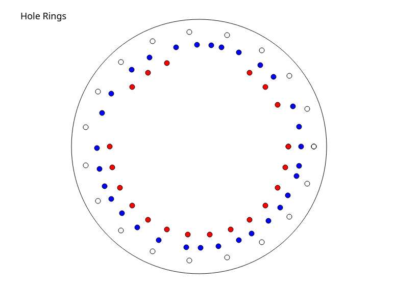

                        My contribution illustrates a more advanced solution to the problem already solved by Zbethyal and DC31K.  Not necessary when a spreadsheet is ‘good enough’,  but programming languages being more general are able to tackle complex requirements.  My code may be of interest to Pythonistas. More complicated than it needs to be or milling and drilling because the computers coordinate system is mapped to a screen The 0,0 origin is top left and negative coordinates are illegal.
                        Here’s my example, with 3 different rings:
                        holerings

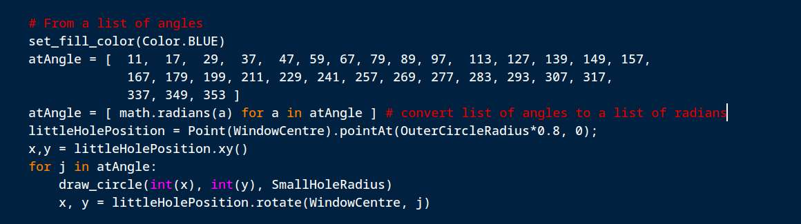

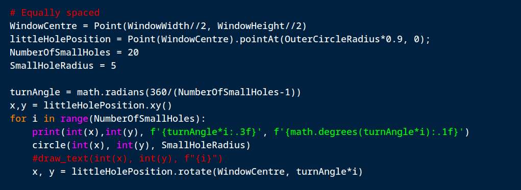

                        The outer ring is 20 equally spaced white filled holes, generated with this code:
                        eqspaced

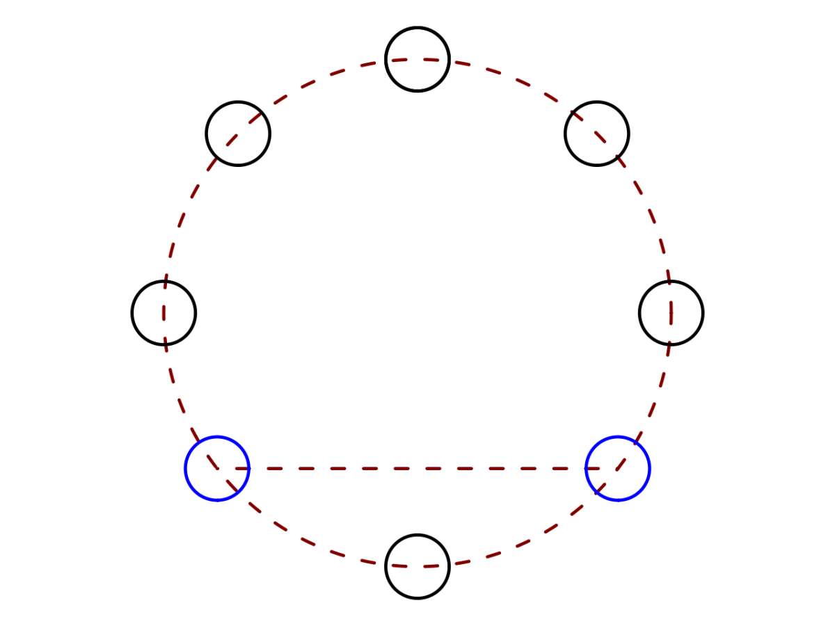

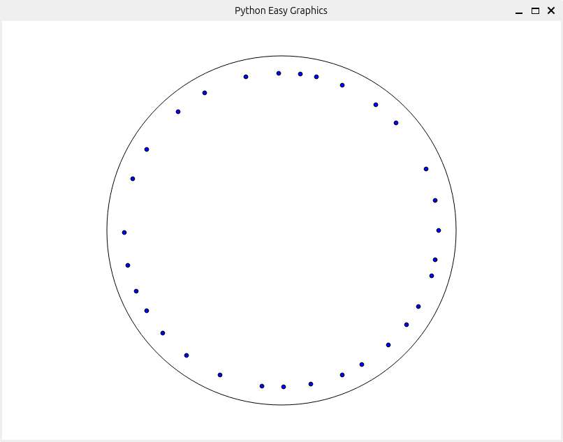

                        The blue ring is thirty odd holes generated from a list.  The hole spacing looks odd and is. It;s the list of angles that are the largest prime numbers in a decade.  Chosen to show anything is possible, not because prime number angles are useful.   Here’s the code:
                        listofAngles

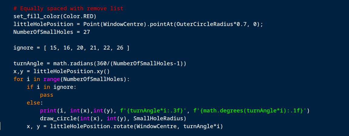

                        Finally, the orange holes are a 27 equally spaced sequence, except the computer is programmed to skip hole numbers 15, 16, 20, 21, 22 and 26:
                        eqspaceremove
                        The code uses a Point class written by me as an off-shoot of Duncan Webster’s locomotive valve gear simulator: he did all the hard-work in ‘C’, whilst I tweaked performance and attended to the graphics.  I wondered if a Python version would be easier to write than C and fast enough to run Duncan’s animation.  The answer is yes, but…
                        Anyway, the Point class supports everything I could think of helpful when working with coordinates, so:
                        littleHolePosition = Point(WindowCentre).pointAt(OuterCircleRadius*0.7, 0);
                        means, calculate the point (x,y) that’s an angle and distance away from the screen centre, and,
                        x, y = littleHolePosition.rotate(WindowCentre, turnAngle*i)
                        means, rotate the position of littlehole about  WindowCentre, by an angle.
                        Hours of fun…

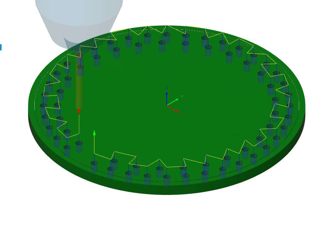

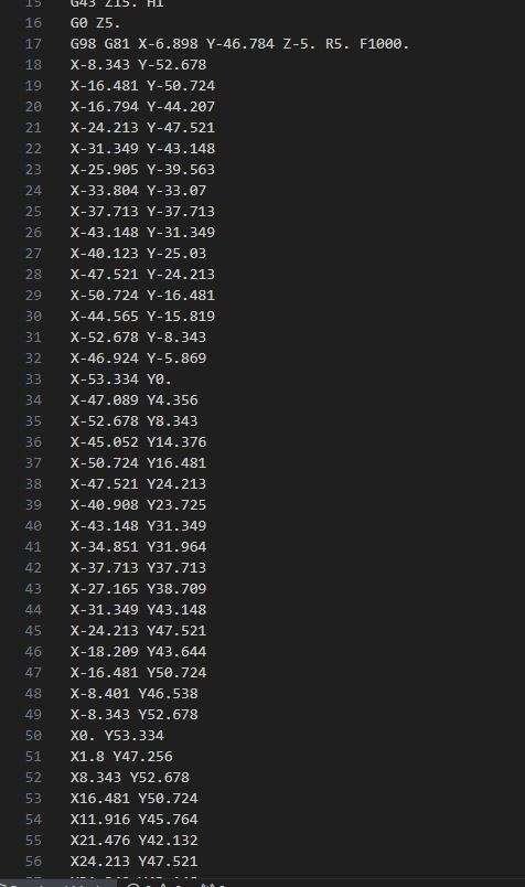

                          You mentioned that you can use F360, rather than have hours of fun it will do it for you in less than 60seconds, well it did for me.
                          Import your 3D model, go to manufacture (CAM) and do the setup which you don’t actually need to alter. Then click drill, pic a random drill bit, select one hole then “all similar” and then it will work it out in a few seconds
                          plate 1
                          Then click the post processor and you can just read off teh co-ordinates from the generated G-code. Good thing is it arranges the co-ordinates with the least amount of handle twiddling between each hole. It starts and stops where the “missing holes” are. I set datun as ctr. but could just as easily be any other position.
                          plate 2
                          A good example that CAM can still be useful even if you don’t have a CNC.

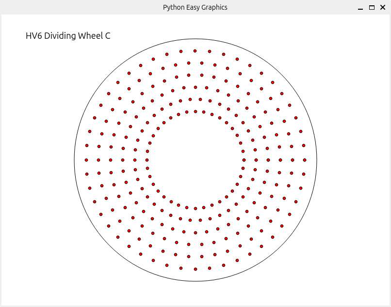

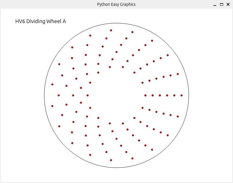

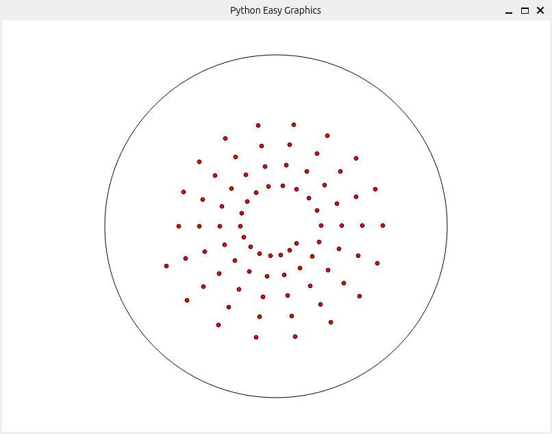

                                        I gave a programmatic solution to holes.  Setting up is harder than the other methods, but once is established, a programmed framework simplifies the harder problems that other tools struggle with, many of them becoming trivial.   This example puts holes on an Archimedean spiral.  The spiral is just an example of a curve represented by a formula, and all curves can be represented by a formula.  Petals, cardioids, ellipses, and many more.  Opens the door on cams etc.

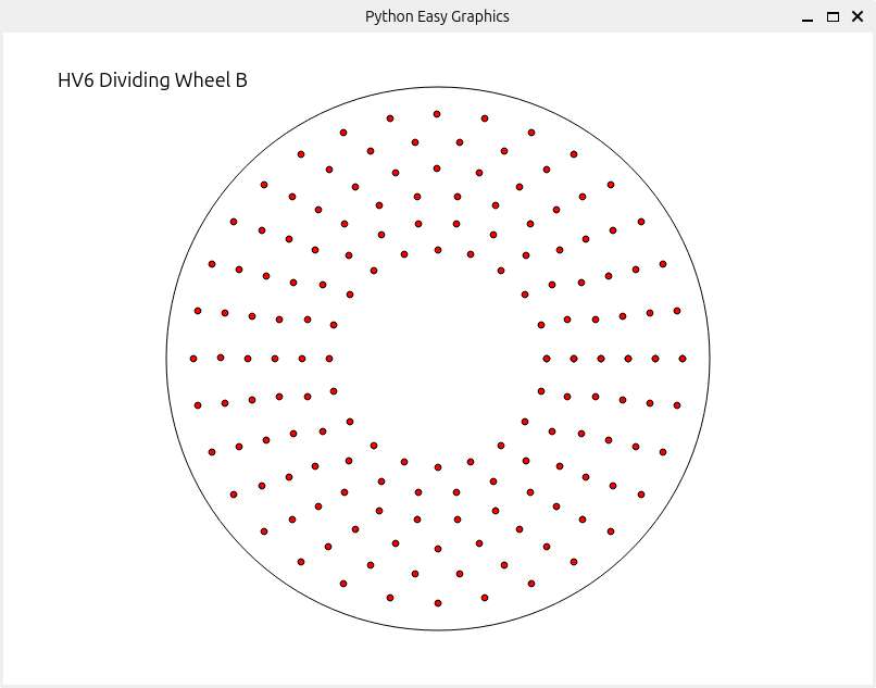

                                        archimedes

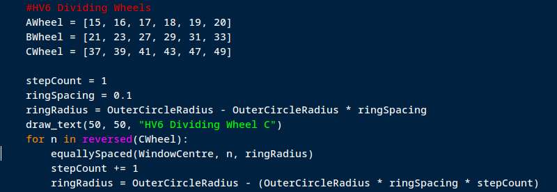

                                        Next example is more useful than plotting holes along parametric curves I’m sure! My program makes index wheels for an HV6 rotary table a doddle, 11 lines of code:
                                        Screenshot from 2024-11-25 11-03-03
                                        Screenshot from 2024-11-25 11-03-54
                                        hv6wheelc
                                        The program…

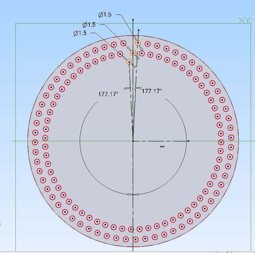

                                            Sorry Dave but you are mistaken on the CAD process for this job. Draw the disk with three concentric circles of the required Ø40, Ø45 and Ø50. Draw a single line vertically from the centre to beyond the Ø50 circle. Chose polar array centred on the circles to put in 127 lines filling the 360° of the circle. Then just place the holes to be drilled at the intersection points of lines and circles as detailed on the original model at the beginning of this thread.
                                            A short and simple process. A few minutes work.

                                              You could also draw a single circle and use a circular pattern and enter $ x 360/127 for the angular spacing where $ is the number of 127th divisions between each circle so in Martin’s case the outer two rings would be spaced at 2 x 360/127 intervals repeated 63 times The first starting at 0 degrees and the second ring starting at 1×360/127and the final hole is 1 x 360/127 to the other side
                                              holes
                                              Exactly the same method can be used with a DRO. Enter the starting and finishing angle and the number of holss for each ring diameter and there is no need to even work out the coordinates it will work it’s way round each ring leaving the correct gap at the end.
                                              #766753
                                                Forgot the sketch that produced the above. I just positioned the three orange circles and did two circular patterns of 63 for the outer two circles.
                                                circles2
