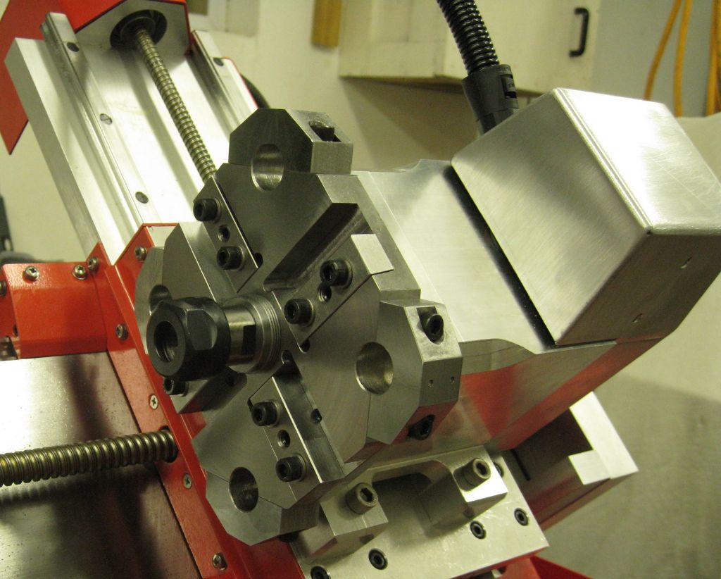

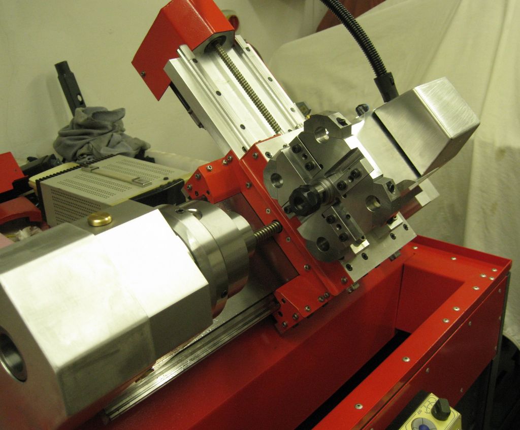

      Still a few bits and pieces to be done on the ATC, swarf guards, etc, but most of the major effort is over. STILL waiting for the Bellville springs – seems I have to wait another 7-10 days, and pay some or other new tax…I am considering ordering from the UK – Will cost a little more, but at least I will get the goods! SA is done…
      I have rough drilled out the axial tool holder locations to 19mm after centering in situ in the lathe. That turned out nicely. I will bore them out to final 20mm with a boring bar in the lathe chuck, but I need the Bellville springs in the ATC for proper location and rigidity.
      Covers are made for the ATC drive belt and the lathe spindle drive belt – to be powder coated now.
      The ATC weighs around 7kg. That is quite a lot of weight at a 45deg slope on the X axis. I am looking for some way to counterweight the X axis. A counter weight and pulley arrangement won't work as the weight would have to move with the Z axis and so flail about…I am looking at the possibility of a gas strut mounted in the plane of the yellow line in the image below – Anyone had any experience with such an implementation? Or any other ideas?
      Joe

      #554515
      blowlamp
        @blowlamp
        Arrange for the weight to run along a roller-track of some sort to keep it from swinging, but still free moving?
        Martin.

        Kiwi Bloke
          @kiwibloke62605
          I'm sure a gas spring would be fine, provided you could, firstly, source, and then afford one (or more). I like simplicity and cheap solutions, so my suggestion would be a tension spring, acting via a cable and pulley(s). The spring's force:extension law would be made linear by arranging the 'pulley(s)' to be of varying radius – think fusee. (It would doubtless look a bit ugly – quite out of place on your masterpiece…).
          BTW, it may be an optical illusion, but the axial 'depth' of the 'teeth' of your Hirth coupling seems constant across the radial direction, and the 'tooth' flanks appear plane. Does this work? I thought that the usual arrangement was for everything to converge to a central point, common to the two members (hope this makes sense).

          Kiwi Bloke
            @kiwibloke62605
            Oh, I've just re-read bits of the thread. You have a compressed air supply. You therefore have a constant force available already – it just needs a container…

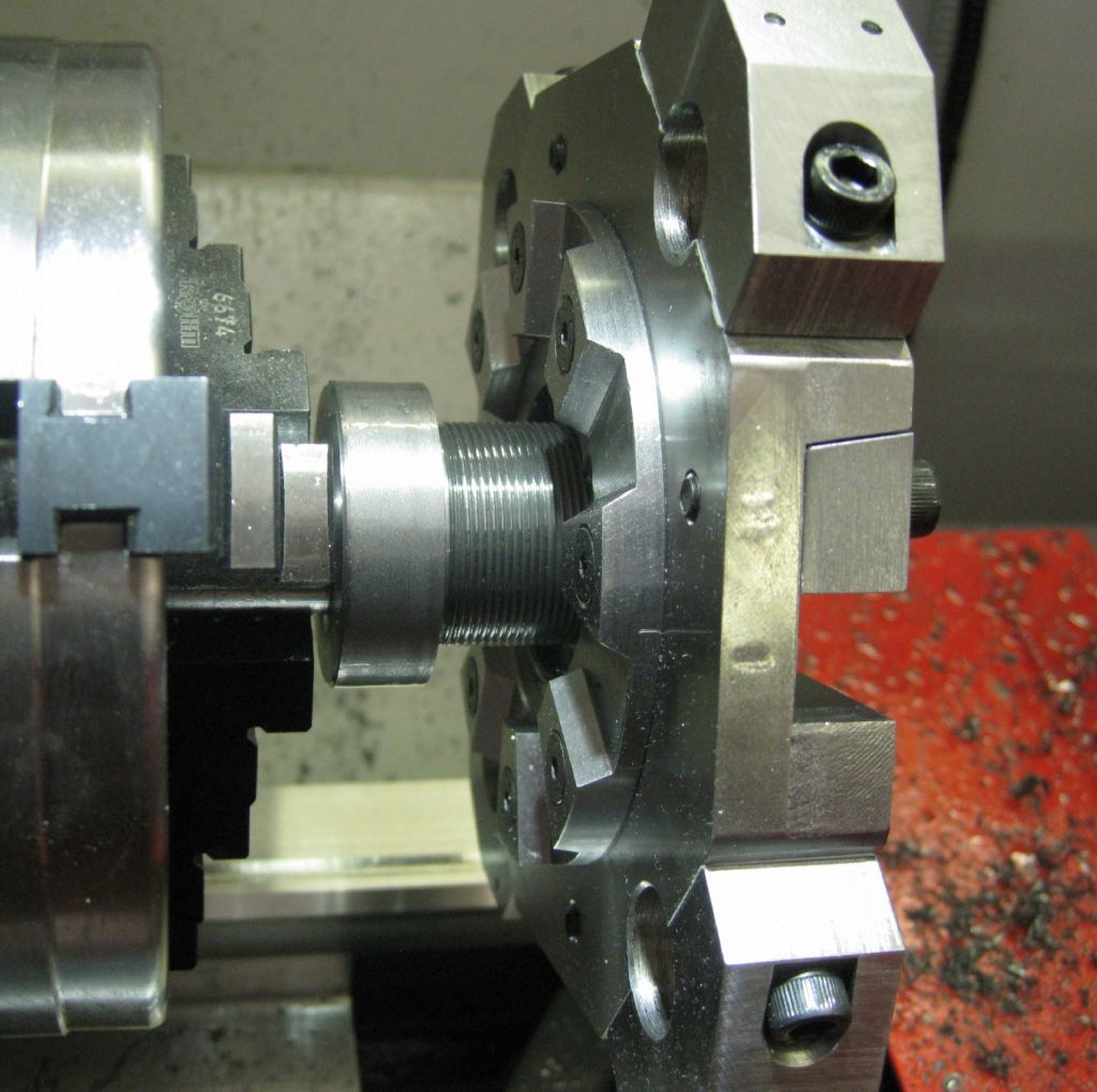

                Joseph Noci 1
                  @josephnoci1

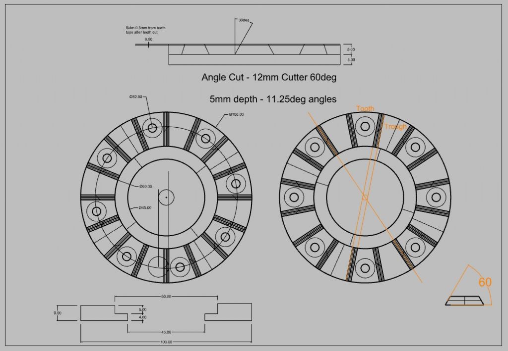

                  Posted by Kiwi Bloke on 18/07/2021 04:50:51:
                  It is an optical issue – Here is a drawing showing the cut lines for the teeth – the sides are at a 60deg angle and the two par orange lines show the upper and lower part of the tooth flank – they do not pass through the disc center. The single orange line passing through the disc center is aligned with the midslope of the tooth flank. This thing was complex to make, and even worse to describe..hirth cut lines.jpg
                  Joe

                    #554579
                    Kiwi Bloke
                      @kiwibloke62605
                      Joe. Thanks for the drawing. I'll have to think about this – my intuitive 3-D visualization ain't what it used to be. It looks like you're using a different geometry from that which I was expecting. The standard Hirth, as I'm sure you know, has teeth whose section remains constant, but whose dimension increases proportional to the distance from the centre. (I too find it difficult to describe…) Everything converges to a central point, which is common to both members when mated, so it's all sort-of conical, so the bottom of the 'teeth' get deeper as the radius increases, and their height (above the plane passing through the aforementioned central point) does too. (OK, descriptive powers have been exceeded…). It was that sloping bottom and top that I couldn't see.
                      I'll try again… You can cut a Hirth using, say, an horizontal mill with a V-section cutter. The centre of the cuts go through the centre. The plane of the workpiece is tilted so the depth of cut increases from zero at the centre to the desired depth at the periphery. The workpiece is turned with the required shallow conical depression before milling. Both members have the same geometry.
                      The idea of a pneumatic counterbalance could be very simple: a piston in a cylinder. If the volume of the supply's air tank is much bigger than the cylinder, and the supply is fairly well regulated, you don't really need a separate regulator for the counter-force pneumatics. If you do, you could use an off-the shelf supply regulator, or an adjustable blow-off valve, if you can tolerate air loss. Simple enough to make, having got this far, but I can also see the attraction of an off-the-shelf gas spring… (Remember, the rod should be below the cylinder, to keep the seal wet.)
                      Apologies if this reads like I'm teaching granny to suck eggs, but I'm aware that these posts potentially have a readership with widely differing levels of knowledge and interests.

                      #554583
                      Joseph Noci 1
                        @josephnoci1
                        Posted by Kiwi Bloke on 18/07/2021 11:37:28:
                        Joe. Thanks for the drawing. I'll have to think about this – my intuitive 3-D visualization ain't what it used to be. It looks like you're using a different geometry from that which I was expecting. The standard Hirth, as I'm sure you know, has teeth whose section remains constant, but whose dimension increases proportional to the distance from the centre. (I too find it difficult to describe…) Everything converges to a central point, which is common to both members when mated, so it's all sort-of conical, so the bottom of the 'teeth' get deeper as the radius increases (OK, descriptive powers have been exceeded…). It was that sloping bottom that I couldn't see.
                        Perhaps Hirth is a misnomer in this application? Certainly this coupler is flat, no cone involved – the convergence to a central point is the common line passing through that tooth flank slope midpoint. Likewise, the center of each tooth, on the disc's periphery, all pass through the disc midpoint, so all is aligned..And as certain, my English fails me hopelessly in my description attempts!
                        The best way to imagine it is perhaps to take one disc as a given, and press it into a flat slab of plasticine – both mate perfectly, both are flat, self centering, etc. How to describe the given disc…
                        The piston counterweight concept does look neat and appears quite simple. I have just done a pneumatic cylinder – the one inside the ATC body, and that was a lot of work! Also, as usual, finding seals and such is complicated here. I see some solutions in the Parker / FESTO catalogues, but I am sure they want both my legs for one..
                        We will see where this goes!
                        Thanks for the ideas.

                              Think gas strut but with an air cylinder instead of the strut. If you find a cylinder which gives the right load with your compressor tank pressure, that's all you need. The force will change a bit depending on actual tank pressure but I doubt that would matter. If you need a pressure regulator to drop the pressure then when the cylinder is compressed the pressure will build up, but the volume of the pipework will limit that. What do the moving bits weigh?
                              #554623
                              Joseph Noci 1
                                @josephnoci1
                                Hello Duncan!
                                I think I have the idea…The moving bits are the tool changer and then the X axis plate and slide bearings – the Tool changer is approx 6.4kg fully loaded with cutting tools, the X axis plate, etc, is another 1.4Kg, so a total of 8 to 9kg max.
                                Not a lot, so probably not worth the effort..
                                Joe

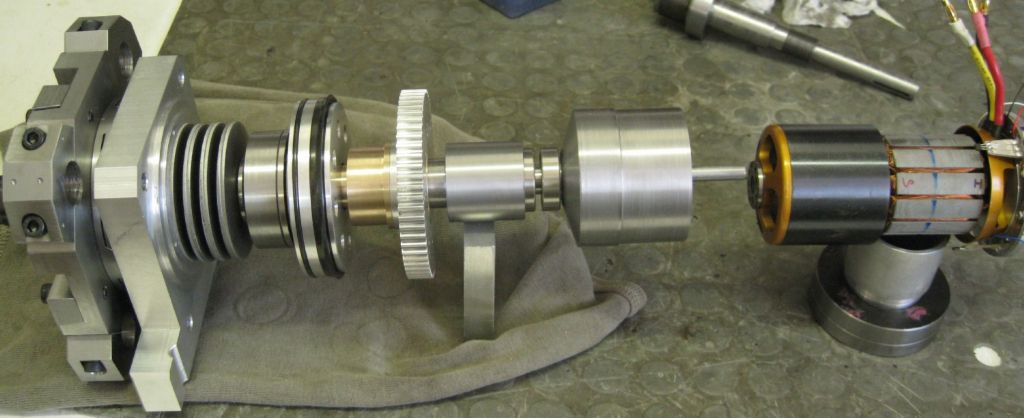

                                      Joseph Noci 1
                                        @josephnoci1
                                        Ok, back to work…
                                        Duncan, I think I follow your idea – makes sense and I will see down what road that all takes me..
                                        This thing is certainly taking me down many a painfull track!
                                        Still fighting the tool changer – still have not receive the Bellville springs from SA..

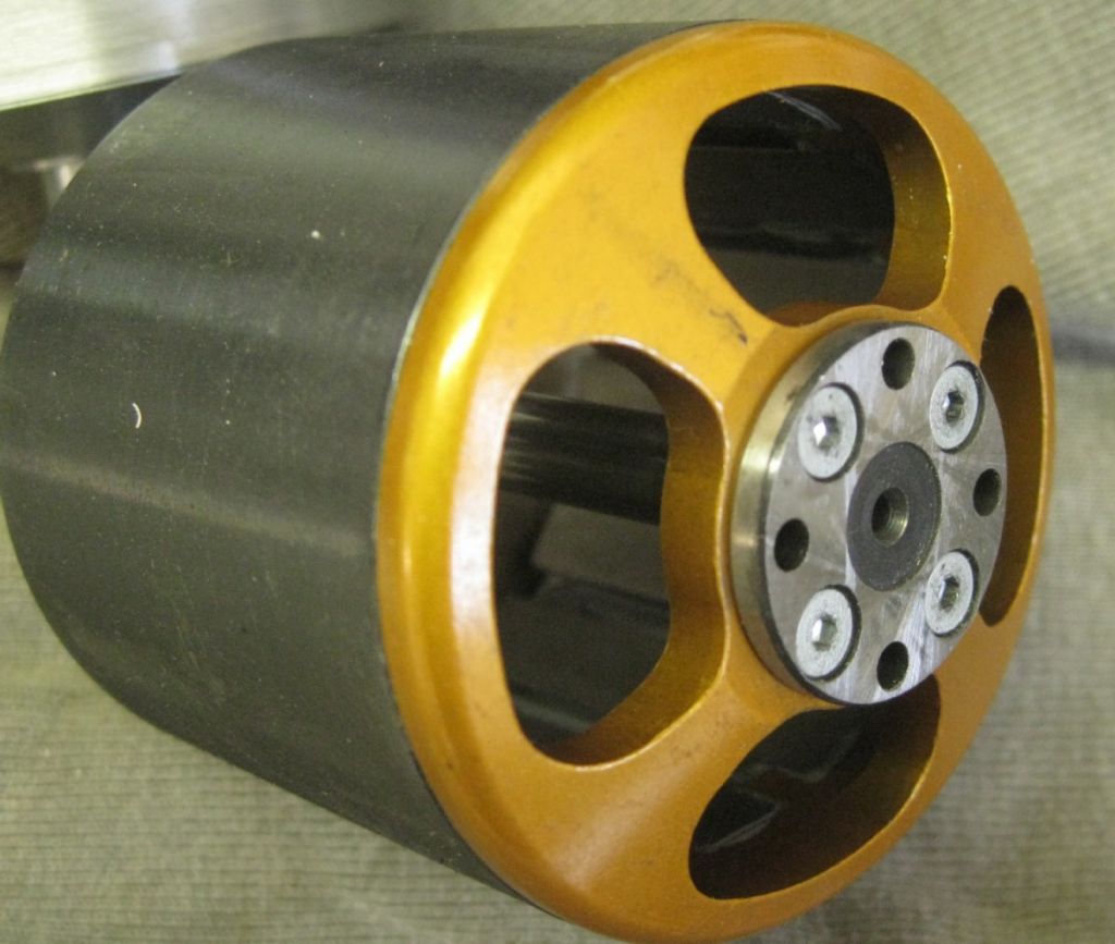

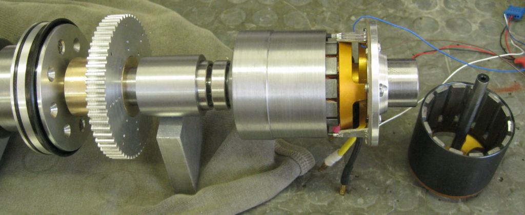

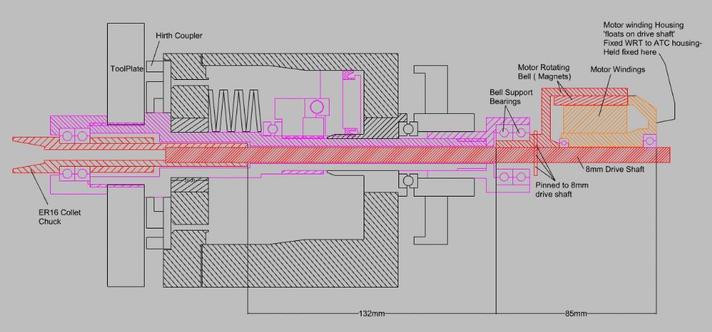

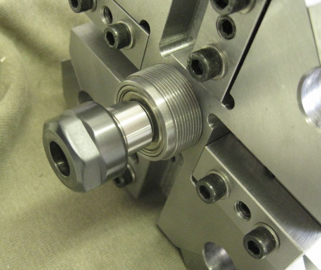

                                        So I started think about the live tooling or milling spindle. The ATC is small, so not easy to incorporate conventional live tooling. I would like to have a radial and axial milling capability, but that means swinging the milling spindle around, and doing that servo-ed is not really feasible on the cross slide, space, etc. Manual swiveling is ok, since milling on the C axis is not done often. I considered 2 milling heads, at 90deg – the axial head can remain in place and will ( should..) not crash, but the radial head must be removed at times..all together a pain in the butt!
                                        Then I thought if I made the axial spindle coaxial with the ATC main shaft, it would free up space in front of the ATC and allow the radial spindle to be fitted there somewhere.
                                        And so the hack began…

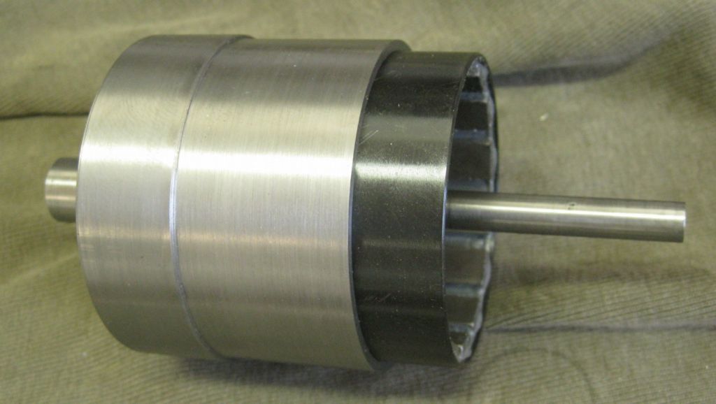

                                        The 9th toolstation was the ER20 Chuck in the ATC toolplate center ( see previous pics..) – the idea was to remove that, and fit bearings carrying an ER16 chuck, with the chuck drive shaft through the ATC main shaft, out the rear and driven by a BLDC motor at the rear.
                                        The RED parts are the milling spindle and spin together. The Lilac parts are the ATC main shaft and are static, except when changing tools – they then rotate to new tool position, and slide left to clear the HIRTH coupler before rotating. On the right is the BLDC motor Bell housing ( contains the motor magnets) which is pinned to the 8mm spindle drive shaft. It is supported by the Bell Support Bearings ( Lilac). The Orange parts on the right are the BLDC motor Windings and rotor(?) core, on bearings, on the 8mm drive shaft. This orange section is constrained from rotating, by a sliding retainer ( not shown) fixed the ATC housing. The orange section, Red and Lilac sections are slide left to clear the Hirth coupler during a tool change.
                                        The 8mm drive shaft has a free length of 132mm.
                                        I have been trying to model what sort of torsional mode will arise in that section when milling – vibration, resonance, etc, but have given up! Very difficult to find data on milling cutter energy needed for an milling edge to cut say mild steel, given DOC, RPM, etc, etc..and then the resulting twist in the drive shaft, and release of that wind-up when the cutting edge clears, etc..
                                        I cannot go larger than 8mm on that drive shaft – increasing means increasing the through hole in the pneumatic piston for the Bellville spring compression. That means less piston surface area and more air pressure needed. I am trying to stick below 110PSI – if you followed the discussion previously in my posts you will know the reasons behind said pressures..
                                        The milling process is low key – not high rate of metal removal, etc.

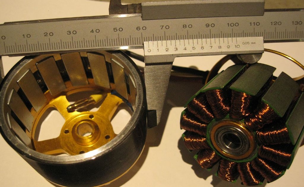

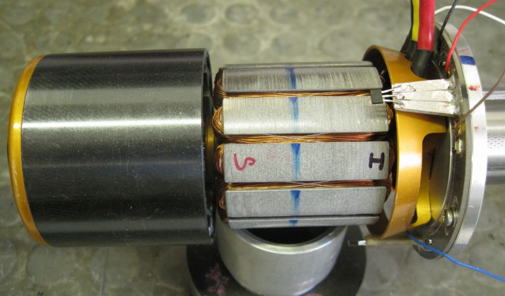

                                        The BLDC motor is a 400watt motor- 400watts for 60sec it says.. 250watts cont. The largest milling cutter would be 8mm, probably 6mm. The lowest useful spindle RPM would be 300rpm and the highest around 5000rpm. The BLDC motor is capable of 5000rpm at 45VDC supply.
                                        Am I wasting my time???
                                        Joe
                                        #558531
                                        Joseph Noci 1
                                          @josephnoci1
                                          So many diversions on this project..
                                          Waiting for materials to arrive also delays things! The Bellville springs arrived – I installed and did a spring-load test which was fine. So now I wait for the steel shafting to arrive so I can make the need ATC main shaft with the through hole for the live spindle drive shaft.

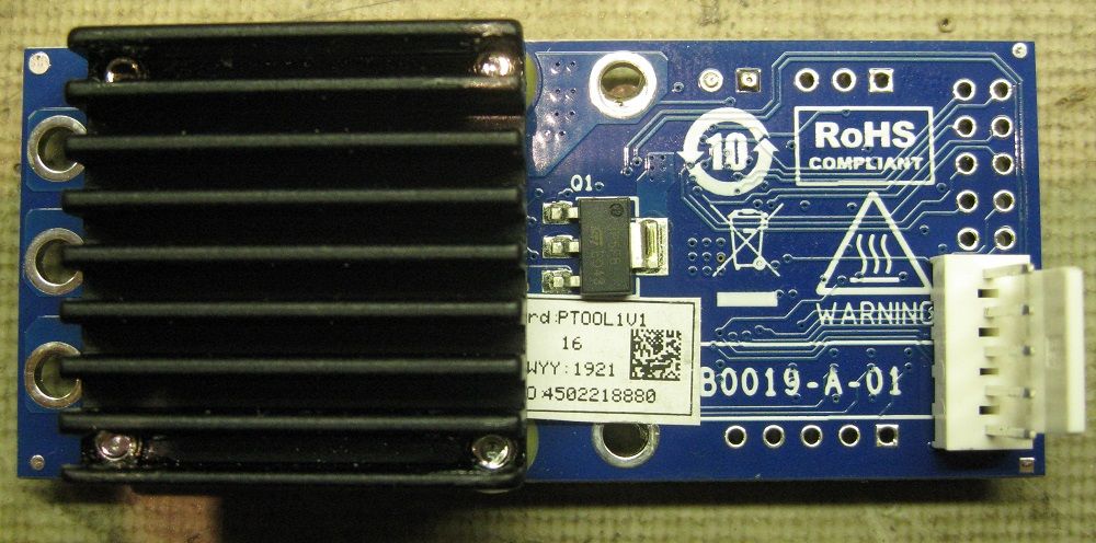

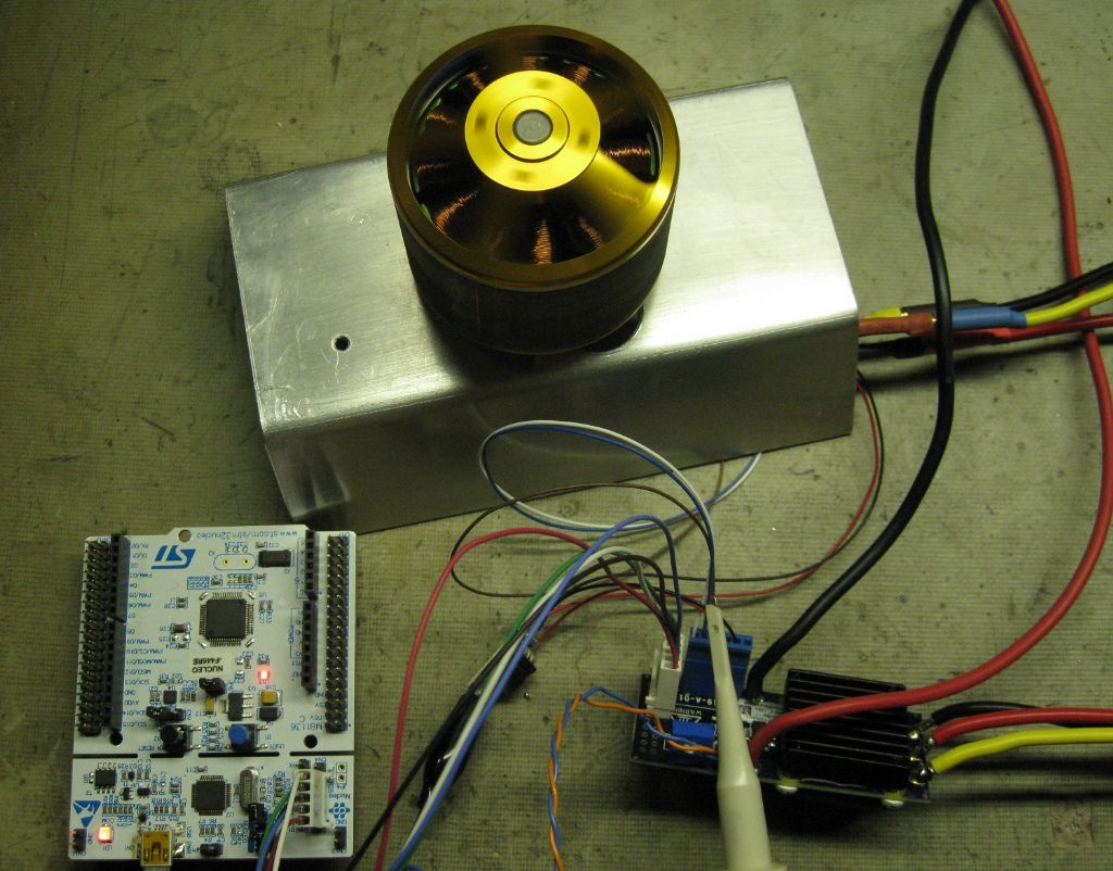

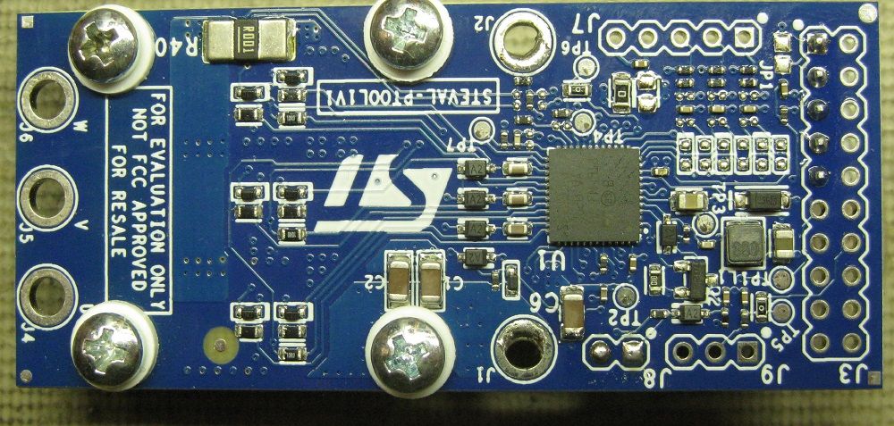

                                          And while on that subject, I started on the BLDC speed controller for the live spindle drive.
                                          This is based on a small development board from ST – the board is about 70mmx30mmx12mm and can take a 45v supply and deliver up to 16amps to the motor.
                                          Managed, with my Good Wife's help, to get a sensored, FOC control software suite running, and the motor runs so sweetly. A leather gloved hand was used to load the motor in tests…
                                          At 500RPM, with 40VDC supply and 12amps the motor speed slows by 40rpm. Releasing the load ( take my hand away..) and the speed momentarily jumps by 70RPM and settles back at 500rpm – the jumps lasts about 300ms.
                                          At 2000RPM, its a little hairier…40VDC and 14amps, the motor speed drops by 30RPM, and jumps by 45RPM when releasing the load – takes 380ms to settle. The PID is nice and tight.. Tests are very quick and time spaced – 40V/14A is over 1/2KW, so the glove, motor casing etc heats up fast when applying load by friction!
                                          A few additions to the code still – a ON/OF control for the motor, so failure detection ( hall sensor failure, motor stalled, etc) so the LinuxCNC can know to not run the milling cutter into a workpiece while not spinning..
                                          The controller underside:
                                          Heatsink side:

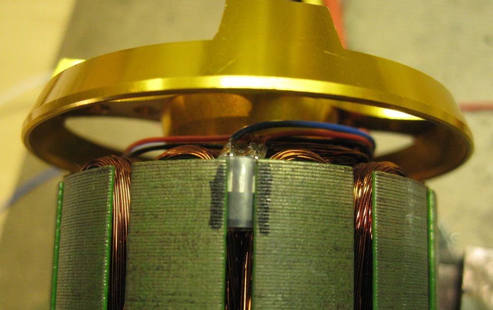

                                          One of three hall sensors fitted – 120Mechanical degrees apart, which works out to one sensor spaced four motor slots apart in the 12slot motor. The motor is 14poles, ie, 7pole pairs, so the 120 mechanical degrees equates to 17.1 electrical degrees. Sensors will be epoxied in place next.
                                          Test setup…The Nucleo processor board lower left is just being used for the programmer part of it, to load the code into the BLDC controller.
                                          The project certainly covers all bases!
                                          Joe

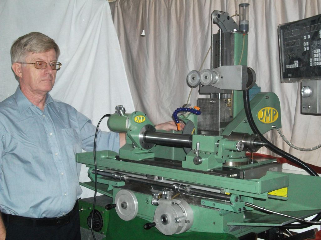

                                          John P
                                            @johnp77052

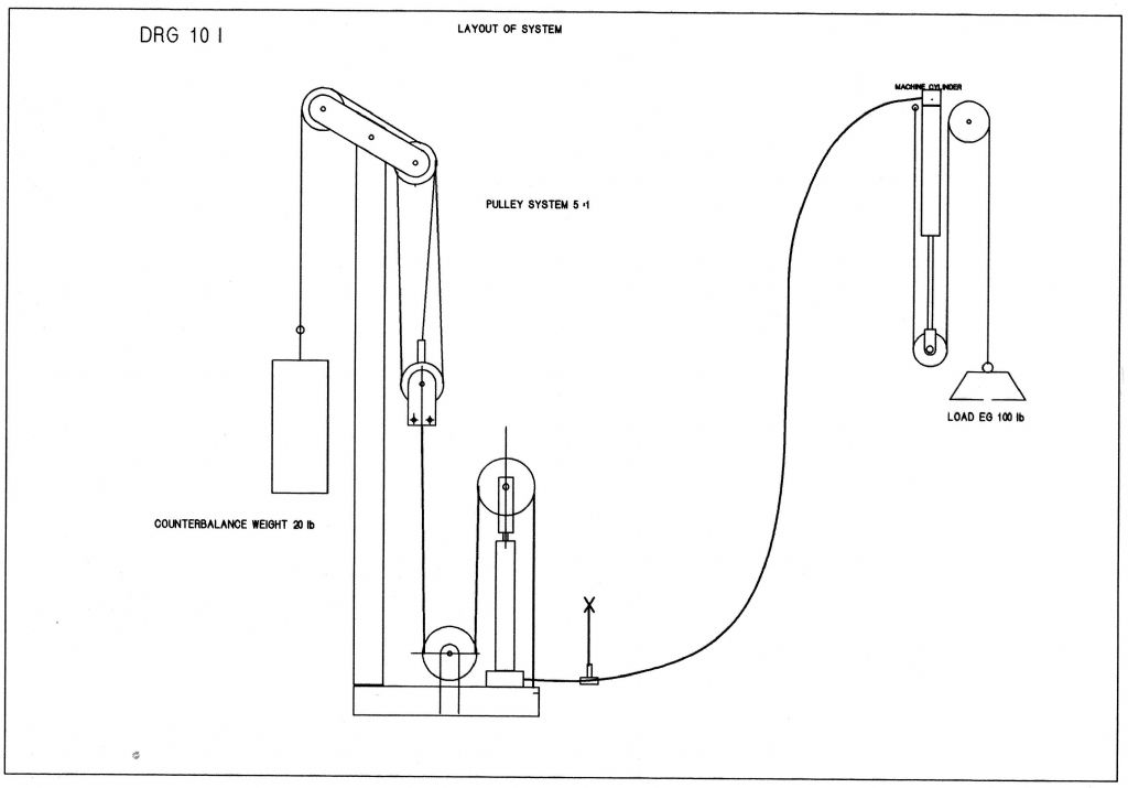

                                            Posted by Joseph Noci 1 17/07/2021 20:52:35
                                            Or any other ideas?
                                            Hi Joe,
                                            I faced a similar problem with the Zaxis down feed on the Universal grinding machine
                                            that i made ,except the axis was vertical and the weight it had to counterbalance
                                            was about 80 lb ,there was not enough room within the hollow column for a suitable
                                            size weight . A pair of cylinders were made from some smooth bore stainless
                                            tube and just using O rings for seals .the sketch shows the layout ,the 2 cylinders
                                            are connected with some nylon tube ,just used 32 grade oil ,the pressure in the
                                            system is just over 350 psi and has worked well for over 8 years.
                                            One hydraulic cylinder fits inside the column the other is remote in the corner
                                            of the shop out of the way.
                                            As you can see here in the photo the cable supports the the head slide both
                                            grinding spindles and the motor and drive assembly.
                                            This did appear as an article in the Model engineer
                                            hydraulic counterbalance published 4494 30 oct 2014 and 4496 28 nov 2014
                                            they made a complete mess of the article drawings missing some redrawn
                                            and published twice the photo's were just ruined.
                                            The force remains constant over all of the travel as it is just gravity and it
                                            is simple enough to adjust to the load that you require.
                                            The counterbalance weight can be remotely located in any convenient
                                            spot.
                                            #558551
                                            Joseph Noci 1
                                              @josephnoci1
                                              Hello John.
                                              Now that is neat, and the diagram is worth a thousand words. All the other posters 'hinted' at the concept but though I seem to be 'good' at what I am doing here, sometimes 'concepts' remain simply that in my head! Thanks for the info.
                                              John, I seem to recall we conversed some time ago – maybe on the making/grinding of a shop made dovetail cutter?? Or maybe I am just blowing smoke again..The photo of the grinder seems to have triggered that memory.
                                              Joe

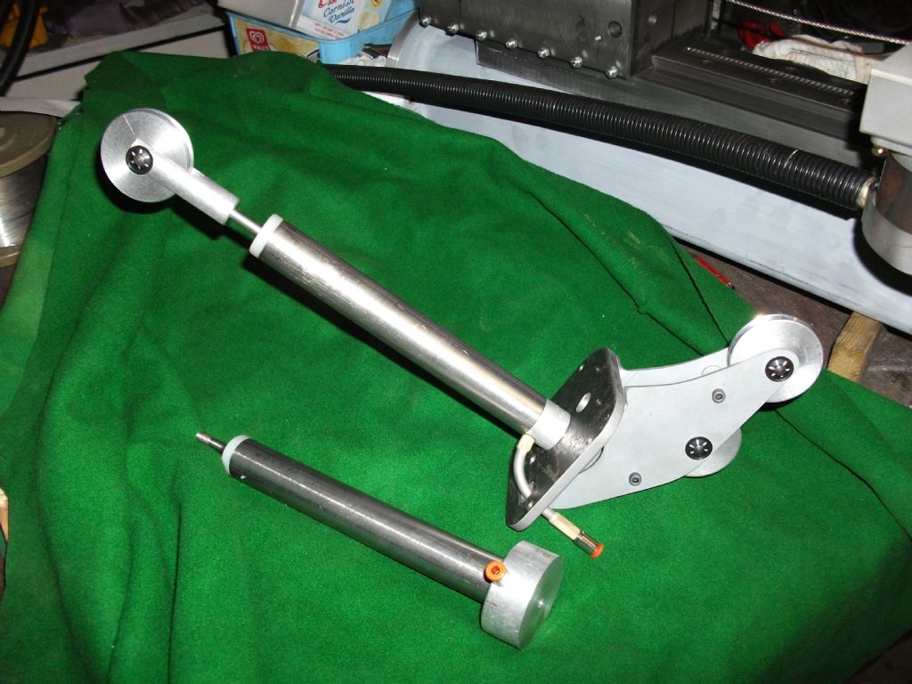

                                                Here is a photo of the two cylinders as you can see
                                                the construction is very simple, i only needed a connecting tube
                                                of 4mm OD as the grinder movements are small and fairly slow,
                                                the down feed when in cnc mode is 0.00001 inch. per motor step,
                                                perhaps more important is the tube does not place any load
                                                on the in feed axis of the grinding wheel as this can feed in increments
                                                of much less than 1 um if needed, i would think that if you were to use
                                                a similar system a larger connection tube would be needed to cope
                                                with the greater axis speed.

                                                      As a reference for parts, i have included the block diagram again:
                                                      This is a trial assembly of the important parts – the motor fitting still in progress
                                                      The main new item was a replacement central shaft, with through hole for the live spindle drive shaft –
                                                      here is the shaft being threaded for the toolplate, central pre-load nuts and motor mount.
                                                      Toolplate thread test fit:

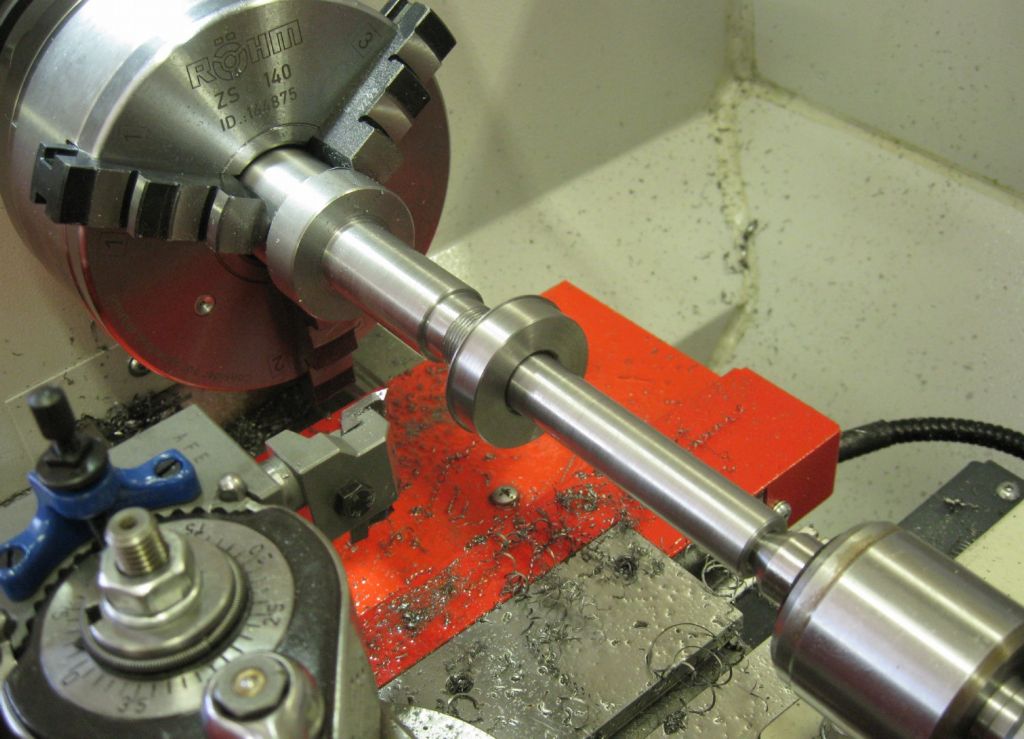

                                                      The collet and bearings fitted – test spin by hand..Face pre-load nut still to be made.
                                                      Spindel dive motor and halls sensors fitted:
                                                      The left section is the magnetic rotor .
                                                      The orange part of the rotor will be machined off, as the rotor fits into the new motor housing below:
                                                      Motor stator inside motor housing
                                                      Motor Rotor slid into motor housing – own shaft still to be pressed out and the orange part machined off.
