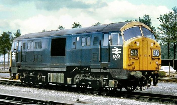

        Although I am still working on the 0-4-0 loco I have in between jobs given some thought to my next project a Class 22 (baby warship). The 0-4-0 is a test piece really and my first attempt at a 5 inch loco, its not a model of any real loco but more a fun model which I hope will pull 2 or 3 passengers. The class 22 will be semi scale and hopefully a reasonable representation of the real loco.
        A grubby and well used Class 22.

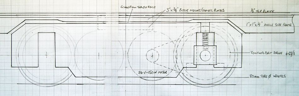

        Early days but a sketch below of how I may approach the build of the bogies and drive assembly. The loco is twin bogie with four axles all of which will be driven. Apologies for the state of the sketch but hopefully it shows how the axle/motor frames pivot on a shaft mounted across the centre frame. The axle suspension is via springs mounted to a pair of bars, a fixed bar between the axle frame sides and a pivoting bar mounted to the centre frame.
        Nothing is set in stone, just ideas at the moment.

          As you will have more space to play with you might want to look at raising the motor up and also using chain drive to get the mechanicals clear of track debris.

            Classy sketch Ron! Is it the result of training or natural talent? Although designing on squared paper helps me think my efforts on squared paper are far less artistic. Too often I go straight from 'back of envelope' to CAD as a way of reducing the embarrassment!
            Another point – although CAD is brilliant in every other way I find the drawings lack personality compared with those made by a draughtsman on an old-fashioned board. Producing good looking drawings is part of the hobby's attraction for me.

              Thanks Bazyle, you have told me before about track debris, the club track is raised and I was assuming it would be cleaner than ground level track but I will take a look at it. I would rather stay with gears if I can plus there is a limit to how far I could raise the motor without it clashing with the upper chassis/batteries etc.
              Ron

                Thanks Dave, the last time I did any technical drawing was back at school which was a long time ago. I just find graph paper easy to layout, I would like to be able to use CAD but I fear I would be hopeless at it and can probably finish a drawing (good enough for me to work from) quicker than I could manage a couple of lines on CAD.

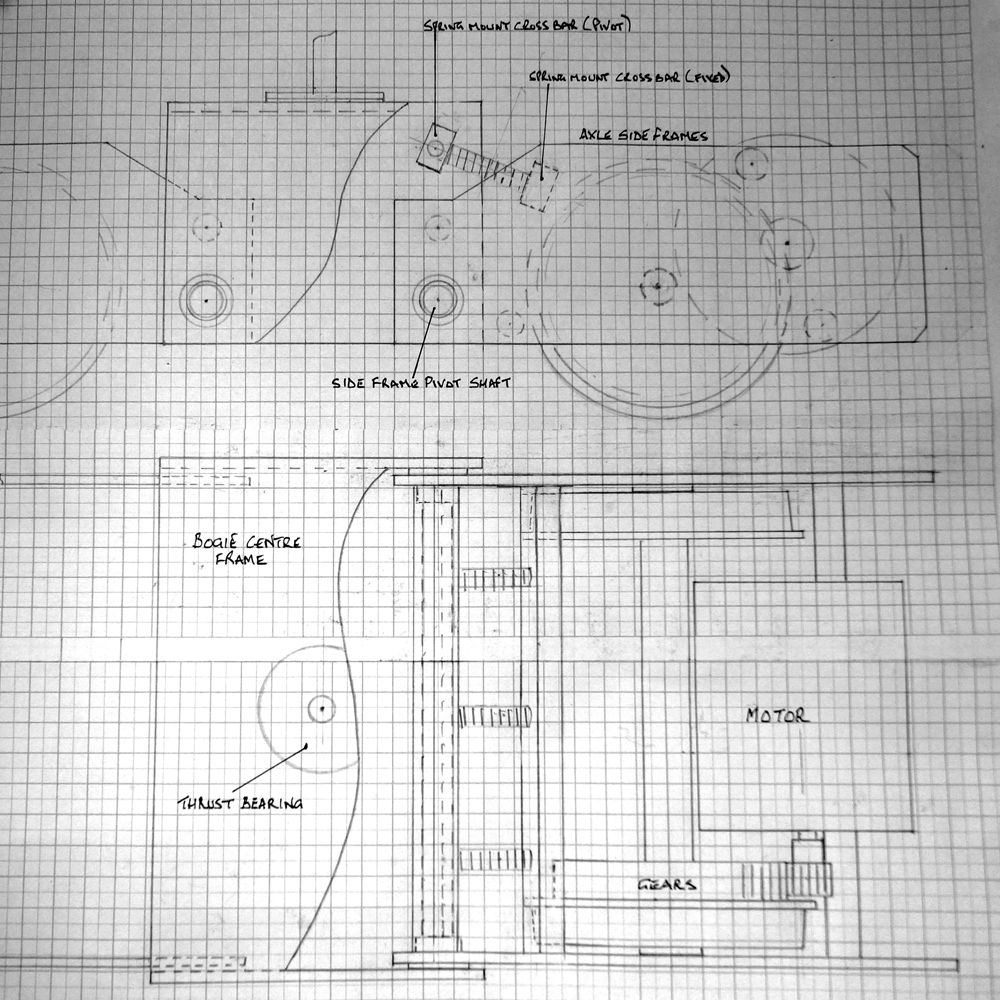

                                                      Excuse my rough sketch but it shows another option for the loco bogies which would have sprung axle boxes and toothed belt drive against the gear driven trailing arm type bogie I posted previously.
                                                      I think this is a neater option housing the motors within the axles and the overall bogie length is 100mm shorter than the trailing arm type. Also the sprung axle boxes are more in keeping with railway practice plus the track to chassis top plate dimension is 100mm so it wouldnt look too leggy. Still not 100% decided on which bogie type to go with but it probably will be as below.
