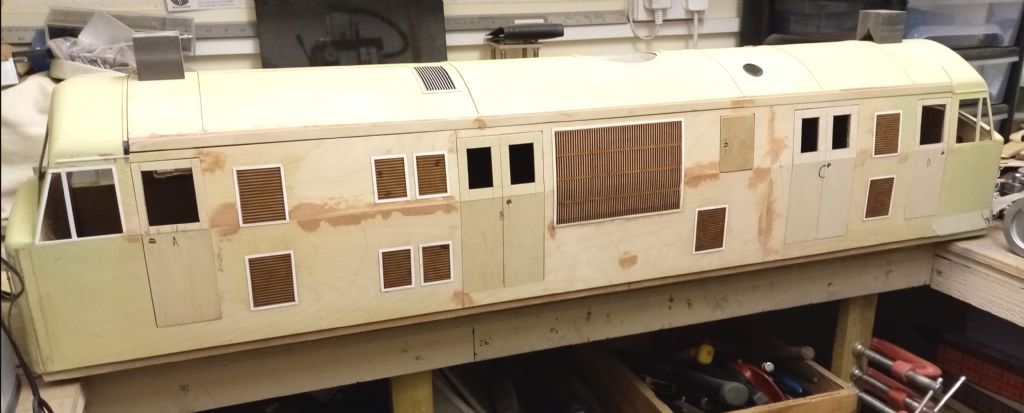

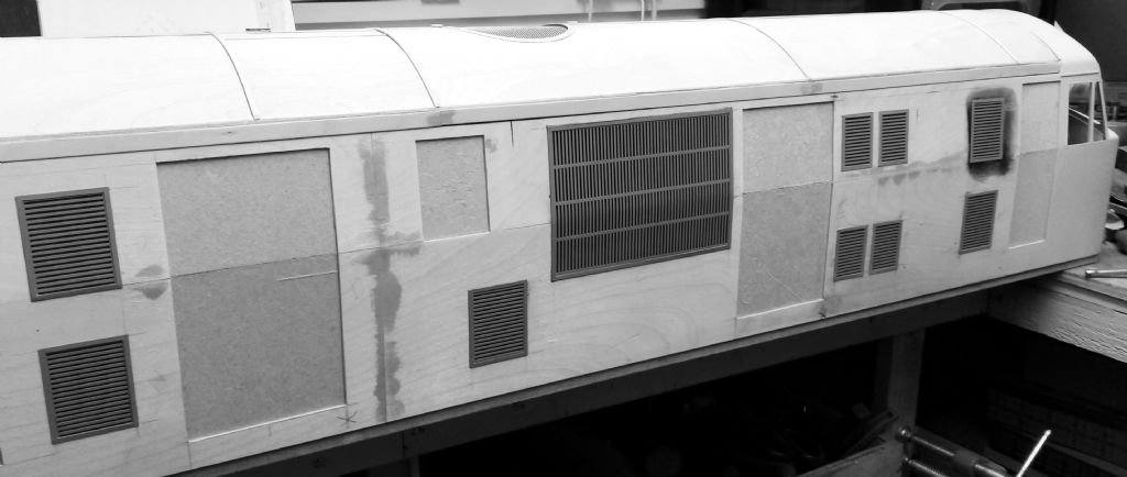

            Vent grills added, 10 per side including the large one. I had them laser cut which I make no excuses for, they are far neater than I would have achieved from the methods I was considering plus they would have taken forever and a day.
            Now it's 4 cab doors, 4 double engine access doors and 2 small panel doors. The doors I will be making and they are all glazed apart from the 2 small ones.
            It's coming along, slowly.

                      Thanks Jeff it's coming along and not too far away now. I have taken a few close up shots for the album, here is one showing a pair of access doors and some of the grills (am I glad I had them laser cut).
                      Ron

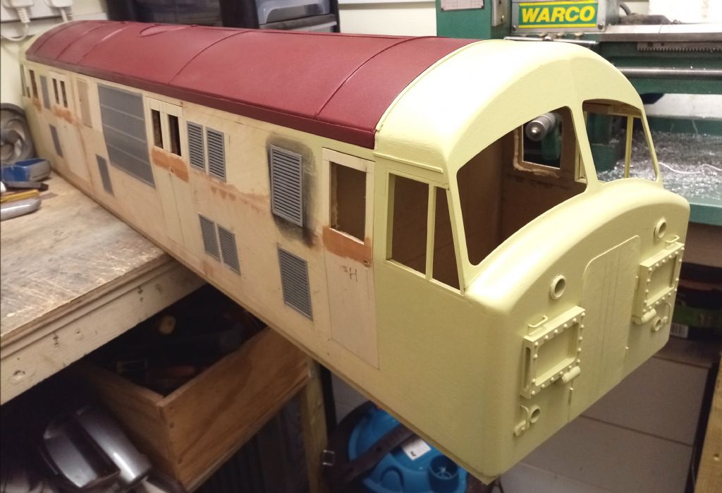

                                    Apart from the windscreens and wipers which come after the painting the loco ends are complete, some of the detail I will pick out but again after the top coat is finished.
                                    #523954
                                    Ron Laden
                                      @ronladen17547
                                      Removable roof painted with two coats of top coat over brown primer. It gives good coverage and I,m happy with the colour. Its a bit darker than the picture shows and its quite close to BR Maroon which is what I was after.

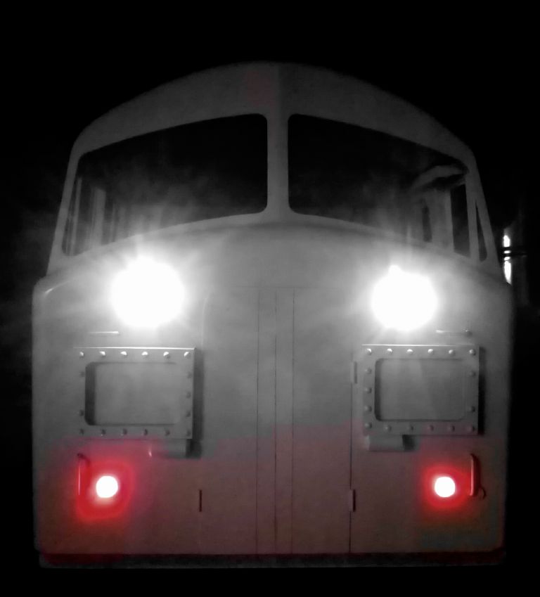

                                          I have been playing lights today, picture below.
                                          Quite pleased with them, the headlights are 12 volt 10mm ultra bright led,s and the tail lights are standard 12 volt 8mm red led,s. They are copied both ends of course, the main loco power is 2 x 12 volt in series giving 24 volts. Four of the lights draw just 40 mA total so I plan on supplying them from one of the batteries giving 12 volts. At such a low current I don't think it will unbalance the batteries plus I will run the tiny roof fan motor from the other battery which should balance things out somewhat.
                                          The camera didn't like the red tail lights showing white centres but they show fully red to the eye.
