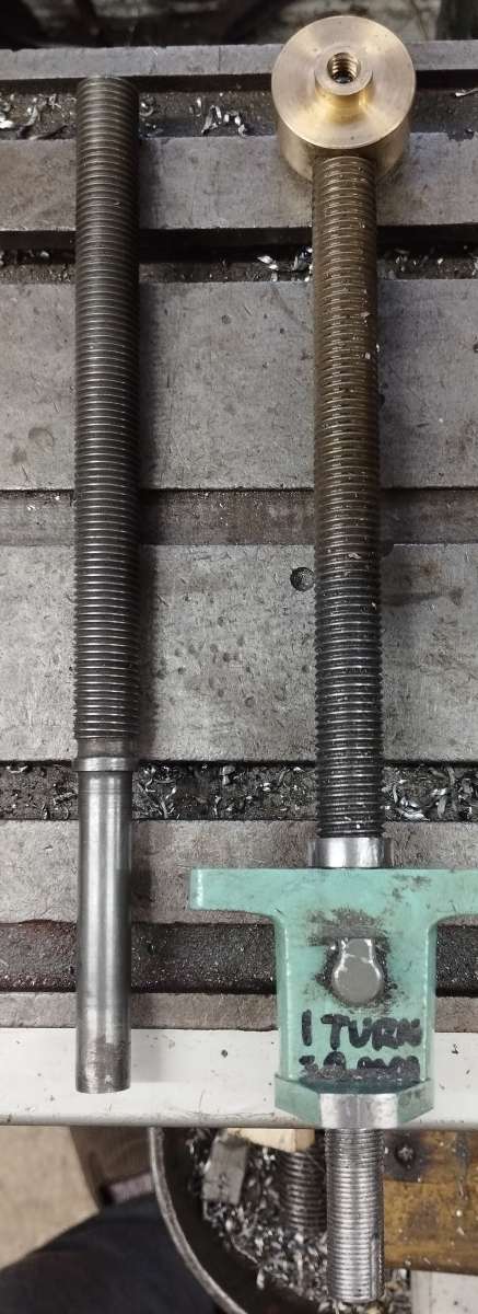

            My Clarkson T and C grinder was well worn, the previous owner replaced the standard leadscrew, 5/8″ x 14 LH, with an M16 x 2 RH screw.  Inconvenient, caused a few problems being the wrong hand.
            I replaced it with an M10 x 2 Trapezoidal (Acme) LH screw and nut bought from either Temu or Aliexpress, forgotten which, for a fiver, the correct hand, no more mistakes!
            The first photo shows the original LH screw (on the left) and the RH metric replacement.  The second photo shows the correct handed metric replacement, before fitting a graduated dial. Also a modified support for the lead screw, part of the attempt to make the machine foot print more compact. 17714871862041771487186190

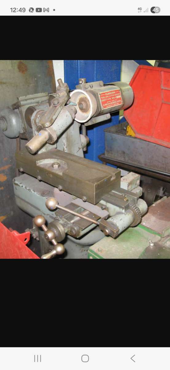

                                    Here’s a picture of what I believe is a Mk1?
                                    It’s not mine but it appears to be the same model.
                                    <p style=”text-align: center;”>Screenshot_20260219_124954_Samsung Internet</p>

                                      No dial on my Mk 1 and nor room for one either.
                                      Dunno how old mine is but Clarkson had a steady programme of improvements during the life of the Mk 1 so quite likely that later ones got them. No pictures showing a dial on a MK 1 in my collection of manuals and instructions. Although a manual featuring both Mk 1 and Mk 2 clearly shows a dial on the Mk 2.
                                      Clive

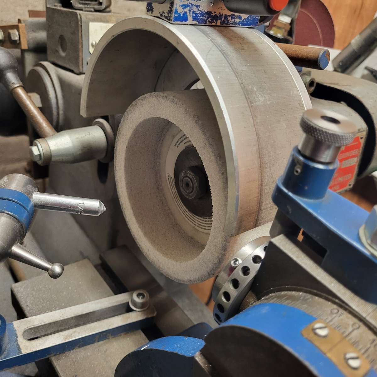

                                              Photos of my MK1 with dial as promised.
                                              20260220_190344

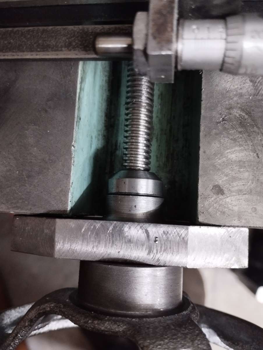

                                              #838710
                                              fishy-steve

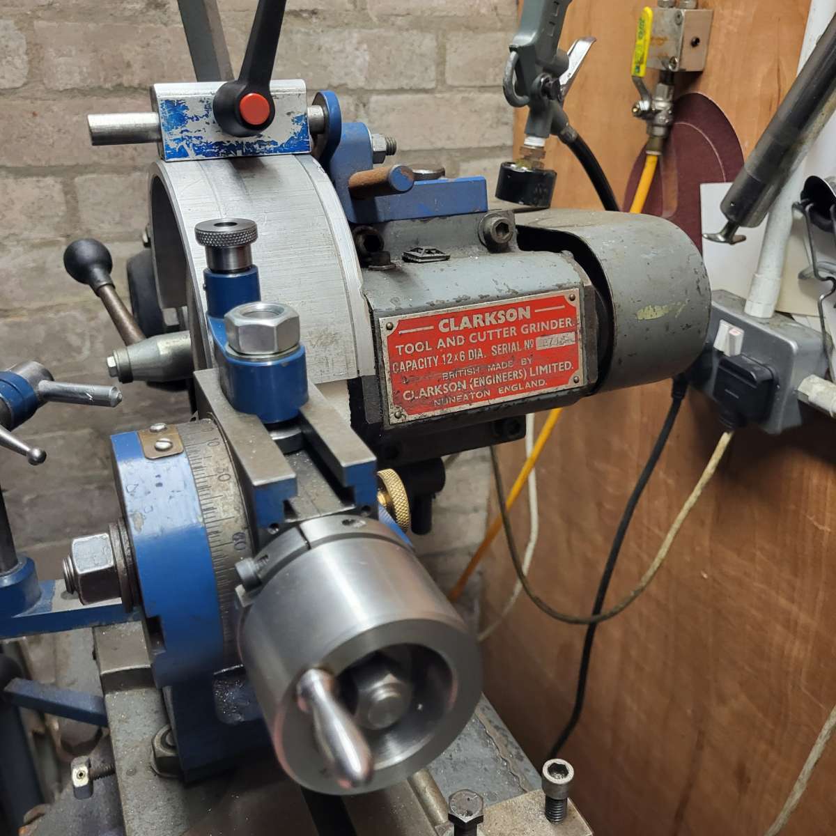

                                                @fishy-steve
                                                20260220_190352

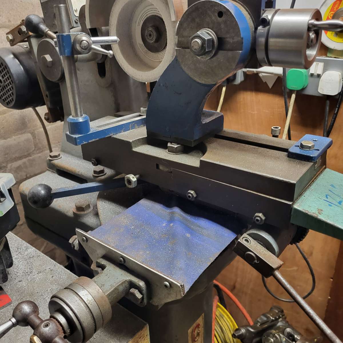

                                                #838712
                                                fishy-steve
                                                  @fishy-steve
                                                  20260220_190409
                                                  #838740
                                                  John MC
                                                    @johnmc39344
                                                    That’s not a Clarkson universal head is it?  Looks to be a better thought out device.
