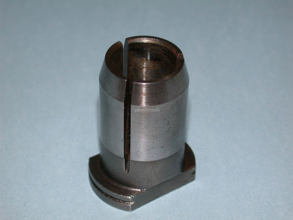

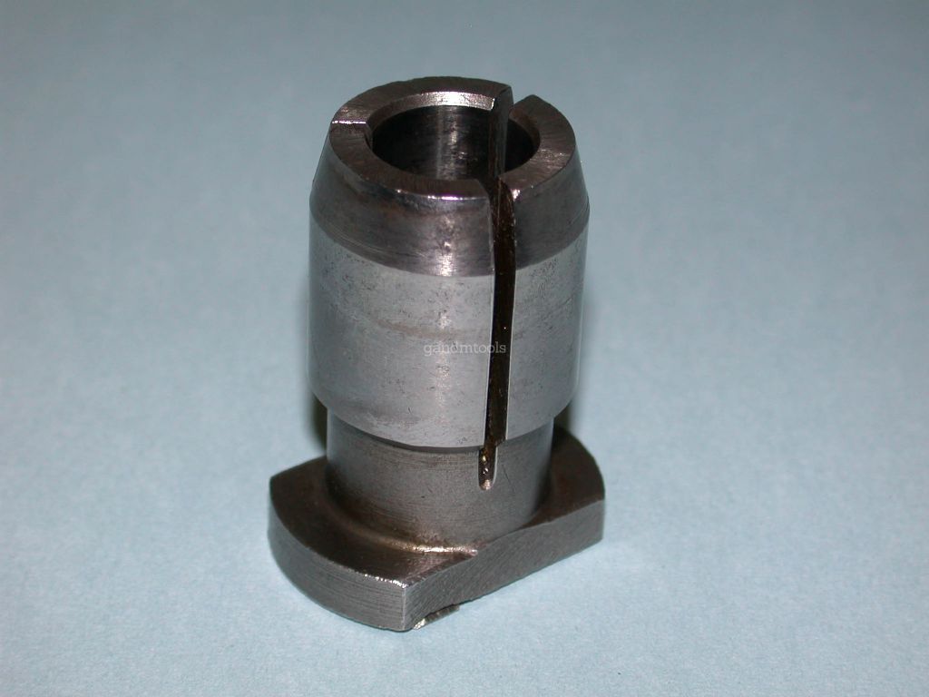

            For quick identification, the metric ones have a groove cut round the base.
            This is a metric collet
            And this is an imperial collet
            There are 4 in the metric set 6, 10, 12 and 16 and 4 in the imperial set 1/4", 3/8", 1/2" and 5/8" for the small S type chucks.

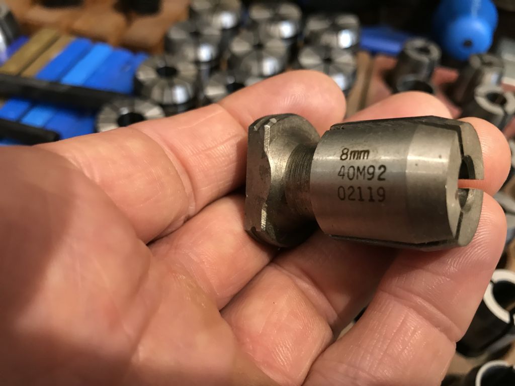

                                      Rare but occasionally you find one…8mm Collet

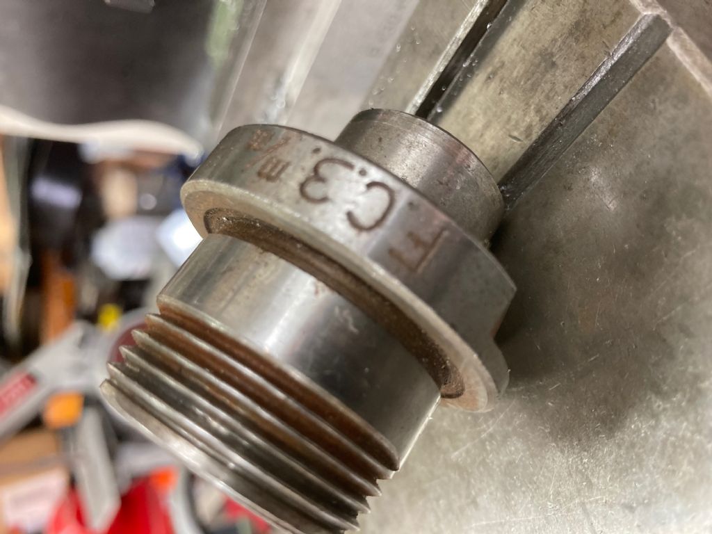

                                          You can also get FC3 adaptors. Mine has rarely been used and looks like it's in need of some TLC.
