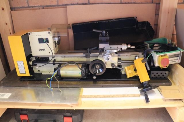

      Hi, i have been given a non working CL350, I’ve been told the only thing that needs replacing is circuit board. Knowing most of these machines are all built using similar components, does the 350 share the same control board as the C3?
      It may be a few weeks before it lands with me so I have time to do my research. From what I gather the lathe was bought around 2010, but has only see light use, till the board went bang.

                    #349631
                    Jon Cameron
                      @joncameron26580
                      The sorry looking state of the lathe.
                      Original photo of lathe as offered
                      Edited By Jon Cameron on 10/04/2018 08:34:26
                      #349632
                      Pat Bravery
                        @patbravery
                        Maybe if you could get a picture of the lathe it would help, you will need to read the previous posts which clearly explain the methods to test the electrics before doing anything else. Pat
                        Beat me to it, I don't recognise that lathe.
                        Edited By Pat Bravery on 10/04/2018 08:35:10

                            Posted by Pat Bravery on 10/04/2018 08:33:57:
                            Neither do I in its current state.
                            Clarke lathes seem to be yellow. So i think hes correct on it been a clark.

                                Having a closer look at your photo it does seem to be a lathe made up from other lathes bits, I would guess that the grey parts could be from an Amadeal CJ18 or similar and the yellow bits do indeed look as though they are from a CL300, some of the mechanical parts are interchangeable but the electrics are not. My CL300 before I sold it had a sticker on the circuit board showing the part number, could you get a photo of the circuit board? I am sure that it could be identified very quickly. Pat
                                #349643
                                Jon Cameron
                                  @joncameron26580
                                  I dont know if i can get another photo, feel cheeky to ask since its all for nowt. All I've been told is that the board says 2335. When I have a Google it sends me to arc Euro for a C3 lathe. After not getting a definative answer by googling all I can surmise is that the board is the same as the C3 but just wanted to double check if someone knew for certain on here.

                                      John Rudd
                                        @johnrudd16576
                                        Posted by Jon Cameron on 10/04/2018 09:57:28:
                                        The 2335 number I suspect could be the Sieg XMT 2335 board which is available from Arc.
                                        This board features a pair of thyristors in a bridge arrangement to provide the dc drive to the motor. These boards are more reliable than the earlier boards used on the CL300 machines that featured a pair of mosfets to drive the motor, would fail at the drop of a hat…

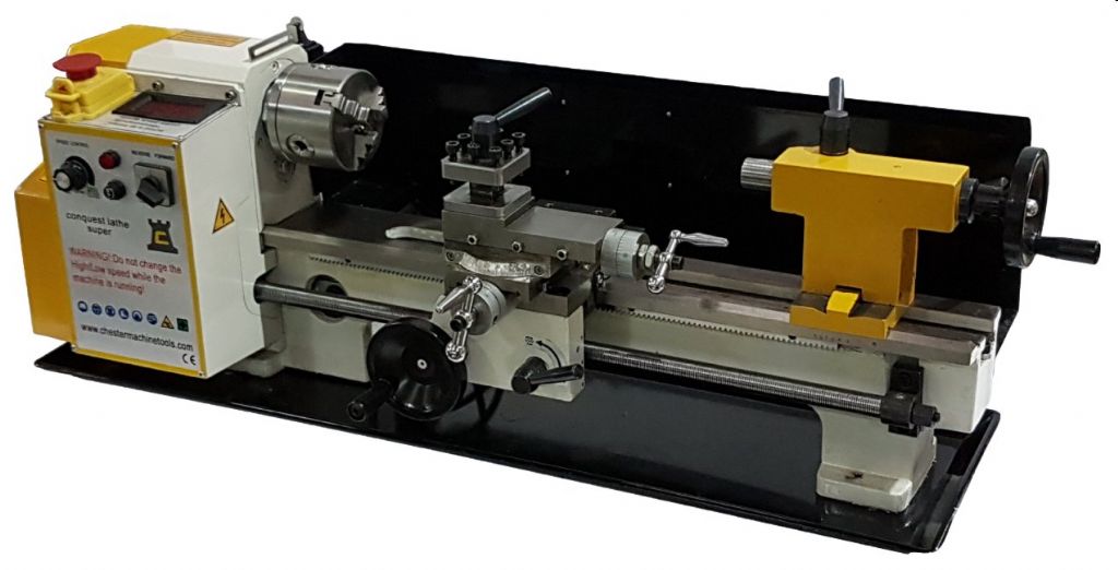

                                          Posted by Jon Cameron on 10/04/2018 07:56:32:
                                          I've been told it's a CL350, an upgraded version to the 300, with larger motor and digital speed readout. This is what printed the question. The circuit board I think is the same used in the C3 with the 350W motor which I am told this lathe has.
                                          The Lathe is (almost certainly) a Chester Conquest Super, essentially a SIEG C3 (not to be confused with the SC3)
                                          It isn't the Clarke badged version.
                                          http://www.chesterhobbystore.com/conquest-lathe-super-3966-p.asp
                                          400W brushed motor, so a C3 controller board (NOT an SC3 brushless controller board) should work.
                                          Edited By Neil Wyatt on 10/04/2018 12:58:19

                                            Hi Neil, I'll ask if the cover has a "C" in the castle on the front electronics box, as that seems to be the only desernable difference. The tailstock design is different have these changed much over time?
                                            #349669
                                              Posted by Jon Cameron on 10/04/2018 13:09:59:
                                              Yes, you have the old nut-fixed tailstock, the Chester photo shows the lever locking one (lever just visible at the back)

                                                  ok thanks Neil, So its a chester mini lathe then.
                                                  Is it easy to change that to a quick release such as using a nut with a handle attached, similar to the toolpost. or is it better to look at redesigning and make a camlock type?
