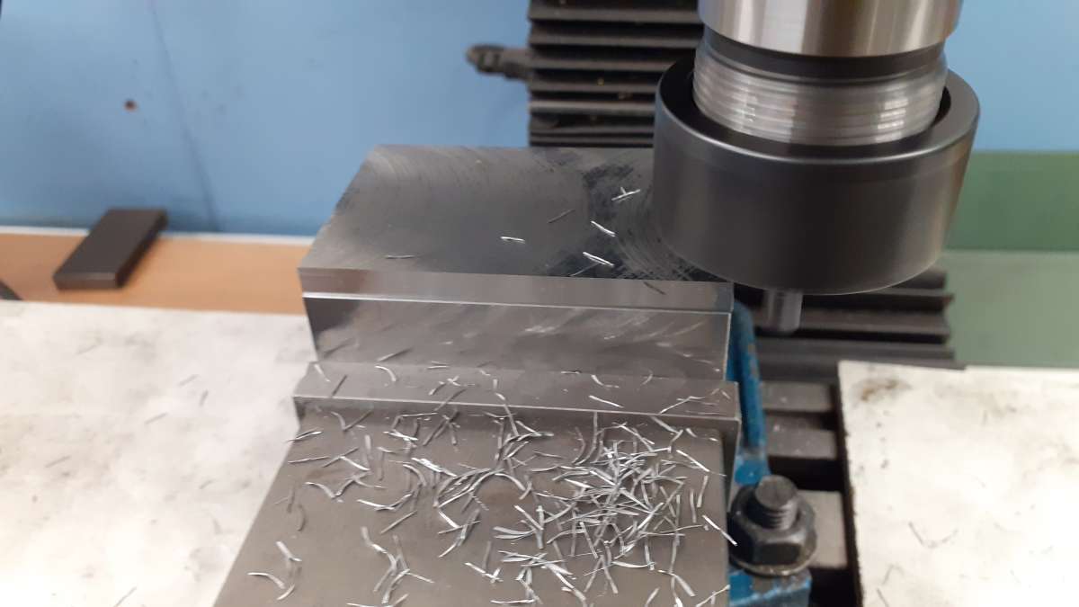

            The combination machines are not the most rigid so you will have to take light cuts, yes it will possibly take longer than a deep heavy cut but you need to work with what you have got and learn to make the most of it. So fit a smallish say 6mm dia cutter spin it up to cutting speed (2000rpm if the head will run that fast), use as much of the side of the cutter rather than the end and move the work say 0.5mm per pass.

                      It’s when the mill seems to be self feeding and the cutter effectively tries to climb out of the cut as it pulls it’s self along. It can be a quite violent process if you are taking a relatively large cut that will find any slop in the setup or mill that’s a bit wobbly.
                      #689953
                        Climb milling is where the direction of the feed may cause the work to be pulled into the cutter or the cutter try to “climb” over the work.
                        1600 should just be OK with a 5/16″ HSS cutter, this is a 6mm at 2000rpm using 6mm of the side and stepped over 10% of the width = 0.6mm. Conservative feed of 120mm/min. If yours is 4-flute then 150mm/min would be a similar loading @ 1600rpm or drop to 1000rpm and feed at 80mm/min. Nice chips are what you want not dust.
