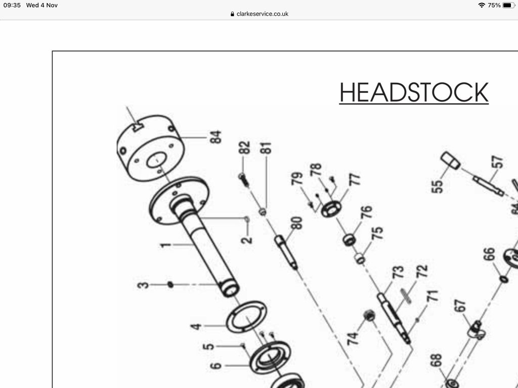

        Hello, does anyone know of a supplier of an off the shelf chuck adaptor faceplate to fit the Clarke cl430/500 lathes? Clark’s own 4 jaw chuck is stupidly overpriced (in my opinion) but its oddly sized at 130mm diameter with a 100mm mounting recess so slightly different to the common Chinese chucks which are all 5mm smaller on both. I’ve searched all the popular home workshop supplier websites but haven’t found anything’s so any advice appreciated, thank you.

            I'm not sure what Bazyle means by a screw thread, but I imagine you need a simple round with opposing male and female registers, and three peripheral through holes for the mounting studs. I've never seen such a thing, but it would be straightforward to make for someone with precision skills. I managed to find a four jaw on ebay, so you may get lucky.
            #505239
              Somewhat bewildered [not only by Clarke’s price for the chuck]
              The documentation shows three holes on the spindle nose plate … but the four-jaw has four fixings
              … do they include an adapter plate, or is this just artistic license ‘for clarity’ ?
              Personally, I would be tempted to reduce the register diameter, to enable fitment of an alternative four-jaw, and then make a spacer ring [ like a circular-saw blade ‘reducer’ ] for the existing three-jaw.

                The Clarke four jaw has three mounting studs in the back face..
                #505241
                john halfpenny
                  @johnhalfpenny52803
                  The Clarke four jaw has three mounting studs in the back face of a mounting disc, the front of which has a 75mm male register to engage the chuck body. The front screws hold the body to the mounting disc. As I suggested, this may be the best way of adapting to a different four jaw. For completeness, the Clarke four jaw currently advertised has the four mounting screws on a much larger pcd than mine
                  Edited By john halfpenny on 04/11/2020 10:01:06
                  #505242
                    Thanks for the clarification, John yes
                    Published photos made it appear [to my innocent eyes] to be front-fixing, with an [unspecified] adapter plate
                    https://www.chronos.ltd.uk/product/4-jaw-independent-chuck-for-cl500-430-2/
                    … I would still advocate modifying the nose.
                    Edited By Michael Gilligan on 04/11/2020 09:48:03

                      Thanks for all your replies and alternative solutions. I think Clarke must keep theirs vague to stop others copying it!
                      #505304
                      not done it yet
                        @notdoneityet
                        Three bolts secure the chuck backplate to the lathe spindle (on its spigot). When the spigot (for the chuck) has been cut, it will be perfectly central for the 4 jaw to be fitted over and the four holes for the chuck bolts drilled and threaded. All parts suitably marked for future assembly in their rightful positions should ensure concentric chuck running, if ever removed (only for balanced running with a 4 jaw, of course). Done it 25 years, or so, ago.

                            I have a CL500 M lathe and want to replace the 3 and 4 jaw chucks with a collet chuck. does anyone know if Clarke do one? or can anyone tell me the PCD of the boltholes that hold the chucks to the spindle flange?

                                    My clip of the diagram came from here: **LINK**
                                    https://www.clarkeservice.co.uk/technical_information/metalworking/cl430-500m_tech.pdf
                                    … and that’s pretty-much all I know about them
