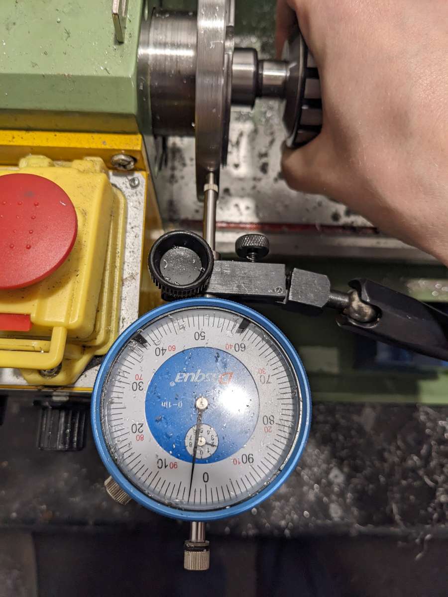

                              I checked my spindle today given the ain’t broke don’t fix it comments which are extremely valid. I don’t own a tenths indicator yet and there’s nothing noticeable axially but theres about 8 thou of lateral play with my just wiggling it. For note I’m 59kg so I’m not able to apply excessive pressure on the spindle.

                                I’m with those who would say leave well alone but  8 thou radial movement on a lathe spindle is waaay too much and needs investigation. Are you sure that you’re measuring bearing clearance? If so the bearings are in poor condition. I don’t think that just adjustment of axial load is the cure for journal bearings.

                                  If you are actually getting 8 thou movement, then that is not good, there may be some adjustment, I’m not sure myself. That much radial play will not need any measuring equipment to detect, just lift the chuck and it will rattle. To remove and replace these bearings, a hydraulic press and another lathe to manufacture removal and replacement tooling would be required to have a chance of doing it properly.

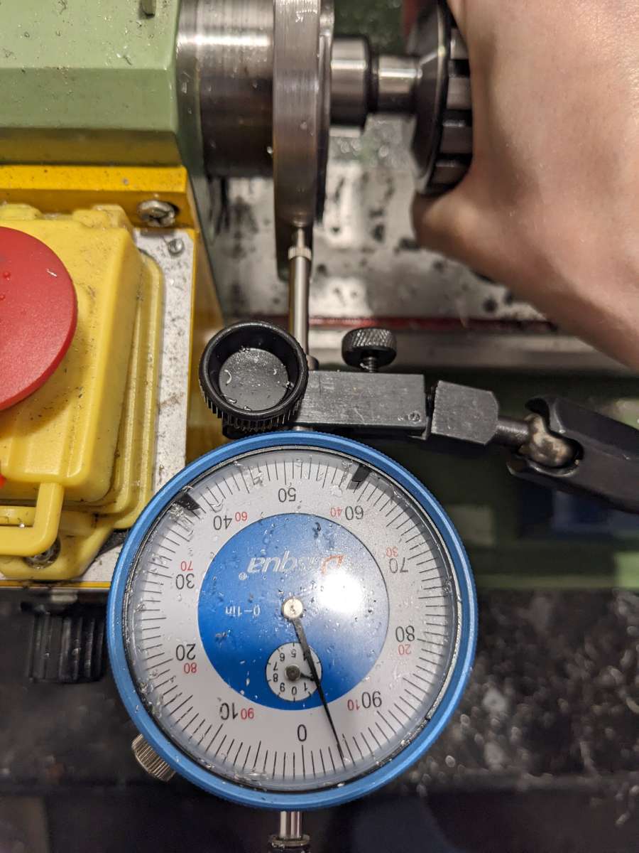

                                    Here are some photos to illustrate the issue. Not to make excuses but I do have the Jacobs chuck in so that is giving a little leverage. I’m not applying what I’d consider “excessive” pressure, mearly gently leaning my body while holding it. I zeroed the indicator before the test.
                                    PXL_20240331_191730455PXL_20240331_191721956
                                    #723580
                                    old mart
                                      @oldmart
                                      Have you got the indicator mounted on the toolpost? Stick your finger between the spindle and headstock, that much movement should be easy to feel.
                                      #723584
                                      Matt T
                                        @mattt
                                        <p style=”text-align: left;”>Mounting the indicator on the toolpost and repeating the same test gave a reading of 1 thou each way, much better. Previously I had it on the chip tray. I did put my finger between the headstock and spindle but couldn’t really feel significant movement.</p>
                                            Have yo
                                            Ideally, mount it on the headstock, even at 59kg you can put some flex into the bed.
                                            If you still get movement, consider adjusting the end float.

                                              If you want to measure any movement on the spindle, mount your indicator on the head stock. Now you probably measure more bed flex than play.
                                              #723637
                                                That was not bed flex it was the chip tray flexing.
                                                A bit of adjustment of the preload on the bearings as Ketan mentions should reduce the 2 thou movement a bit more. Try that before considering a change of bearing.
