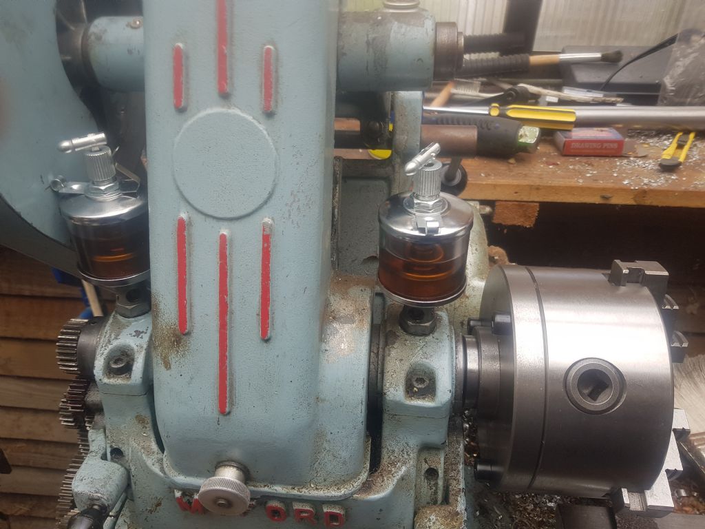

                                          brian jones 11
                                            @brianjones11
                                            Posted by vic newey on 23/07/2021 15:14:00:
                                            I ordered one from China, a 1/4 BSPP thread, it was an experiment to see if it would get stopped at customs for VAT etc. it only cost £4.39. rather strangely it arrived today from from Germany! however it's the wrong size, more like M14 so way too big for my lathe. Apart from that is appears very well made. I could make an adapter easily enough but for the price it seems very good.
                                            I took a punt on one of these a week ago, it arrived today (from a uk supplier?) cost £9. It is listed as 14mm thread, no good for the Myford – too big, but I expected to make an adapter, easy enough as the pic shows BUT
                                            here's the shock
                                            I unscrewed the original fitting with the sight hole and same for the leaky myford one – sight plastic cracked – and to my great surprise the old Myford fitting screwed straight on to the new oiler
                                            So refitted, all done and dusted in 10 mins and drips as needed
                                            What a result
                                            cw £30 ea from ykw
                                            So I have immediately ordered a second one
                                            Its not often something works out like thislaugh
                                            hope this helps
                                            OBTW  FYI
                                            looking closely at the original myford oiler and its thread socket, i thought it was a bit small for 1/4 BSP and sure enough it turned out to be 3/8" BSP 28 tpi, quite a lot finer than 19tpi as above core 0.32 id and od 0.379 thats my old ML7. bit it didnt matter as i reused the old adapter
                                            Edited By brian jones 11 on 07/08/2021 10:25:33

                                              Keith Long
                                                @keithlong89920
                                                Brian – I think the thread that you're struggling with is actually 1/8in BSP – the usual figure given for the od is 0.383 in. x 28 tpi. It's a fairly common thread, even my cheapo tap and die set included it.
                                                #557446
                                                  Yes 1/8" BSP is the one and also 55deg thread form not the 60deg of UNF that you mixed up the other day. So no "dirty tricks" again by Myford just not knowing your threadswink 2
                                                  A quick look at the Myford site will see that they sell their oilers with 1/8" BSP threads

                                                  brian jones 11
                                                    @brianjones11
                                                    Both new oilers in place, great improvement on old ones which leaked and didnt drip properly20210813_164911_001.jpg
