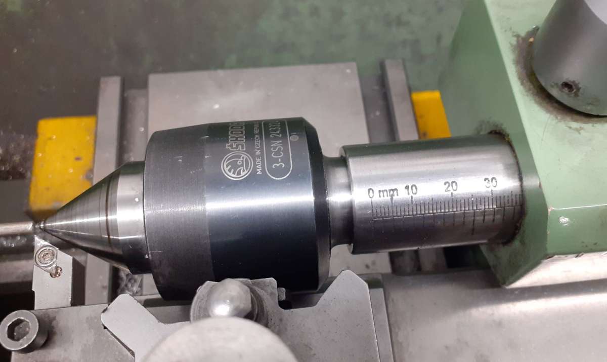

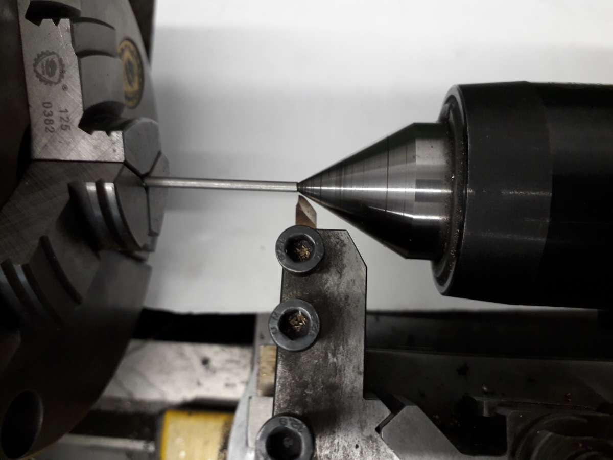

      Though with the right tool for the job in a QCTP there is no need for skinny revolving ctrs, DCGT will provide pleany of clearance and allow turning 2.5mm dia with a standard ctr
      valve 4
      And for those that still want to use HSS, then a suitably ground tool and QCTP holder will allow similar size work with a standard revolving ctr
      20190524_183000

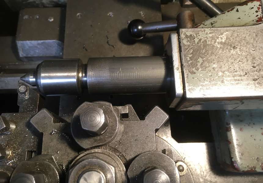

            I’ve long felt that the D series inserts are a better general purpose choice for Home Workshop and Model Engineering than the W or C series often advocated. As Jason says access is better and a typical home worker can’t really exploit the extra strength of the bigger inserts. The extra corner of a W series may be more economical I suppose.
            I do larger work and went for C series to handle the jobs that needed inserts many years ago for reasons I no longer recall but presumably made sense at the time. Probably cost and availability as W were somewhat premium in those days. Over the years D series have gotten much more robust and capable so if I did a do over right now that’s almost certainly the way I’d go. But HSS would probably still be my workhorse.
            Given the relative costs of modern inserts against the expense of a proper set up to grind HSS, something rather more workmanlike reliable than a cheap import bench grinder with iffy tool rest, its arguable that its fiscally viable to go all in on inserts from the beginning. Most especially if you cheap out by going DIY block switching rather than paying for a QCTP with a sensible number of holders. Insert carriers repeat so well that there is no need for the, expensively provided, height adjustment ability of a QCTP.
            Jason’s second picture shows an extended toolholder. Sometimes a necessary evil but absolutely not one of my favourite things. (I’ll go a long way with workarounds before digging mine out and blowing the dust off.) The tool tip inevitably has to divine its support at considerable distance which offends my engineering sensibilities.
            But without an extended holder you can run into this sort of problem where the tailstock barrel needs excessive extension to clear the tool post block. It may be instructive to compare this picture of a D series insert and revolving centre on my small lathe with Jasons similar offering above. Clearly shows the effect of different combinations of components. Jason needs far less tailstock extension than I, he can actually use rather less than in his picture.
            Tailstock Clearance 1 R
            As shown my Smart & Brown 1024 needs 2 1/2 inches of extension to clear the Dickson S2 block with a D series insert carrier pulled right to the back of its holder. Poor practice as the clamp bolts aren’t central. With other tooling approaching an inch more may be needed. The hefty 1024 copes just fine but many smaller machines don’t have the tailstock strength or barrel travel.
            This sort of clearance issue is easily overlooked during purchasing leading to unpleasant surprises later.
