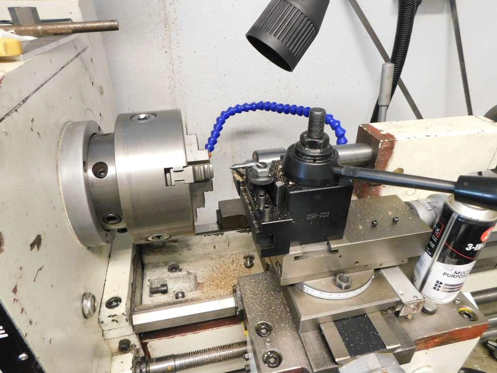

                  MarkS
                    @idriver
                    On Fulmen Said:
                    My bad. Please ignore.
                    As for general advice I will always recommend a 40pos “Multifix” system, especially if you have plans for a DRO.
                    Thank’s for that, I hadn’t come across the MultiFix systems, I will have a look.
                    #788974
                    MarkS
                      @idriver
                      Thanks, I didn’t know that about using smaller HSS, I just assumed because mine will take 12mm I had to use 12mm. Every day is a school day when you are starting afresh.
                      #788986
                      MarkS
                        @idriver
                        On Diogenes Said:
                        I much prefer the the ‘wedge-type’ toolpost to the ‘piston-type’; The wedge type uses a sliding tapered gib to pull the toolholder tight onto the body, the other type uses a piston to push it out onto the dovetail (go figure).
                        The one I have is this;
                        https://www.arceurotrade.co.uk/Catalogue/Machines-Accessories/Lathe-Accessories/Tool-Posts/Model-111-Quick-Change-Tool-Post
                        Thanks for that, yes I am leaning towards the wedge type. Although as I understand it, the only one that will fit the lathe straight out of the box is a piston type. Something to do with a fixed bush at the base of the bolt that attaches the QCTP to the Top Slide. (I assume the bush or shoulder is part of the top slide). I have however come across a video where the owner of an older DB10 has machined a sleeve for the bush and bolt to allow a standard wedge type QCTP to be used. I won’t know the setup for sure until I take delivery but looking at the exploded drawings in the manual it does appear to have a bush.

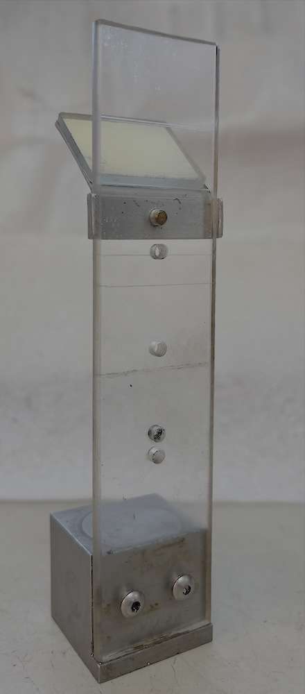

                                                Clive Foster
                                                  @clivefoster55965
                                                  The optical type centre height gauge works very well and is probably the easiest to make.
                                                  Fundamentally it consists of a transparent plastic blade (perspex?) thick enough to be stable and not bend standing upright on a suitable base with a line at centre height scribed across it on both sides. The tool height is set by bringing the gauge very close to the tool tip, almost touching, and comparing its height to that of the scribed lines whilst looking straight at them so only one line is seen. Due to the thickness of the plastic blade there will be a parallex error if you are not looking straight at the lines so two lines will be visible.
                                                  The lines are best scribed directly on the machine using a sharp centre held in the headstock or tailstock taper. A flat plate across the lathe bed will be needed to slide the nascent gauge across the centre. Either retain the plate to stand the gauge on when in use or chop a bit off and add it to the base block so as to make up the error when the gauge is stood on the lathe bed. That wasn’t the way I did mine but its a better method if just making a basic version.
                                                  Mine has a blade about 1 1/2″ wide by 4 mm thick on a steel base about 1 1/2″ cube. Size chosen by the usual “got a couple of bits that will do” method. In practice a fairly sensible size but, given the choice, a 6 mm thick blade would be better as it enhances the visible parallex so its easier to be accurate.
                                                  Mine is significantly more refined than the basic version having extra lines so it can be used on both bed and cross slide of both my lathes. It also has provision for a mirror mounted at 45° on the back side allowing it to be used by looking down from above so the gauge can be some distance from the tooltip. Theoretically handy if needing to set-up a new tool mid job where simply standing on the bed with the tool almost touching is impractical. The guy I stole the idea from said he normally used the mirror system but I prefer to bend down and look from the front.
                                                  1) Optical Tool Gauge Front
                                                  The angle of the camera shows up the parallax error on a couple of line pairs.
                                                  With 20/20 hindsight the extra features beyond two sets of lines to work of the beds of two machines are of little value in practice. I’ve never done anything that the basic device couldn’t have handled adequately, although perhaps with a bit more trouble.
