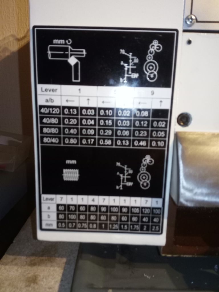

    Ian Skeldon 2
      @ianskeldon2
      screw cut.jpgHi,
      I have machined an internal bore to the correct diameter and depth, cut an overrun groove at the blind face, all without drama. Then I came to the task of cutting 14 tpi.
      None of the diagrams make any sense to me, certainly not what I used many years ago, I will upload a (poor quality) photo showing the lathe instructions for screw cutting to see if anyone out there can enlighten me.
      Thanks,
      Ian
      Edited By Ian Skeldon 2 on 22/07/2018 21:39:56

        #363417
        Ian Skeldon 2
          @ianskeldon2
          screw cut 2 (2).jpgA couple of slightly better photos;

            Hmmm, looks to me like the lathe is designed to cut a selected range of metric pitches. If you're prepared to accept a sloppy thread 14tpi is 1.814mm pitch, so you might just get away with 1.75mm over a short length. Otherwise I'm afraid you might be up the creek watching the paddle float away downstream!
            On a more positive note there may be undocumented gear combinations that are closer, or other gears that may work better. But that is beyond my experience. I expect those with better knowledge of the intricacies of same will be along soon.
            Andrew
            #363423
              Top diagram gives feedrates for general turning nd facing under power feed (that's what the arrows indicate)
              Bottom diagram is metric pitch along the bottom row.
              A and B are the changewheels in the diagram, a selection of ratios at left in the top diagram.
              Ratios are given in rows 2 and 3 of the bottom diagram, so its different to the top one – rather confusing!
              Presumably 1,4,7 and 9 are some of the gearbox selector positions, with other positions giving further options.
              #363430
                Without knowing the 7 gearbox ratios, spindle driver and lead screw pitch it would be hard for any of us to give a gear combination to get to your 14tpi. If you want closer than Andrew's 1.75mm pitch suggestion then you need to sit down and work out what is going on with the gears, levers and gearbox ratios and come up with something that gives a closer match.
                Quick look and if you could get a 58T gear then put that in position B, 105T in position A and lever in No1 that would give you 1.810mm. A 3D printed one would go or buy a cheap one from one of the bearing suppliers.
                IF you had a 55T in the gear set then 100/55 = 1.818mm which is quite close, lever pos 1 again. It is actually quite an easy layour to work out whats needed just convert the tpi to a mm pitch and see what fits in lever pos 1
                I see that Chester only list it as giving metric pitches so you won't ghave got a 63T in the set of gears supplied.

                  Posted by JasonB on 23/07/2018 07:17:15:
                  This is the lathe for those not familiar with it.
                  Pardon my innocence, but, what is Chester's distinction between a closed gearbox and an open one … and which does Ian's lathe have ?
                  #363435
                  Martin Connelly
                    @martinconnelly55370
                    The two images on the linked web page have different gearboxes. I would suggest image 1 is a closed gearbox and image 2 is an open gearbox. Closed gearboxes can have oil in them for lubrication. Open need regular lubrication or drip oiling.
                    Martin C
                    #363436
                    Les Jones 1
                      @lesjones1
                      With a ratio of 1:1 for A to B these are the feed values for the various gearbox settings. (Worked out from the posted list of settings.)
                      1 – 1.00mm
                      4 – 0.80mm
                      5 – 0.75mm (*)
                      7 – 0.667mm (2/3 mm to be exact.)
                      9 – 0.60mm (*)
                      (* These are calculated from the fine feed values but the ratio is slightly different for different table entries.)
                      Assuming that only gears A and B can be changed and that the gears shown in the table are the only ones available the best setting I can come up with is gear A 120 teeth, gear B 40 teeth and gearbox position 9. IF the feed for position 9 is exactly 0.6 mm then this will give a pitch of 1.80mm (14.11 TPI) Before cutting the thread I suggest measuring the feed by turning the chuck exactly 10 revolutions and measuring how far the carriage modes with the DRO or digital calipers.
                      Thanks to Neil for explaining what the vertical and horizontal arrows mean. (I was thinking it was another gearbox setting.) and to Michael for posting a picture of the lathe.
                      Les.
                      Edited By Les Jones 1 on 23/07/2018 09:39:55

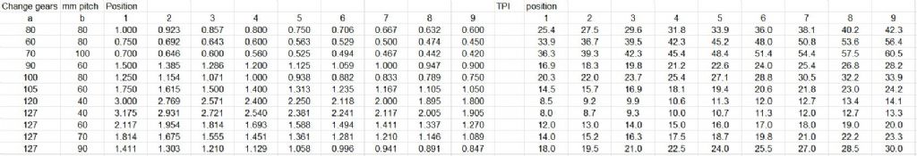

                                    Martin Connelly
                                      With the information available the available ratios without using the 127 tooth gear is as below. Nearest to 14 TPI is 1.8mm pitch with a=120 b=40 lever in position 9. I would advise do not disengage the half nuts when cutting this thread. Is the 127 tooth gear a duplex and if so what is the tooth count on the other half or does it go in place of the 100 in position a? If you put a=127 b=70 and lever in position 1 you should get 14 tpi. Once again do not disengage the half nuts. Test the thread by scratching a bar before cutting.
                                      Martin C
                                      #363493
                                        Does it come with a 127T? did not see one mentioned
                                        #363497
                                        Martin Connelly
                                          I saw Larry mention he had a metric to Whit change wheel and thought it was the OP. If one is available the tables are as shown.
                                          Martin C

                                              Sorry, no. This is all based on the pictures and information in this thread. That is why I suggested a scratch test, there could easily be errors.
                                              Martin C

                                              Ian Skeldon 2
                                                @ianskeldon2
                                                Hi all and thank you so much for the help.
                                                My lathe is the one with the single gear selector knob and nine holes selecting different ( spur ?) gears.
                                                When I bought the lathe it was advertised as being able to cut both metric and imperial threads.
                                                Sadly it looks as though Andrew and his description of my situation may be right. The thread needs to be 14tpi as the internal chamber will be subject to around 100bar air pressure and there is not enough material on the male component to turn it down and cut a metric thread on it, even if there was I would have to start this piece all over again with a smaller internal bore, oh bugger.
                                                I called Chester to ask for advice, in short, I wasted the cost of the phone call, they didn't have a clue. So although my lathe cuts very true it will probably have to go at some point in the near future, to make way for something more capable.
                                                Once again my sincere thanks to eveyone that tried to help me out with this.
