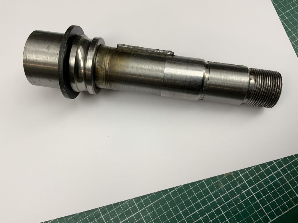

      I’m stripping down my mill to replace the bearings and fit a belt drive. The spindle is out but the key for the plastic gears is firmly stuck in the keyway, it needs to come out to remove the inner race from the bottom bearing. Not shown on the assembly drawing is the black disc behind the bearing race, I assume this is a spacer. Is it safe to put a tube behind the disc and whack it? And what’s the best way to get key out, I can’t grip it with a wrench and it doesn’t shift when hit with a chisel. Any advice welcome.Conquest Mill Spindle.jpeg

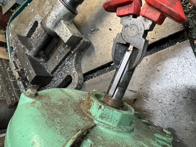

                  I always use a pair of side cutters pliers to remove keys….never fails. Use pliers parallel with the shaft grip the sides of the key and lift it out…

                    As this photo
                    Key removal :jpeg

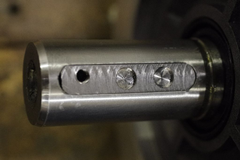

                                  This was the key fitted in the new three phase motor for the Tom Senior light vertical. The pulley had to be bored to a larger size and there was not enough wall thickness to add a keyway. So I removed the new key from the motor shaft and milled it down flush and put 2 locking grubscrews in the pulley, adding the location bores in the key for good measure. The little screwhole is a 6BA to jack out the key if required. Any size of screw would be able to jack out the key, and do not worry if the end of the drill just touches the spindle. The jacking screw would have to have the first couple of threads removed, as the tap will not reach the bottom of the key, having a plug (bottoming) tap would come in handy here. Your key will be a straight one as the spindle is hollow.
                                  Try Rob's milling vise method first.

                                        Many thanks to all who offered advice. The answer is … none of the above.
                                        The key was 5mm wide and deep and very soft, it was no longer required because I was replacing the geared drive. Side cutters give an incredible grip – what a good tip – but I still couldn’t budge it. Drilling and tapping holes didn’t work for me either – the 6BA jacking screws just sheared. I tried M4 and realised that if I drilled just shy of the 5mm about 5mm in from the ends of the key, I could knock the small end off with a chisel, when I did that, I could whack it out without damaging the spindle. After that I could easily knock down and remove the inner ball race and the spacer (which is metal)
                                        I should say that I did not “destroy” the bearing, is just fell apart when I gently used a screwed rod to wind the spindle out of the casting, it must have been very worn – hence new angular contacts.
