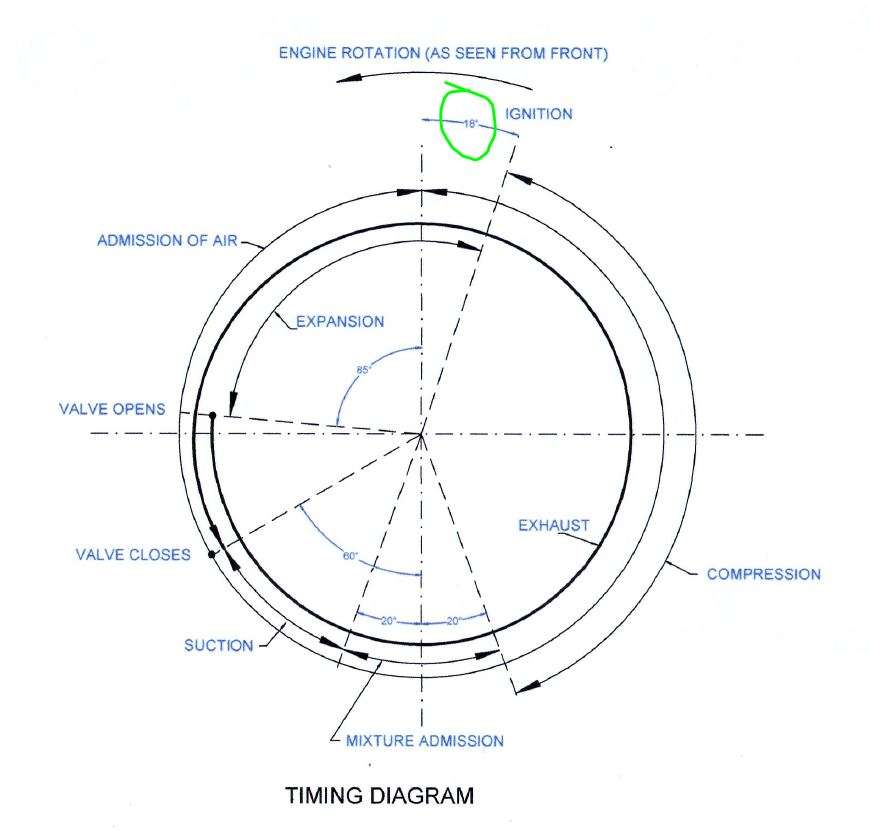

      Having built a 9 cylinder rotary Gnome to Les Chenery drawings I am now having problems starting the engine. I am using a MiniMag ignition system with commutator ring and conventional points. I seem to be getting a good spark with firing set at about 18 degrees before TDC. I am assuming the timing is not super critical to get it firing, hopefully being able to adjust a few degrees either way once started. I have tried various fuel setting, even turning the engine with fuel cut off for some time to try and dry out the plugs. Likewise I have primed each cylinder head with a small amount of petrol (syringe) via the open exhaust valve to no avail.
      Compression seems good on each cylinder and valve timing appears correct. Not sure where to start. I feel the ignition is the problem but not sure.
      Has anyone got experience of a 9 cylinder Les Chenery Gnome and can point me in the right direction?

        Absolutely no experience of 9-cylinder engines here … but instinctively, 18° seems like too much advance.
        Hopefully someone wiser will advise.

          Try 10 deg advance.
          it’s possible the volts are too low to fire the plug under compression or conversely compression is in fact too low.
          This is where an old skool neon timing light might help.
          #765343
            The 1/3rd scale Gnome is timmed at 18deg BTC so you should be in the right ball park.
            How are you activating your points to get the correct firing. Also most of the electronic ignitions fire the opposite to a set of points when the contacts close

              Firing order wrong/reversed maybe? Is there any sign of ignition at all?

                  Jason should know but to me 18* is far to early. The original gnome had a strange induction where over rich mixture was drawn in and brought to a combustible mixture by the ” exhaust ” valve staying open to allow more air in ( or something like that), followed by compression and ignition. In the manual the mixture is described as incombustible – initially ! The fuel was dribbled into the hollow mounting tube that fed the crankcase. Are you using some form of carb ? Noel.

                      Noel, it does sound a lot but as I posted above the larger 1/3rd scale one gives 18degrees TDC so would seem to be in the right ball park for the 1/5th scale version. Like a lot of the IC engines I build the 1/3rd scale one has adjustable advance and retard so easy to try a few different angles.

                        Yes Jason, and as I sit here thinking what the engine is, the mass of the rotating cylinders would allow for early ignition and less risk of firing backwards. Thank you. Noel.

                          I thought that the Gnome Monosoupape was so called because it had only the one (Exhaust) valve for each cylinder, with mixture being fed in via the hollow crankshaft, with the inlet valve being within the piston.
                          This arrangement, couple with a huge exhaust valve clearance, and inhaling some air via the exhaust valve, night account for an unusual ignition timing, compared to conventional four strokes.

                            The earlist Gnome had the complex, counterbalanced “automatic” inlet valve in the piston. Later versions had inlet ports in the lower end of the cylinder (similar to 2 stroke engines). Both used extended exhaust valve opening to add air to the over-rich mixture drawn in through the hollow crankshaft.
                            But none of this helps Charlie to get his engine running…
                            Charlie – have you tried using an easier to ignite fuel? I have used butane gas to get stubborn engines to start. The advantages of butane are:
                            1) it’s a gas, so you can’t damage the engine by flooding and hydraulic locking, so safe to use an electric starter.
                            2) it has a wide range of combustibility in air, so much less sensetive to accurate mixture control and low compression.
                            I use a butane torch, the type with a disposable cylinder – not lit! Turn on the gas and point it into the carb intake with the petrol supply off. If the engine starts on butane, turn on the petrol and turn off the gas.
                            I have found that once an engine has started on butane and successfully switched over to petrol, it will subsequently start on petrol.
