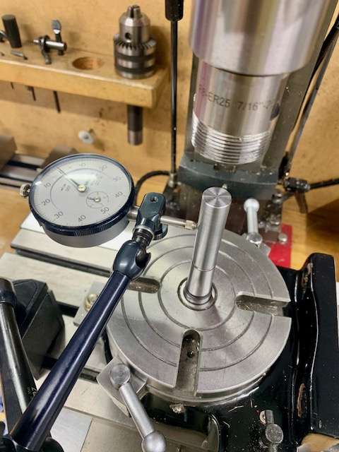

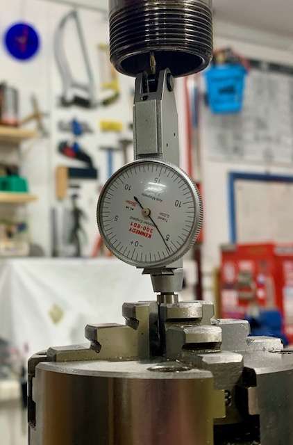

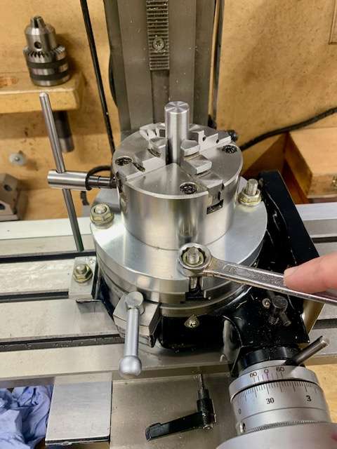

      All, what’s the best way of centering this R/T chuck under the mill spindle please?
      I’ve centred the R/T itself fairly easily using the dti into the central taper, rotating the spindle and adjusting the x/y table until I get a zero reading all the way around.
      In the past I’ve resorted to clamping a chamfering tool or something in the chuck, clamping the protruding stub into a spindle collet, and tightening the chuck-R/T bolts. I can get within 0.004” like this, but no better.
      If I use the dti rotated in the spindle, I can only adjust the chuck by tapping it in x/y in turn with a soft hammer, but unlike using the x/y table, tapping x invariable screws up y.
      Also, is there a good way of keying or dowelling the chuck to the R/T table such that I don’t have to do this setup again? It always takes ages, and is never that great in terms of accuracy.
      Any advice welcome!

            I’m not sure how to say this without it sounding patronising, but please believe me … it’s one of the most important things I learned about using the Rotary Table:
            Never lose sight of the fact that centring the R/T under the spindle is one thing, and using the mounted chuck [or any other fixture] to position the workpiece correctly is a completely separate activity.
            Unless you are intending to produce offsets, the R/T must remain concentric with the machine spindle.
            0.004” is not a good number … so I suspect that you are somehow allowing these adjustments to conflate.

                Thanks Michael. As I said, the R/T is centred, and to be clear, I’m not trying to adjust the chuck and R/T simultaneously.
                Im asking how to centre the chuck on the already centred R/T.
                I didn’t design or make the 4 bolt/slot mounting method, it’s what the chuck/R/T came with.
                If the best method involves making some minor mods or setting tools, that’s fine.

                  If the play for setting true exists in the chuck mounting to the backplate, then I would consider four blocks fitted to the backplate such that you could pass a bolt through each to bear upon the chuck.  If the play exists between the backplate and the R/T I would have to think about it.  If not enough play exists in either of those then, no doubt, you’re out of luck without altering the backplate.
                  Mike

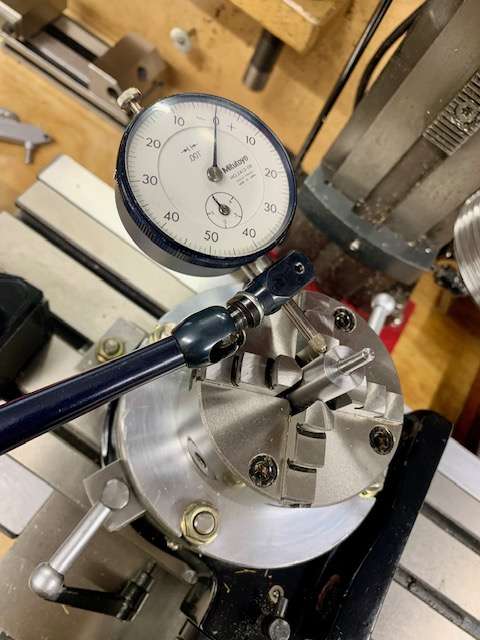

                            That’s what I’m doing, but tapping the mount plate and moving it in only x or only y is impossible on my setup, so I – literally – go around in circles correcting one axis and simultaneously introducing an error into the other.

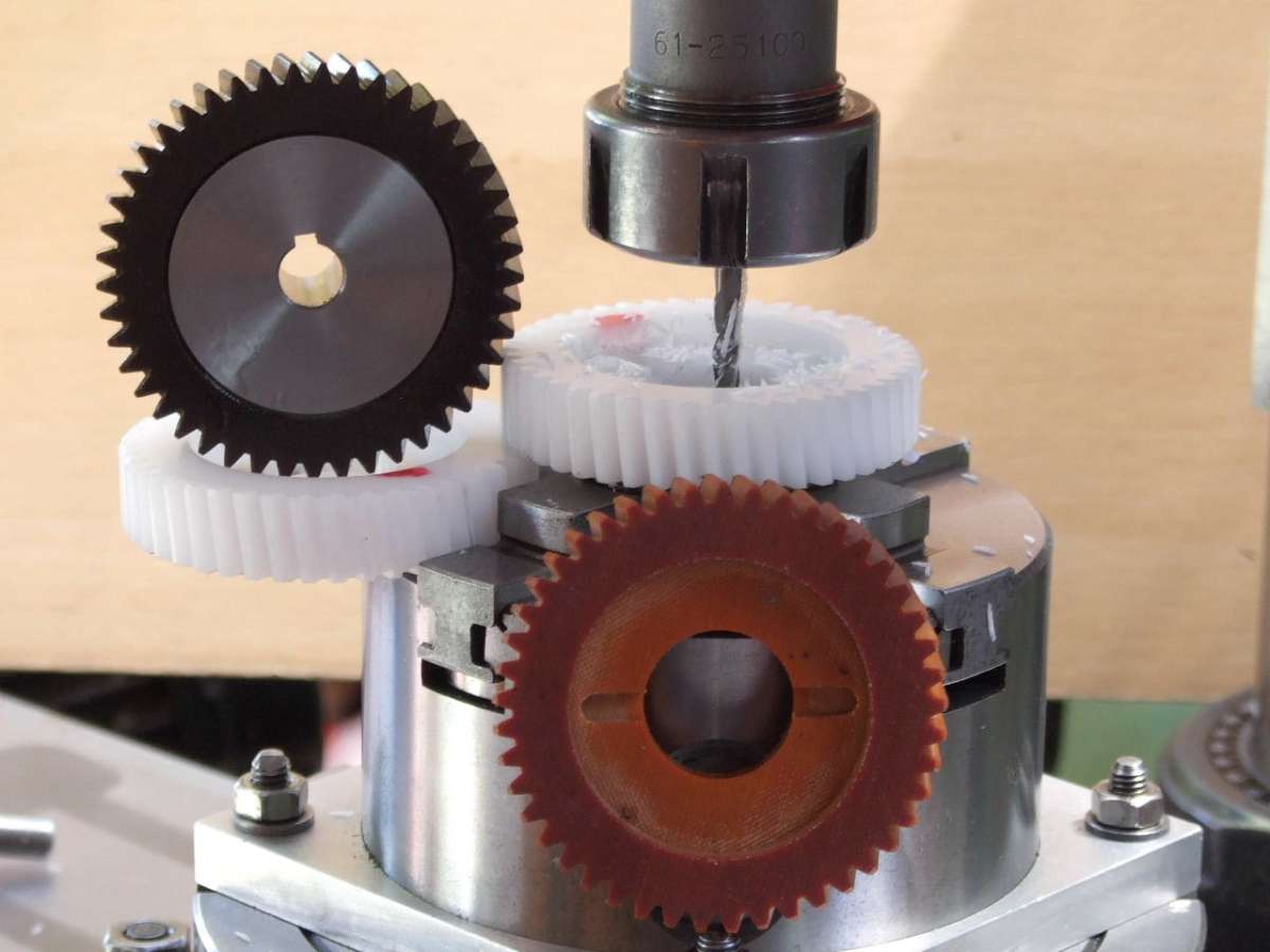

                                This is the only photograph of the Rotary table chuck adaptor plate that I made when I had my Emco FB2 that I have.
                                Photo 12 Machining the Keyways in the Delrin Gears
                                The Plate was centred in the 4 Jawed Chuck and a register was turned to fit closely the register in the back of the Chuck. At the same time a hole was bored and reamed in the centre of the plate.
                                A Top Hat shaped Spigot was then turned to fit both the Rotary Table location diameter, (the Brim of the Hat), and the bored and reamed hole in the adaptor plate, (the body of the hat). This can be made a press fit if desired but I chose to leave mine to be a nice sliding fit. The Chuck can then be mounted directly to the table if required, by removing the location spigot.
                                One thing to note is that it helps if the stylus of the clock is on the centreline of the work. This makes setting up the Rotary Table much easier as the stylus of the clock can be used to sight the X & Y positions with reference to the Tee slots. Provided of coarse they are in line with the X & Y axis, which they were on the FB2.
                                Regards

                                  Well, on mine I can’t adjust it – whether that’s a skill issue or a mechanical issue is open to question, but doesn’t help me.
                                  How do you go about adjusting the chuck?
                                  Thanks.

                                    One possibly stupid suggestion! If you rotate the table about 45 degrees from where it is in the photos so that one pair of bolts are along the x axis and the other pair along the Y axis, it should make it far easier to “tap” one axis at a time.

                                      Yep, tried it at both 90 and 45 degrees.
                                      If there’s any slight friction around one of the bolts – or anywhere else on the table-plate interface, it skews the movement.

                                        ^^^ This. Most definitely. The way the chuck plate is set up with slots at 45 degrees in the pic is making a simple job hard.
                                        The other thing is, use a dial indicator with the magnetic base attached to the milling table next to the RT, not dangling from the spindle as in the pic. When you are tapping the chuck to move it, it could be moving the mill table also and give a false reading off that dangling dial gauge. Dial gauge attached to the table will move with the table and still give a true reading of concentricity of the item held in the chuck as the RT is rotated.
                                        And use the “quick method” to set the item gripped in the chuck to run true, same as when using a 4 jaw chuck in the lathe:
                                        Rotate the job through 360 degrees and set the dial gauge bezel to zero at the lowest point of the needle.
                                        Rotate again and note the highest reading on the gauge.
                                        Rotate job until the needle sits exactly halfway between 0 and the highest reading.
                                        Set the dial gauge bezel so zero lines up with the needle.
                                        This is now your zero point to set the job to. Adjust your backplate, (or chuck jaws in the lathe) so each of the four cardinal points, (12 o’clock, 3, 6 and 9) reads zero the job’s good.
                                        It’s amazing how much time and mucking about this methodical approach saves over the traditional random tapping and spinning and needle waving and swearing.
                                        Then once you have the job set to rotate concentrically in on the RT, and your chuck plate bolts tightened up, then you can go back to dangling the dial gauge from the spindle to check the job is centred under the spindle and adjust the mill table position to suit.

                                            I suggest first to check that the table and chuck back surfaces are flat, to the extent that if one (only) clamping bolt is nipped up, it is impossible to slide a 0.05mm feeler under any of the other fixing bolt positions. Check this for all four fixings similarly clamped. Alternative to a feeler, lay thin paper pieces under the non clamped fixings, and check they remain clamped when each single bolt in turn is nipped up.
                                            Assuming this procedure is passed, work as follows. Start by getting down to a few thou concentricity as previously. Now find which axis across a pair of opposite fixings is worse, then nip up lightly one of the other two fixings, leaving all three others loose. Tap the chuck (which will pivot on the nipped bolt) to centre the “worse” axis. Now nip up a bolt in that axis, and loosen the first bolt to do the same in the second axis, and so on. Repeat until you get to full concentricity, which should only take a few more steps, but as good centring is approached start to nip up the other fixing bolts a bit more lightly than the pivot.
                                            This should control things such that only one axis at a time can move. Hopefully final clamping will not result in distortion, but allowance could be made for this too provided it is consistent.

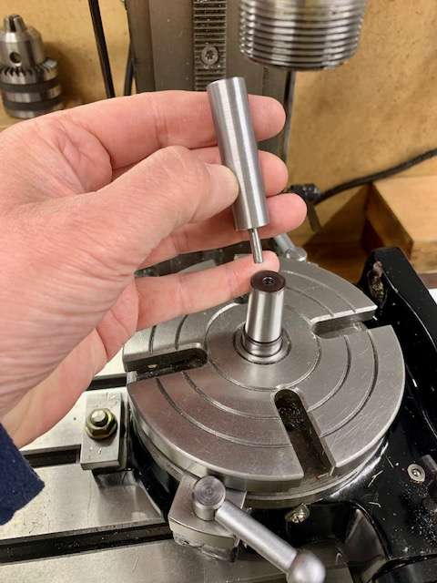

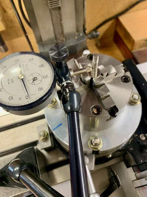

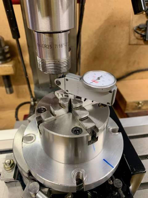

                                              Here’s what I did this afternoon. I got fed up with chasing my tail, and wanted to get on with the model I’m building, so:
                                              Checked the R/T was centred under the spindle. I set the dti in the chuck and put the finger inside the taper (at this point using the chuck as nothing more than an elaborate dti holder). Roatating the R/T and adjusting the mill table got me within less than 0.0005″:
                                              IMG_7198
                                              I found a spare morse taper, and drilled a hole in the middle in the lathe. Then turned a stepped bar that fitted snugly into the hole. I put the taper in the R/T:
                                              IMG_7199
                                              Then checked it ran true with a dti mounted on the table and rotating the R/T. It was pretty much spot-on:

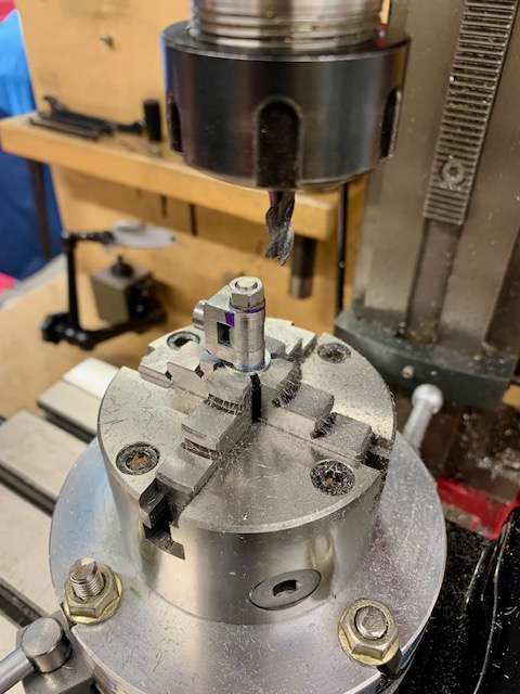

                                              IMG_7200
                                              Then mounted the chuck, after gripping the stepped shaft with the jaws:
                                              IMG_7201
                                              Then upended the removable bar and clamped it back into the chuck, and measured concentricity again. It was fine:
                                              IMG_7202
                                              Then mounted the dti on the chuck, re-checking the mill spindle taper concenticity. This was over 0.004″:
                                              IMG_7203
                                              I also noticed that locking the mill z-axis casued a deflection of about 0.010″ depending on how tight I locked it (I’ve adjusted the gib multiple times in the past and it is the best I can do without it binding or being too loose, so there’s nothing I can do about that). I then re-checked everything from the start making sure that all axes were locked during checking (not that it makes much difference if you happen to want to move an axis during machining). Still ended up with about 0.004″ of error, so gave up and assumed that I just have to live with the thing until I can find a better quality item and scrap this one.

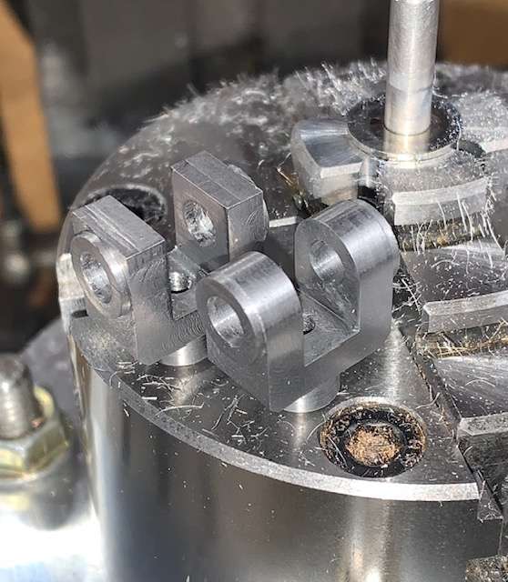

                                              I put the spigot into the chuck for the thing I’m machining and checked that with the dti. Was about 0.001″, so all things considered I just went ahead and did the parts:
                                              IMG_7205
                                              IMG_7206
                                              IMG_7207
                                              Which after all that, turned out pretty well I thought.
                                              Thanks all.

                                                  Is the conclusion then that the ‘bugbear’ is poor repeatability of the mill spindle axis position in relation to the table, once disturbed?

                                                    <p style=”text-align: left;”>Thanks Michael – Was it the first image that befuddled you, or the whole thing?</p>
                                                    I was just running through what makes sense to me:
                                                    1) Centre the R/T to the spindle taper.
                                                    2) Install a setting bar to the R/T and check it’s true to the R/T axis.
                                                    3) Set the chuck relative to the R/T using the setting bar.
                                                    4) Check the chuck axis is true to R/T by gripping a bar and using dti.
                                                    5) Check the R/T chuck stack is true to the spindle taper by mounting the dti in the chuck.
                                                    All was pretty good until 5. I think this is due to inconsistencies with the troublesome z-axis of the mill, e.g.:
                                                    1) Column not vertical, so introduces y-offset if moved.
                                                    2) Gib lock moves head in y-axis.
                                                    So I think the R/T isn’t too bad, and as ever it’s the mill that is introducing the main errors.

                                                      As far as the rotary table goes, when you rotate it you should be able to adjust the chuck to run exactly true (for whatever specific diameter of material is tightened in it at the time. That is the best you can do, and may well be adequately perfect.
                                                      No amount of further adjustment of rotary table/chuck concentricity can correct deficiencies in the mill spindle or Z axis travel.
