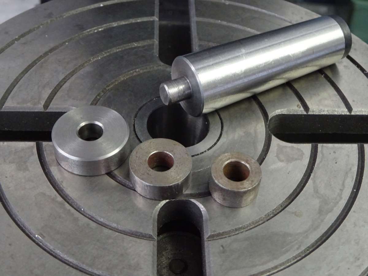

                          As someone who regularly uses chucks on both of my rotary tables this is how I mount them.
                          The Soba has a MT socket, so I turned down a blank MT Arbor to leave a pin. Onto this I can slip various locating rings, the largest of which fits snugly into a hole in the rotary table’s mounting plate. So just put the arbor and ring into the R/T drop on the chuck with it’s mounting plate and screw it down to the table.
                          Photo 173

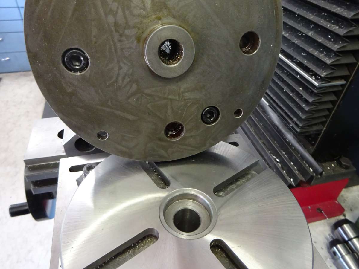

                          The Sieg R/T has a shallow parallel recess above the MT socket and the backing plate supplied has a matching close fitting socket which locate the two.
                          Photo 174
                          Then I just grip a bit of rod or reversed milling cutter in the ER collet, close the chuck jaws around that then bolt the R/T to the mill table and zero dials or DRO and I’m good to go. Works on all three of the Sieg mills.
                          EDIT if you really want to be chasing tenths then leave the spigot of the arbor that is holding the work oversize and mill to final dia on the R/T then it will be spot on to the R/T axis
