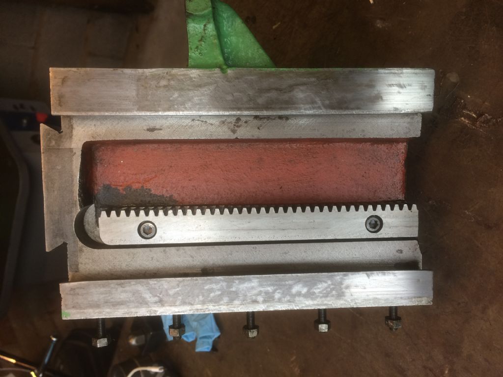

      I've dismantled the beast including the knee off, I've fitted an emergency stop button to the stand for peace of mind. One thing I can't budge is the arbor, drawbar is loose and it sits on a 2MT but a few whacks with a lead hammer doesn't do anything and I don't want to hit any harder. The MT2 on the lathe is a quick tap and it falls out.
      Any ideas well received.
      I've put a pic of the slides on the knee as I believe it shows that they were scraped when built, which the book of words said happened.
