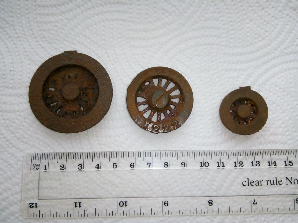

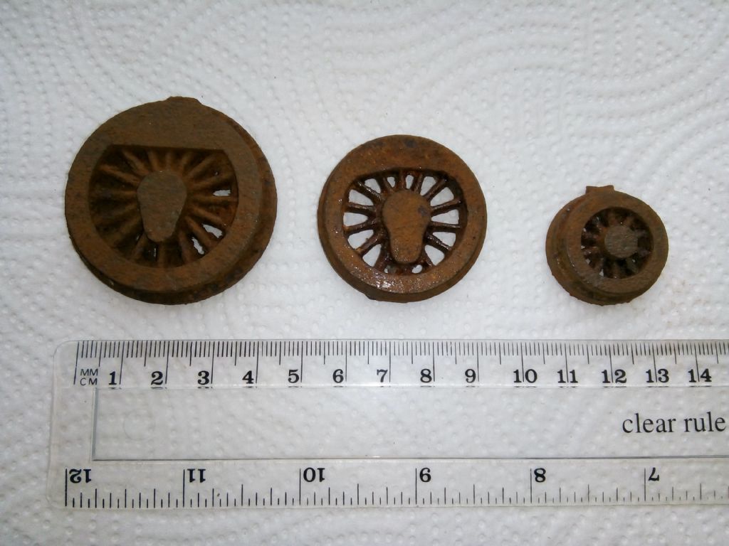

      I have been given some unmachined Cast Locomotive Wheels, and I am trying to identify which locomotive – or Locomotives these are from.
      There are three differing sizes, the larger two wheels are intended as 'drivers'. The smaller wheel is a bogie wheel.
      Here are the technical details followed by photos of the wheels. All dimensions are in mm and are 'as cast'.
      Largest wheel – 43.2 tread diameter, 16 spoke, 6 off. Marked (stamped) 220.
      Medium wheel – 36.1 tread diameter, 14 spoke, 12 off. Marked (cast) X222.
      Small wheel – 23.2 tread diameter, 10 spoke, 4 off. No markings.
      I have searched the website of a couple of wheel 'casters/suppliers' but have been unsuccessful in matching the reference numbers with their current offerings.
      Any help would be greatly appreciated. Best wishes to all.

          Hello Alan,
          The X222 is a Stuart Turner code for an O gauge driving wheel with a finished tread diameter of 35mm (1.375" ). The 220 is probably also a Stuart Turner O gauge driver and short for X220. That is for a finished tread diameter of 35.7 – 41.3mm (1.5625" – 1.325" ). The smaller wheels may be O gauge bogie or tender wheels. They could be X218.

            Many thanks for your reply. This is very much appreciated.
            All the best. Alan.
