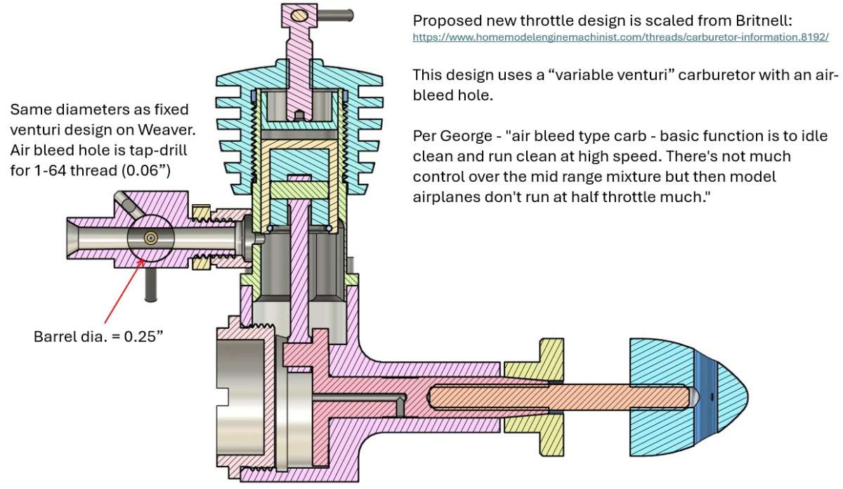

      I found some great information on “fixed venturi” and “variable venturi” carburetors by George Britnell here: https://www.homemodelenginemachinist.com/threads/carburetor-information.8192/#post-90761
      …but I have some questions. I’ve scaled his design to work with the Weaver 1 cc diesel engine. Please look over the photos here and let me know your thoughts. Id like to refine this one more time before I make chips… Thanks!

      #790570
        Most of these small compression ignition engines did not have a throttle, they just ran with the basic venturi as shown in the original drawings. As they tended to be fitted to control line aircraft or tether cars there was no way to activate the carb barrel anyway.
        #790581
        bernard towers
          @bernardtowers37738
          Beat me to it Jason ,overcomplication for no benefit.

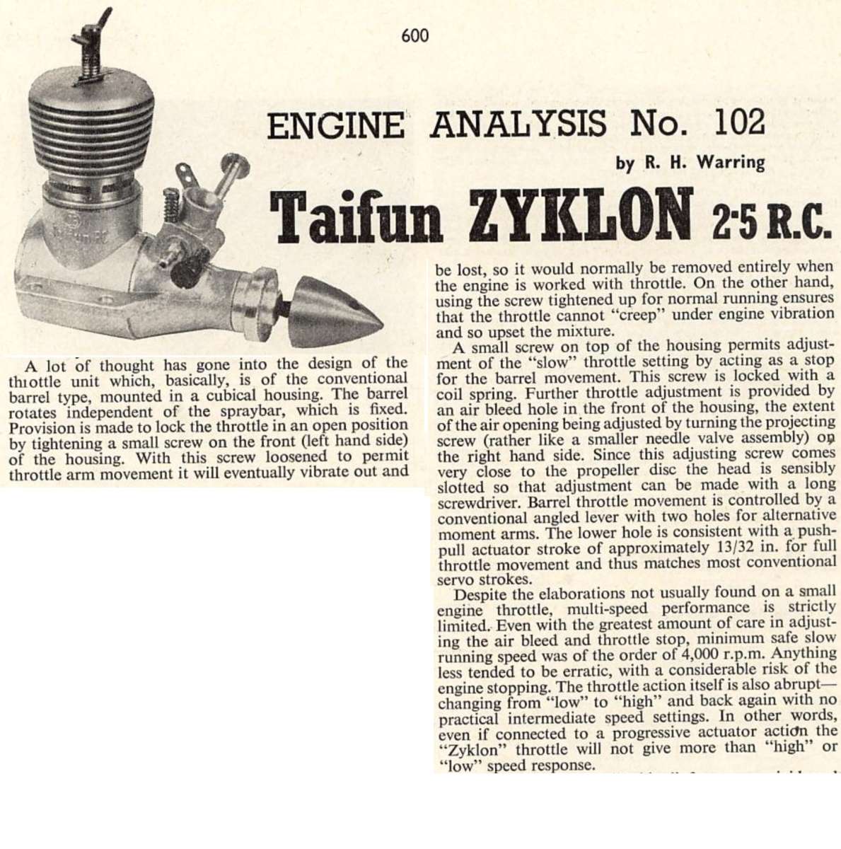

                  I did find this article which talks about a diesel engine that also has an air-bleed barrel carb.  Seems like it just lets the pilot basically switch between high and low RPM.  https://sceptreflight.com/Model%20Engine%20Tests/Taifun%20Zyklon.html
                  tiafun zyk review
                  #790658
                  jimbo7636
                    @jimbo7636
                    Jason, what do you think PAW is up to with the PAW 06 BR and the PAW 06 BR R/C ?  Seems like there is an air-bleed barrel carb on this engine which is a compression ignition diesel.  https://www.eifflaender.com/engines
                    From other articles out there perhaps its just a way to idle the plane if you are using R/C.  Not sure if having a low RPM and high RPM state is worth it.  It would be great if you could also get a predictable transition from low to high.

                      #790690
                        My gut feeling was that the contra piston would need some tweaking to correspond with changes to the throttle but seems it may be worth a try.
                        #790698
                        Ramon Wilson
                          @ramonwilson3
                          Advice doesn’t come much better than from George Britnell but the only thing I can see wrong with the copied info is the statement that ‘when the engine is running it is always running at max speed‘ which could be a little confusing or misleading
                          The running speed of a fixed venturi equipped diesel engine can be varied by combinations of contra-piston position and needle setting from quite slow to indeed the max speed for a given prop/load. As such the revs are more or less constant for a given setting
                          Throttleable diesels have been around for many years and work mainly on varying the fuel/air ratio with a set compression though some have variable exhaust pressure as an additional means too
                          Some diesels perform much better than others when fitted with a throttle – I suspect that is much more to do with the internal timing set up than the carb.
                          #790732
                          Ramon Wilson
                            @ramonwilson3
                            Further to the previous post – most small engine throttle carbs have a bleed hole that can be adjusted for slow speed running. The throttle closed position should also be able to be controlled – usually by an adjusting screw. A basic rotating throttle barrel, whilst restricting the air does not have an effect on the fuel setting so the mixture gets progressively richer as the air intake is reduced. This is usually overcome by having the throttle barrel move laterally as it is rotated to reduce the fuel input. Mostly achieved by a slot set at an angle or helical groove there are many good versions of this type – Super Tigre and OS spring to mind but many others too.
                            #790757
                            jimbo7636
                              @jimbo7636
                              After watching this video on Youtube Im pretty sure a compression ignition diesel should be able to have an air-bleed barrel carb manage low, mid, and high RPM to a decent extent. check it out: https://www.youtube.com/watch?v=2jejCSZgq4E
                              It really looks like what I am trying to do.  This guy has it working on various compression ignition engines.  His carb has an airbleed hole but it doesnt look adjustable.  It also has the barrel.  Im going to study his videos a bit more.  A commentor does talk about how sub-piston induction will cause the carb not to work but this engine does not seem to have sub-piston induction.  they mention a chinese carb “CS Navo R/C carburettor”
                              Notes from the video and comments:
                              “In this video I let it idle for three minutes. I then commenced the video. No lag in pick up. Minimum safe idle is 3,800 rpm. Maximum rpm’s were 8,400. This engine, while not a show pony, has great fits where it matters. Piston and cylinder liner fit is particularly good. The throttle was supplied as an accessory by Aurora and some engines (such as this one) were sold with it instead of the usual intake tube with integral needle valve assembly and a fuel hang tank assembly . An 8 x 4 Master Airscrew gf3 black composite propeller is fitted and suits the engine perfectly. Fuel Composition: 35% Di-Ethyl Ether (Solvent grade) 38.5% F34 AVTUR (mil. spec. aviation turbine fuel) 1.5% 2-Ethyl Hexyl Nitrate (Amsoil Diesel Cetane Boost) 25% Castor Oil (first pressing cosmetic grade).  For those who can’t buy a Aurora R\C carb… A PAW 100 r/c carb works just as good. You need to machine a aluminium 1/4″x40 adapter and epoxy the carb to it. Make sure there’s no sub piston induction on the engine, otherwise it will never idle.”
